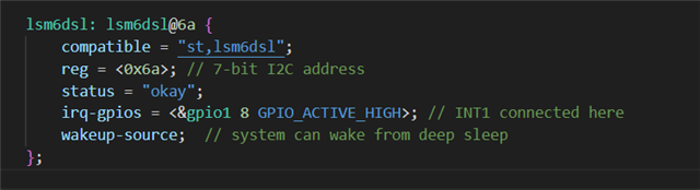

  • Tried adding wakeup-source; property in a device tree overlay:
    button0 {
    wakeup-source;
     Still no wakeup on button press.

        uint32_t abs_pin = NRF_DT_GPIOS_TO_PSEL(DT_NODELABEL(lsm6dsl), irq_gpios);
        uint32_t sense = nrf_gpio_pin_sense_get(abs_pin);
        printk("Pin %d sense setting: %d\n", abs_pin, sense);

  • Hi Vishnu,
    When it comes to power off, I believe that might be a bit different on the 54L15. We have a bit about that here, and here for instance, though this quick sample mentioned by a colleague of mine might be more helpful.
    And regarding having a pin wake-up, have a look at this other quick example I made for a customer earlier, that I think should also work for the nRF54L15 as well. You might have to add target_include_directories(app PRIVATE hal) to cmakelists to run it.

    	/* Configure the button pin for wake-up on low signal (button press) */
    	nrf_gpio_cfg_sense_set(button.pin, NRF_GPIO_PIN_SENSE_LOW);

    wakeup-source
    I am not that familiar with the wakeup-source property, but I do not think it does much by itself.
