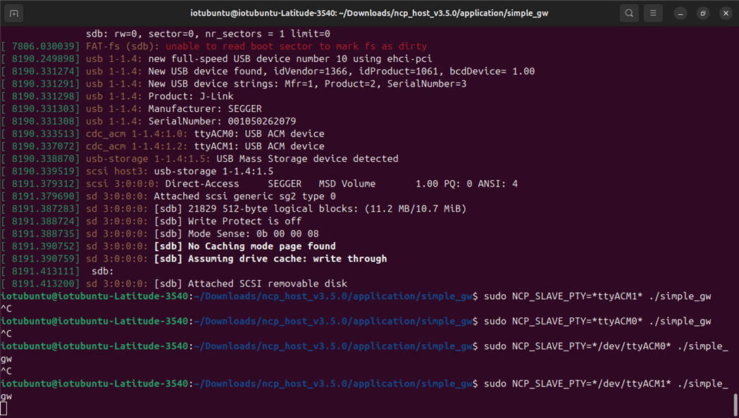

Can you please help me with procedure,how can we make the sample work for FOTA. i seen light_switch code alone has FOTA implementation. what about the server. which sample we can use as server,or we need to make any modifications? it will be great help,if you can give little more procedure of this. for example if i flash light_switch example in one nrf52840-dk board, what about other board.
In your figure, there are * character in the commands. We always called it straight NCP_SLAVE_PTY=dev/ttyACM0 ./simple_gw (not sure if this could have an effect and where the * could have come from)

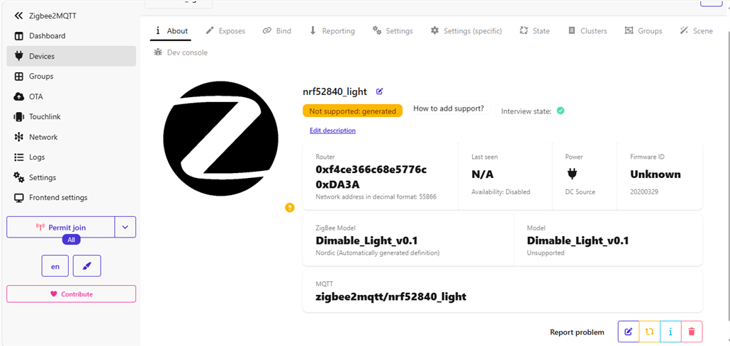

We successfully got the simple_gw sample working, but our main goal is to enable OTA firmware upgrades. We’ve now established a connection with Zigbee2MQTT using the Nordic NCP sample, but OTA updates are still not working. Please see the below image, It shows firmware id is unknown even though firmware id is available in device. Could you please guide us on how to achieve this?
I was able to get Zigbee OTA working with Zigbee2MQTT by adding an external converter. However, I’d like to understand whether the ZBOSS Zigbee stack integration in Zephyr is considered production-grade. My concern arises from the fact that I’m unable to interface Nordic’s Zephyr-based Zigbee applications with third-party tooling directly, and the Zigbee2MQTT documentation notes that ZBOSS adapter support is still experimental and not recommended for production deployments. Could you provide clarification on this?
