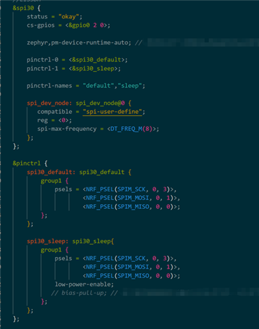

I am currently developing with nRF54L15 and SDK 3.0.0. I have encountered some issues:
1. Problems using the nrfx library in Zephyr

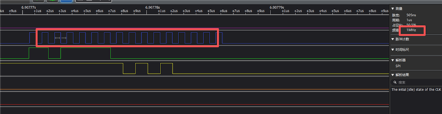

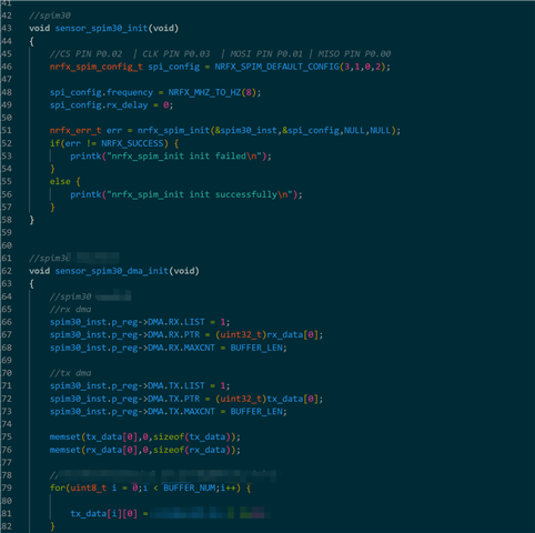

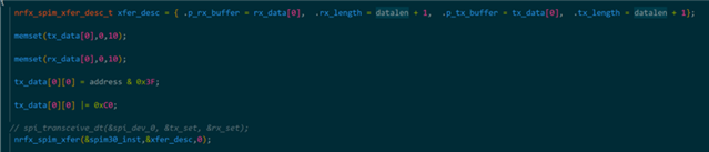

I have defined the configuration information of the SPIM30 node in the devicetree. According to the Zephyr manual, this configuration is initialized before running the application. Therefore, I directly obtained the instance of spim30 in the program and used the nrfx spim library to send data. However, I found that the originally set 8M in devicetree was actually only 1M, and the CS pin output level was supposed to be high after transmission but remained low. But when I directly used the Zephyr spi API, there was no problem. The nrfx is shown in the following figure. Why is this happening?How to deal with this problem?

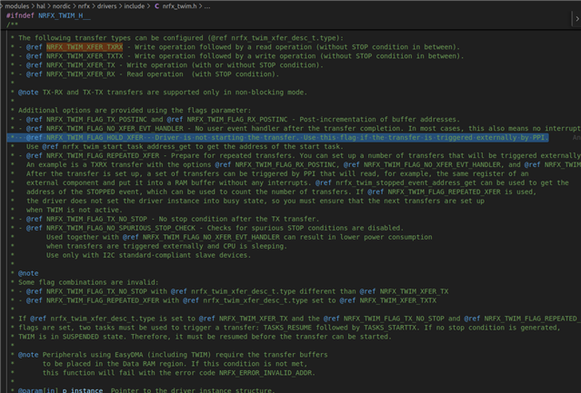

2. I have used nrfx in Zephyr and set CONFIG_DEVICE_PM_RUNTIME. Does it have no effect?

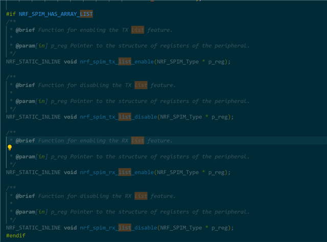

3. In my program, I am using grtc + dppi + spim, all of which are using nrfx library functions. How should the power management of spim be handled? Since I am using the nrfx library and only using dppi to trigger?
