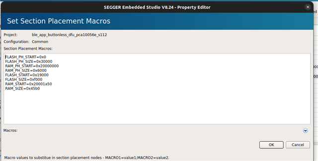

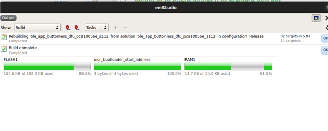

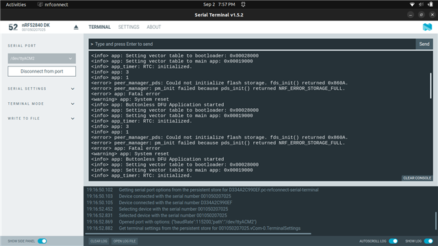

peer_manager_pds: Flash Storage Initialization Failure - fds_init() Error 0x860A
my sdkconfig.h related to fds

error:
my entire sdkconfig

i have tried changing no of pages , using nvmc driver, but i am getting the same error
steps i use to program
nrfjprog --eraseall
nrfjprog  --program combined_bootloader_sd_app.hex --verify --chiperase
nrfjprog --reset
my layout
using nrf52840 dk to emulate nrf52811 soc
edit:- also including build output and liker placement
linker placement
edit2 :- also the final hex file after combining bl-settings , sd, app and bootloader
I have tested the project for compiling for s140 ( nrf52840 ) on the dk, it works for nrf52840
but if I try to compile it for s112 (nrf52811), it gives me this runtime error

  • hi Hieu,
     The error actually occurs regardless of the fds_gc() call — I had only added that function while trying to troubleshoot it. The issue only shows up on the nRF52811, whereas on the nRF52840 it works fine.
    Purvesh

  • FDS_VIRTUAL_PAGES_RESERVED is set to 0, so FDS will try to initialize at the end of the memory, where the bootloader and MBR store their data. Therefore, FDS see that the memory isn't empty, and failed.
    There doesn't seem to be a way to fix this with your setup though... Refer to your memory layout visualization. There isn't any space for FDS. I confirmed your hex file on the nRF Connect for Desktop app to be doubly sure. There is only a single page left, 0x27000 to 0x27FFF, while FDS needs at least 2 pages.
    Looks like you will need to optimize your application to be smaller and then reconfigure FDS_VIRTUAL_PAGES_RESERVED to 8 to avoid the last 8 pages, where the bootloader settings, MBR data, and bootloader would be stored.
