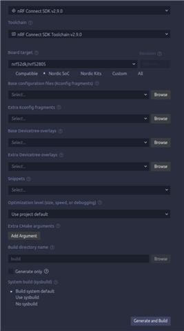

I am using the nRF Connect SDK V2.9 on my Ubuntu 24.04, along with VS Code, as recommended by Nordic for the nRF52 DK. However, whenever I try to create a new project by copying a sample example code from the library, by going to "nRF Connect -> Create a new application -> copy a sample -> NFC Launch App". I then use the following build configurations:
After I click on Generate and Build, I get the following errors:
