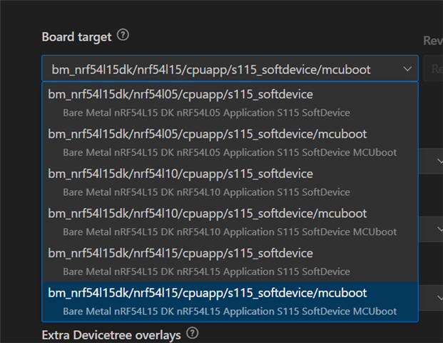

    To test this, please see the "building and running". You can skip all the theory above it, as it explains how to create your own board files for a custom board. This is already done for the DK, so just build for the board named bm_nrf54l15dk/nrf54l15/cpuapp/s115_softdevice/mcuboot
    And follow the instructions. The bootloader will be built and flashed when you flash this application project (you still need to flash the softdevice separately). The images will also be generated when you build, so to test, change something in the application (add a line of logging), and build it again. In the build folder you will find the zephyr.signed.bin, which contains the application image, and the installer_softdevice_firmware_loader.bin, which contains the new softdevice, firmware loader, and installer image.
    We currently only have one softdevice, so there is really no good ways of testing this, but you can transfer the installer_softdevice_firmware_loader.bin, and it will replace the "old" softdevice and firmware loader with the "new" one.
