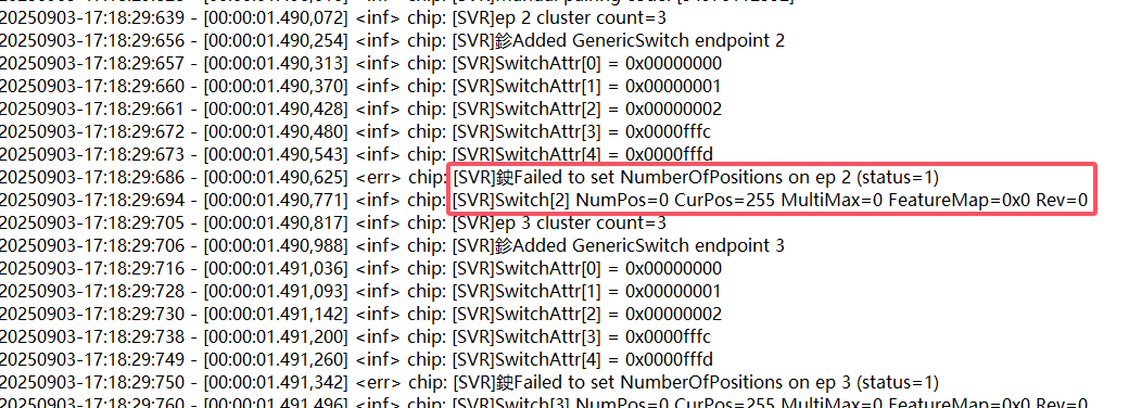

How to config endpoint number dynamically in Matter with nrf54l15?
We are trying to develop a smart controller based on the nRF54L15 that supports a dynamically configurable number of buttons.
We want users to be able to select the number of buttons, and have them correctly mapped on the Matter controller.
Currently, we are experimenting based on the Light Switch example, and we have managed to statically generate multiple buttons.
Could you advise how to implement dynamic button configuration on the nRF54L15?
In the official demo, I noticed that the matter_bridge example supports adding endpoints dynamically. However, this demo is based on the nRF54-30 and cannot be compiled for the nRF54L15.
I tried to port the dynamic endpoint functionality from matter_bridge into the Light Switch example.
Here is the code used to add endpoints:

The log shows that the endpoint was added, but setting the attribute values failed.
The attached file is the ZAP configuration.
Currently, endpoint 0 is set as the root, and endpoint 1 is used as the Generic Switch template. The actual button endpoints start from endpoint 2.
Could you please help check what went wrong?
