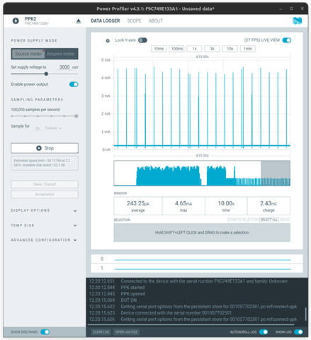

LED2 is consuming more power than other LEDs
On the nRF54L15 DK, I’m configuring three LEDs:
  • LED0 for advertisement status
  • LED2 for connection status

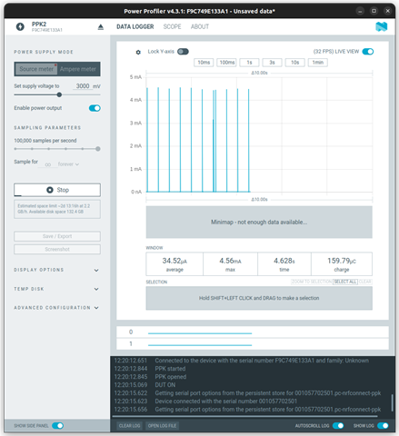

  • LED3 for activity status
I’ve noticed that LED2 consumes significantly more power (about 250 µA) in sleep mode, compared to the other LEDs (around 40 µA). Interestingly, if I use LED3 instead of LED2, the power consumption returns to normal.
I checked the behaviour of LED2 on other boards, and I’m facing the same issue.
Below, I've attached the device tree file and LED configuration code.
Any help would be greatly appreciated.
