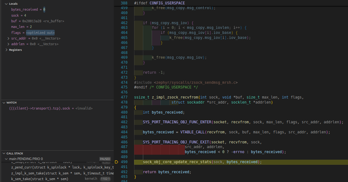

Is it possible to use NON_SECURE (no TLS) transport with an MQTT client, while the MQTT_LIB_TLS and MBED_TLS Kconfig symbols are enabled? I would like my device to, at runtime, be able to choose between using TLS or not using TLS.
Issue:
It appears that whether or not TLS is used by an MQTT client MUST be configured at compile-time. An application with the Kconfig symbols enabled to allow TLS to be used, (CONFIG_MQTT_LIB_TLS=y and CONFIG_MBED_TLS=y), is not able to use NON_SECURE transport, despite the mqtt client config being set accordingly.
When I connect to a broker using TLS, it works fine.
When I have the MQTT_LIB_TLS and MBED_TLS Kconfig symbols disabled, and then attempt to connect using NON_SECURE transport, it also works fine.
 What I've done:
For reference I am using a simple hiveMQ public MQTT broker with standard non secure port of 1883 for demonstration. I am able to connect to this perfectly fine, IF the associated TLS Kconfig symbols are disabled.
I have commented out all lines in the MQTT Helper code that configure the MQTT client to use TLS, based on preprocessor directive conditionals. See here:

With those lines commented out, I can see that the MQTT Helper no longer uses the preprocessor directives for (CONFIG_MQTT_LIB_TLS) , and instead:
- Sets the tranport type to be MQTT_TRANSPORT_NON_SECURE:
// #if defined(CONFIG_MQTT_LIB_TLS)
// 	mqtt_client.transport.type      = MQTT_TRANSPORT_SECURE;
// #else
	mqtt_client.transport.type	= MQTT_TRANSPORT_NON_SECURE;
// #endif /* CONFIG_MQTT_LIB_TLS */
- Does not define the tls_cfg params:
// 	struct mqtt_sec_config *tls_cfg = &(mqtt_client.transport).tls.config;
// 	sec_tag_t kconfig_sec_tag_list[] = {
// 		CONFIG_MQTT_HELPER_SEC_TAG,
// #if CONFIG_MQTT_HELPER_SECONDARY_SEC_TAG > -1
// 		CONFIG_MQTT_HELPER_SECONDARY_SEC_TAG,
// #endif
// 	if (current_cfg.sec_tag_list != NULL && current_cfg.sec_tag_count > 0) {
// 		LOG_DBG("Using run-time provided security tag value");
// 		tls_cfg->sec_tag_count = current_cfg.sec_tag_count;
// 		tls_cfg->sec_tag_list = current_cfg.sec_tag_list;
// 	} else {
// 		LOG_DBG("Using build-time provided security tag value from Kconfig");
// 		tls_cfg->sec_tag_count = ARRAY_SIZE(kconfig_sec_tag_list);
// 		tls_cfg->sec_tag_list = kconfig_sec_tag_list;
// 	tls_cfg->peer_verify = TLS_PEER_VERIFY_REQUIRED;
// 	tls_cfg->cipher_count = 0;
// 	tls_cfg->cipher_list = NULL; /* Use default */
// 	tls_cfg->session_cache = TLS_SESSION_CACHE_DISABLED;
// 	tls_cfg->hostname = conn_params->hostname.ptr;
// 	tls_cfg->set_native_tls = IS_ENABLED(CONFIG_MQTT_HELPER_NATIVE_TLS);
// #if defined(CONFIG_MQTT_HELPER_PROVISION_CERTIFICATES)
// 	err = certificates_provision();
// 	if (err) {
// 		LOG_ERR("Could not provision certificates, error: %d", err);
// 		return err;
// #endif /* defined(CONFIG_MQTT_HELPER_PROVISION_CERTIFICATES) */
// #endif /* defined(CONFIG_MQTT_LIB_TLS) */
- Uses the 'tcp' socket file descriptor for socket configuration using setsockopt():

Step debugging has later revealed that the mqtt_transport_socket_tcp.c associated API fxns are being called (as expected) and the mqtt_client_tcp_connect() fxn seems to work fine, but the 'mqtt_transport_read()' fxn in the mqtt_rx.c code, is returning a len value of 0, which means it thinks the connection is closed.
I can see through step debugging that, as expected, the mqtt_client_tcp_read fxn is called, which calls zsock_recv() fxn, which suggests 0 bytes were received.
This happens inside the 'mqtt_read_and_parse_fixed_header() fxn, in the mqtt_hanlde_rx() fxn, within the mqtt_rx.c source code.

This leads me to believe that something is happening outside of the mqtt code that prevents a single application from being able to choose between using TLS, or not, and that you can only have one or the other, which must be defined at compile-time.
Obivously later on I will not use the MQTT Helper, and will setup my own code to do the same thing, but I commented out the TLS stuff as a quick and ditry proof of concept - and this has revealed to me that despite using the tcp socket file descriptor and correctly using the mqtt_transport_socket_tcp.c associated fxns, I am still not able to NOT use TLS in a project where TLS is enabled via Kconfig symbols at compile time.
