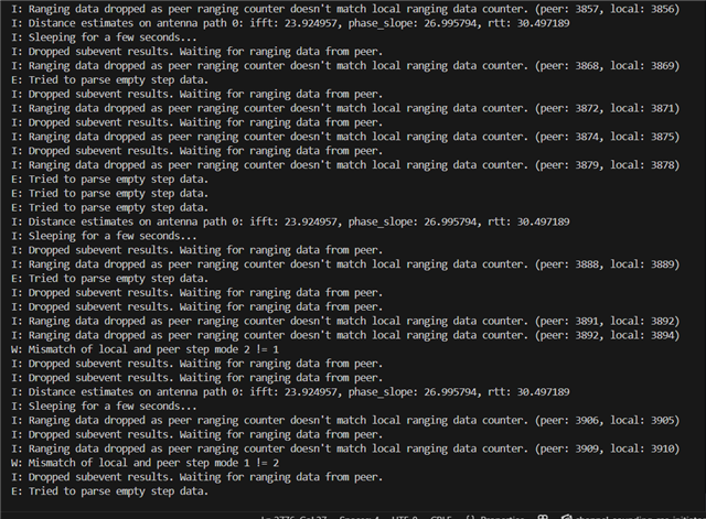

Hi SwRa
After I increased the TX power to 7dBm of maximum for both initiator and reflector(both are nRF54L15 DKs), the initiator detect distance can exceed 18 meters, but the distance measurement accuracy has declined when the distance between initiator and reflector exceeds 25 meters.
For example:
The ifft is about 23.9 meters when the distance between initiator and reflector is 30 meters.
The ifft is also about 23.9 meters when the distance between initiator and reflector is 35 meters.
Is there any approach to optimize it? Many thanks.

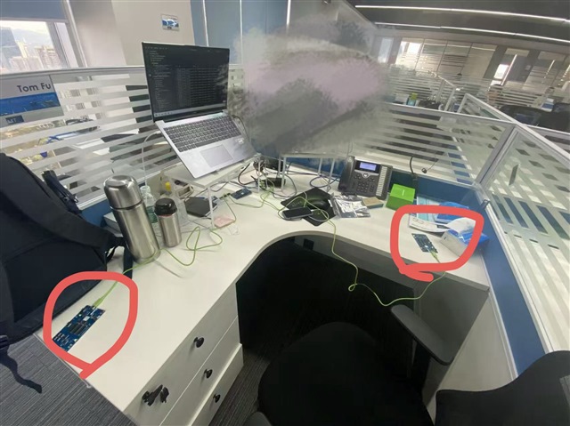

Hi, fromy my experience (I am also elaborating with CS) is problem with multipath of RF signal. Are you indoor? Also I am not sure if making calibration for ifft is needed..
I am trying more Anetanna path, but it does not work very well for me..
