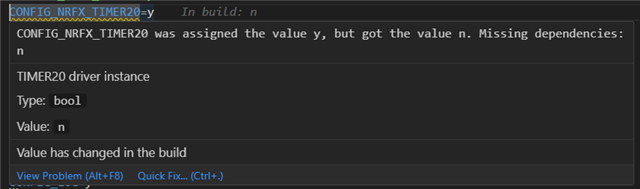

Now the prj.conf line CONFIG_NRFX_TIMER20=y causes an error with missing driver instance.

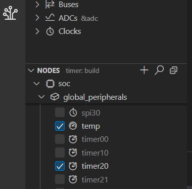

The 54L15DK doesn't appear to have it enabled, so I added this overlay to by build
&timer20 {
    status = "okay";
..and timer20 is shown in the DT graphical editor
What's missing?

    CONFIG_NRFX_TIMER20 only depends on the existence of the node timer20 in DeviceTree, with the appropriate compatible property. Whether the node is disabled or enabled doesn't matter, because the nrfx drivers configure the registers directly, unlike Zephyr drivers, which are designed to work with DeviceTree.
    That means you don't have to do anything to use CONFIG_NRFX_TIMER20.
    Well, it's needed for sure. I haven't delved into the macros but the line
     nrfx_timer_t timer_inst = NRFX_TIMER_INSTANCE(TIMER_INST_IDX);
    doesn't compile without CONFIG_NRFX_TIMER20

    Right... it unfortunately seems so. Usually this happens when custom board files are being used, and a mistake was made where the timer20 definition isn't correctly included or recreated.
    However, the fact that you could refer to it by using &timer20 suggests that the node is indeed available, in which case, it should satisfy the only dependency for CONFIG_NRFX_TIMER20.
    Could this be a hint towards what is wrong? Refer to the dependency definition I linked above, NRFX_TIMER20 only needs the node to be presented. It doesn't need it enabled.
