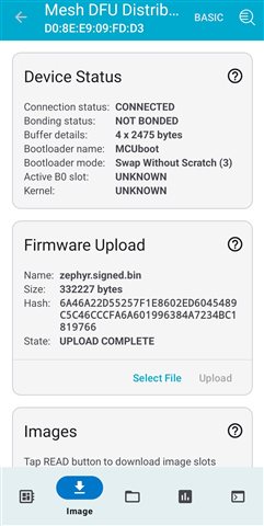

I am able to successfully perform a firmware upgrade on the Distributor itself. However, when attempting to upgrade the Target devices, the mobile app shows Upload Complete, but the firmware is not being transmitted to the Target nodes. What could be the possible cause of this issue?
I updated the firmware version from 1.0 to 2.0 in the proj config file. Are there any additional changes required apart from updating the version? Also, is it mandatory to configure a Publish Address for the Firmware Update Client model, or will the Distributor automatically transmit the firmware to all target nodes regardless of the address? Currently, when I attempt to set a Publish Address for the Firmware Update Client model, I receive an Invalid Parameter error.
Please see the image below. I was able to successfully upload the target binary to the Distributor device, but the firmware is not being transmitted to the Target devices.
