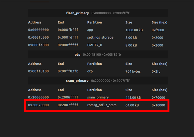

  • Sorry Ziv, it seems Vidar brought up a valid point.
    Going with your example Vidar, I would foresee something like:
    &sram0 {
       reg = <0x20000000 DT_SIZE_K(458752) - 150;
    This brings an interesting question: why don't I have the full 512Kb RAM?
    I set the RAM config with 448Kb total since whatever configs I use, I get:
    [650/650] Linking C executable zephyr/zephyr.elf
               FLASH:      402024 B         3 MB     12.78%
                 RAM:      190868 B       448 KB     41.61%
            IDT_LIST:          0 GB        32 KB      0.00%
    I don't have TFM or MCUBoot enabled. Since currently we're using nrf5340dk and nrf7002dk Where are 64Kb disappearing to?
  • The "missing" 64k is allocated to the shared RAM region and is used for communication with the network core.
  • Thank you for the explanation.

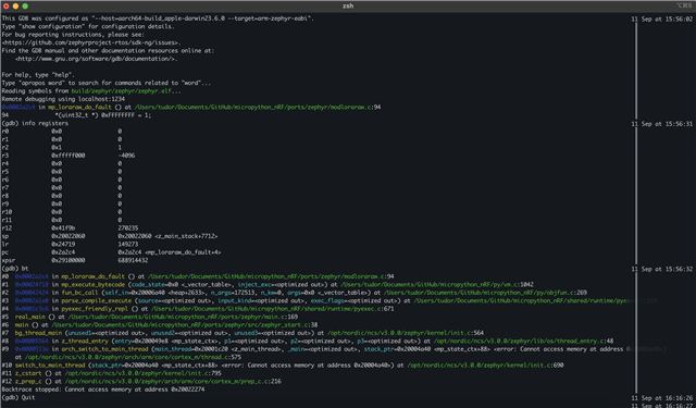

    the issue i am running this  "/opt/zephyr-sdk/arm-zephyr-eabi/bin/arm-zephyr-eabi-gdb build/zephyr/zephyr.elf" (instead of non existing <path to SDK>/x86_64-zephyr-elf/bin/x86_64-zephyr-elf-gdb ) and trying to connect, then i get this error
    (gdb)  target remote localhost:1234
    localhost:1234
    : cannot resolve name: Servname not supported for ai_socktype
    localhost:1234
    : No such file or directory.
    even though coredump_gdbserver.py is running on another terminal
    any idea why ? update - seems like it was related to order of things server must run before opening the gdb client even if the attempt to conect inside gdb is after the server start running ..
    are there more debug options other then "info registers" and "bt" in order to get more information on running threads and stack ?
