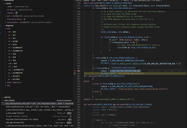

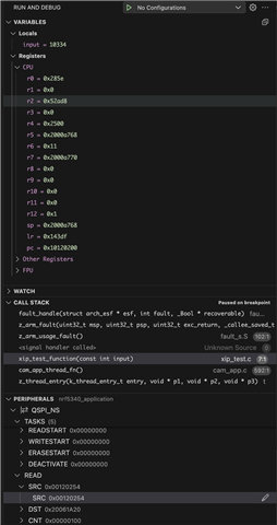

When the code runs and the XIP function is executed, I receive a bus fault.
It appears that it is attempting to execute the code in external flash, based on the address.
