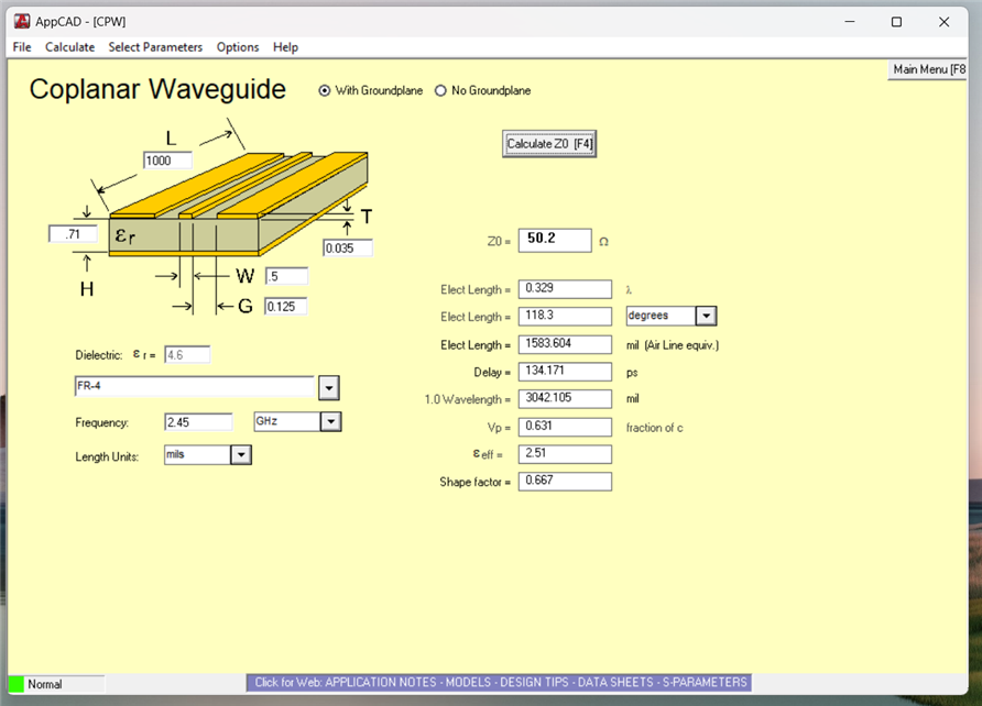

Hi Everyone,
I have designed the NRF52832 PCB, Before I order the PCB I hope you guys can review it one time.
Can you please review it, Also I want to tune the antenna.

Hi Akshay,
The design looks mostly good, only issue I can see it that C2 needs to be grounded to only the VSS pin 31 and the center GND pad, and not to the top layer GND fill.
Here is a snippet from the reference layout showing the correct grounding for this capacitor:
