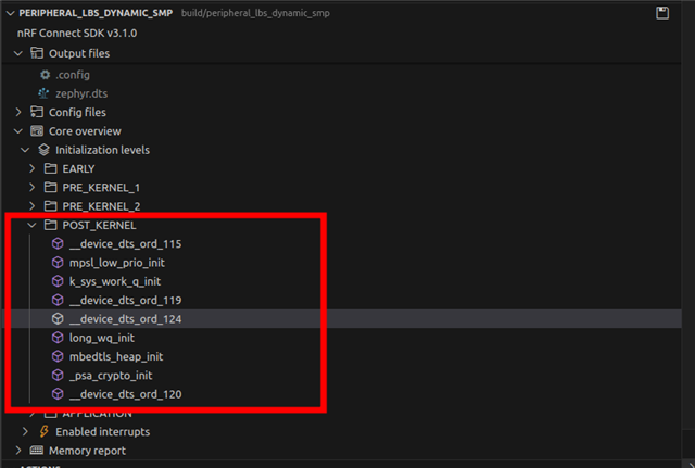

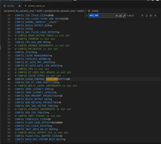

  • Small update:
    I have confirmed that I do hit breakpoints in PRE_KERNEL_X SYS_INIT's and in POST_KERNEL SYS_INIT with priority 0, *but not* priority 99.
    Currently narrowing down exactly which sys_init is causing the issue.
