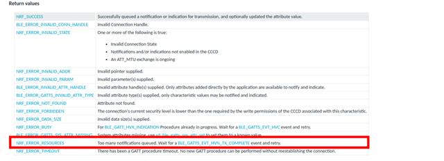

In my application, I am calling the function 'ble_nus_data_send(...)'.
I am trying to understand why when I call this function with a large number of bytes then I keep getting error indications that there are no 'RESOURCES' available. Searching for similar issues on the devzone almost invariably highlights solutions that one way or another refer to a 'UART' interface.
    The resource error is returned when you have filled up the Softdevice's tx buffer:
    (ref. sd_ble_gatts_hvx())
    Vidar
  • Thanks. I was thinking the same and you just confirmed it for me.
    FYI, the buffer overrun was likely because I was doing some heavy lifting within the NUS IRQ handler. Once I moved that to a background task, we are no longer running into the resource errors at a rate that throttles our transfer.
