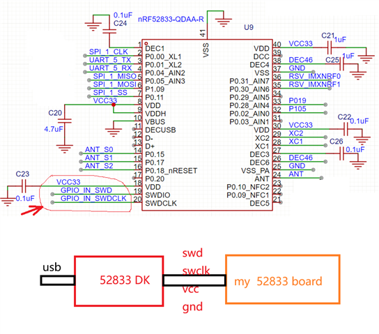

I have a nrf52833 small board.  nrf52833 QFN
and the several board have the same finding:

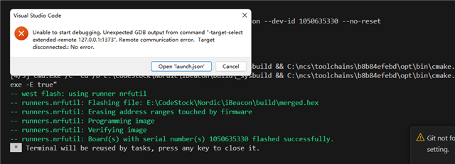

-- west flash: using runner nrfutil
-- runners.nrfutil: reset after flashing requested
-- runners.nrfutil: Flashing file: E:\Nordic\bluetoothproj\build\merged.hex
Error: One or more batch tasks failed:
* 1050635330: Device error: Setting the debug port SELECT register failed while powering up sys and debug regions (Unknown Error in J-Link DLL (error code =-1)).
This might indicate that the debug port is unavailable. Please double-check device power supply and SWD lines, and that SWD isn't disabled (Generic)
FATAL ERROR: command exited with status 1: nrfutil --json device x-execute-batch --batch-path 'E:\Nordic\bluetoothproj\build\generated_nrfutil_batch.json' --serial-number 1050635330
* The terminal process terminated with exit code: 1.
* Terminal will be reused by tasks, press any key to close it.
once upon a time. I debugging in the code. but suddenly, it report debugging stoped.
so, my question is : why the firsttime, the debugger can debug the board but afterwards. it always failed.
and the recovery and reset command would fail too.

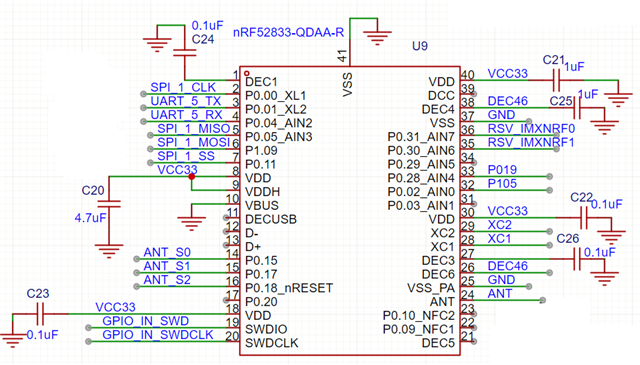

the following is my design:
thanks.
    Can you share a schematic or drawing which pins are connected to the programmer? If you are supplying the target board separately, then you need to provide the VDD supply of the board to the programmer as well (VTref).

  • I use 52833 DK as debugger.  (my board have no 32k osc)
    connet my own board by (swd swclk vcc gnd) (4 lines). it works well on other 52833 board( I buy from other company)
    I try all the 5 board. they have the same issue:
    at first try, It will run into main function. I cannot find any issue.
    and afterwards. I try and try, but it cannot run into main function. it looks it loss the connect to the board.
    another board have such problem: flash ok. but loss connection immedialtely.
    flash image done, but loss connection with no error.

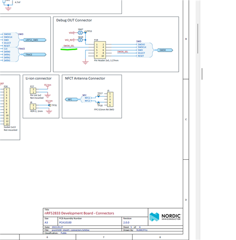

    Also for programming a custom board using DK debug out port, the minimum connections are as follow:  pins 1 (VTref), 2 (SWDIO), 4 (SWDCLK), and 5 (GND).
    *Pin 3 (SWD0_SELECT) is used for debug out selection and should be connected to GND on the target board for proper operation on some DKs.
    *For reliable operation, also connect pin 10 (RESET) if available.

  • the third party board (works well) have no 32k oscillator either.
    Pin 3 (SWD0_SELECT).  what do you mean by Pin3?  I cannot find any pin in the QDAA chip
    and I do not change any thing when I try third part board(works well QIAA) and my own board(QDAA)
    for the reset pin, I make it unconnected.
    By SWD0_SEL I mean the below pin on Debug out connector of nRF52833 DK:
    It should be connected to the ground on your target board (your own board). By doing that, DK can recognize that there is an external board connected to the DK.
  • for QFN40 NRF52833.
    the swd and swclk is specific pin (19,20)
    and the reset pin is P0.18/reset   (16)
    is it true?
    I should make sure this is right.
