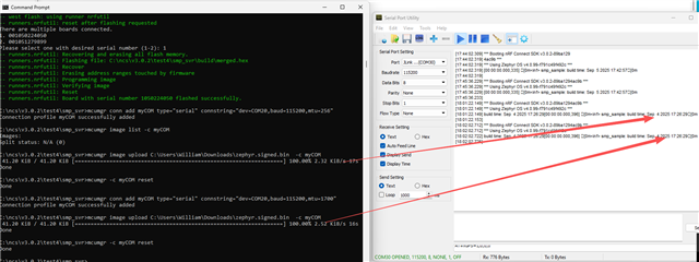

hi support team,
i am trying to help customer on demo about 9151 dfu 52840.

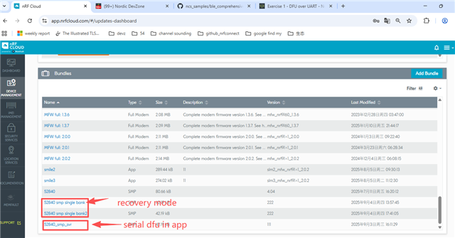

currently, 9151 is using nrf_cloud_rest_fota demo and 52840 is using "zephyr\samples\subsys\mgmt\mcumgr\smp_svr",
i have two bundle in nrf cloud as below:
when i tesing mcumgr dual bank mode, it is ok, everything is fine;
but, when i tesing 52840 single bank recovery mode, it fails, the situation is:
i can use pc to upgrade single bank dfu. it is fine. as below:
i can't use 9151 to upgrade single bank dfu, here is the log from log from 9151 side,

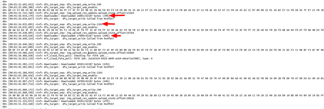

09> [00:00:41.867,401] <inf> downloader: Downloaded 1506/42187 bytes (3%)

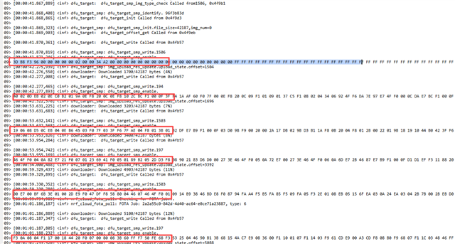

09> [00:00:41.867,889] <inf> dfu_target:  dfu_target_smp_img_type_check Called from1506, 0x4f9b1
09>
09> [00:00:41.868,408] <inf> dfu_target_smp: dfu_target_smp_identify. 96f3b83d
09> [00:00:41.868,865] <inf> dfu_target:  dfu_target_init Called from 0x4f9d3
09>
09> [00:00:41.869,323] <inf> dfu_target_smp: dfu_target_smp_init.file_size=42187,img_num=0
09> [00:00:41.869,903] <inf> dfu_target:  dfu_target_offset_get Called from 0x4f9eb
09>
09> [00:00:41.870,361] <inf> dfu_target:  dfu_target_write Called from 0x4fb57
09>

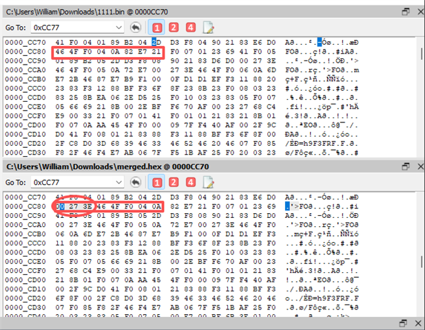

09> [00:00:41.870,819] <inf> dfu_target_smp: dfu_target_smp_write.1506
09> [00:00:41.871,246] <inf> dfu_target_smp: dfu_target_smp_enable.
09> 3D B8 F3 96 00 00 00 00 00 02 00 00 34 A2 00 00 00 00 00 00 00 00 00 00 00 00 00 00 00 00 00 00 FF FF FF FF FF FF FF FF FF FF FF FF FF FF FF FF FF FF FF FF FF FF FF FF FF FF FF FF FF FF FF FF FF FF FF FF FF FF FF FF FF FF FF FF FF FF FF FF FF FF FF FF FF FF FF FF FF FF FF FF FF FF FF FF FF FF FF FF FF FF FF FF FF FF FF FF FF FF FF FF FF FF FF FF FF FF FF FF FF FF FF FF FF FF FF FF FF FF FF FF FF FF FF FF FF FF FF FF FF FF FF FF FF FF FF FF FF FF FF FF FF FF FF FF FF FF FF FF FF FF FF FF FF FF FF FF FF FF FF FF FF FF FF FF FF FF FF FF FF FF FF FF FF FF FF FF FF FF FF FF FF FF FF FF FF FF FF FF FF FF FF FF FF FF FF FF FF FF FF FF FF FF FF FF FF FF FF FF FF FF FF FF FF FF FF FF FF FF FF FF FF FF FF FF FF FF FF FF FF FF FF FF FF FF FF FF FF FF FF FF FF FF FF FF FF FF FF FF FF FF FF FF FF FF FF FF FF FF FF FF FF FF FF FF FF FF FF FF FF FF FF FF FF FF FF FF FF FF FF FF FF FF FF FF FF FF FF FF FF FF FF FF FF FF FF FF FF FF FF FF FF FF FF FF FF FF FF FF FF FF FF FF FF FF FF FF FF FF FF FF FF FF FF FF FF FF FF FF FF FF FF FF FF FF FF FF FF FF FF FF FF FF FF FF FF FF FF FF FF FF FF FF FF FF FF FF FF FF FF FF FF FF FF FF FF FF FF FF FF FF FF FF FF FF FF FF FF FF FF FF FF FF FF FF FF FF FF FF FF FF FF FF FF FF FF FF FF FF FF FF FF FF FF FF FF FF FF FF FF FF FF FF FF FF FF FF FF FF FF FF FF FF FF FF FF FF FF FF FF FF FF FF FF FF FF FF FF FF FF FF FF FF FF FF FF FF FF FF FF FF FF FF FF FF FF FF FF FF FF FF FF FF FF FF FF FF FF FF FF FF FF FF FF FF FF FF FF FF FF FF FF FF FF FF FF FF FF FF FF FF FF FF FF FF FF FF FF FF FF FF 40 2D 00 20 1D E1 00 00 EF 42 01 00 09 E1 00 00 09 E1 00 00 09 E1 00 00 09 E1 00 00 00 00 00 00 00 00 00 00 00 00 00 00 00 00 00 00 8D E2 00 00 09 E1 00 00 00 00 00 00 25 E2 00 00 09 E1 00 00 19 E4 00 00 19 E4 00 00 19 E4 00 00 19 E4 00 00 19 E4 00 00 19 E4 00 00 19 E4 00 00 19 E4 00 00 19 E4 00 00 19 E4 00 00 19 23 D8 E7 68 B9 04 2B 02 D1 08 F1 04 08 A4 E7 08 2B E9 D1 08 F1 07 08 28 F0 07 08 08 F1 08 08 ED E7 05 9A 01 3A 05 92 58 F8 04 2B 00 92 10 E7 03 9A 90 07 20 D5 A4 EB 05 0E 4F EA 9E 00 4F F0 01 0C BE F5 00 7F CF D2 0F 2F CD D8 F5 B1 07 F1
09> [00:00:42.275,939] <inf> dfu_target_smp: img_upload_res_update.upload_state.offset=1504
09> [00:00:42.276,550] <inf> downloader: Downloaded 1700/42187 bytes (4%)
09> [00:00:42.277,008] <inf> dfu_target:  dfu_target_write Called from 0x4fb57
09>
09> [00:00:42.277,465] <inf> dfu_target_smp: dfu_target_smp_write.194
09> [00:00:42.277,893] <inf> dfu_target_smp: dfu_target_smp_enable.
09> 40 02 0D EB 02 0E C0 B2 01 9A 0E F8 20 0C 0E F8 10 2C BC F1 00 0F 3F F4 1A AF 60 F0 7F 00 0E F8 20 0C 09 F1 01 09 01 37 C5 F1 08 02 04 34 06 92 4F F6 DA 7E 97 E7 4F F0 00 0C DA E7 BC F1 00 0F 01 D0 01 36 EF E7 02 98 02 36 00 28 EB D1 00 98 CD E9 06 31 FF F7 6D FE DD E9 06 31 06 44 E2 E7 63 1B B3 F5 80 6F 97 D2 3D B9 A6 F1 08 04 E0 18 B1 E6 3C 4F 01 00 D8 61 01 00 02 9A 28 60 9B 08 2B 70 9D F8 10 30 C2 B1 EB 70 85 F8 02 90 B9 F1 00 0F 05 D0 08 A8 00 22 C5 F1 01 0C 97 42 0E D1 C5 F1 01 03 0D F1 20 08 4F F0 00 0A 01 93 0D F1 30 0B 57 45 12 D1 60 1B 8D E6 6B 70 E5 E7 10 F8 01 3B
09> [00:00:42.322,570] <inf> dfu_target_smp: img_upload_res_update.upload_state.offset=1696
09> [00:00:53.631,225] <inf> downloader: Downloaded 3203/42187 bytes (7%)
09> [00:00:53.631,683] <inf> dfu_target:  dfu_target_write Called from 0x4fb57
09>
09> [00:00:53.632,141] <inf> dfu_target_smp: dfu_target_smp_write.1503
09> [00:00:53.632,568] <inf> dfu_target_smp: dfu_target_smp_enable.
09> 19 06 08 D5 0C EB 04 0E B6 45 03 F0 7F 03 3F F6 7F AE 04 F8 01 3B 01 32 DF E7 B9 F1 00 0F 03 D0 98 F9 00 20 00 2A 17 DB 02 9B D3 B1 1A F8 0B 20 04 F8 01 2B 00 22 01 9B 18 19 10 44 B0 42 3F F6 67 AE 98 F8 00 00 04 F8 01 0B 00 99 03 92 20 46 08 F0 6D FB 03 9A 14 44 0A F1 01 0A 08 F1 01 08 C6 E7 98 F8 00 20 55 F8 22 30 00 93 02 9B 45 F8 22 30 00 98 FF F7 FC FD 42 1C DC E7 6F F0 0D 00 48 E6 00 BF 2D E9 F0 4F 97 B0 00 AF 90 F8 02 A0 D7 F8 80 B0 3B 62 CB F3 C0 03 04 46 FA 62 BB 61 89 46 41 B9 45 78 00 78 0A EB 80 00 20 44 4D 45 17 D8 A0 EB 04 09 E3 78 FB 61 BA F1 00 0F 02 D0 1B F0 01 0F 16 D1 FB 69 53 BB FB 6A 1B B1 3A 6A 49 46 20 46 98 47 4D 46 28 46 5C 37 BD 46 BD E8 F0 8F 46 1C 30 46 FF F7 C3 FD 01 30 30 44 09 F1 01 09 DC E7 23 78 62 68 7A 62 FA 6A 99 00 79 61 04 EB 83 01 00 2A 40 F0 00 81 4D 46 0E 46 01 EB 0A 09 4F F0 00 08 4E 45 4C D1 01 EB 0A 06 10 E0 1B F0 02 0F D1 D0 23 78 9A 00 7A 61 62 68 7A 62 FA 6A 04 EB 83 01 00 2A 77 D1 4D 46 01 EB 0A 06 90 46 1B F0 05 0F 0C BF 02 23 01 23 FB 62 FB 69 06 EB 43 0A 0B F0 02 03 BB 62 56 45 BC D0 16 F8 02 1B 16 F8 01 3C 54 F8 23 90 99 4B 99 45 02 D3 98 4B 99 45 36 D3 BB 69 00 2B 40 D0 78 6A 07 F0 4B F8 00 28 3B D0 E9 46 8A B0 6A 46 92 4B 53 61 7B 6A C2 E9 06 31 4F F4 00 73 13 84 8F 4B 42 F8 10 3F 8F 48 00 23 4F F4 12 51 00 F0 23 FD 02 3D CD 46 D2 E7 16 F8 01 3B F9 62 54 F8 23 00 FF F7 57 FD D7 F8 84 30 F9 6A 01 30 4B B1 D7 F8 88 30 98 45 3E BF D7 F8 84 30 23 F8 18 00 08 F1 01 08 05 44 98 E7 BB 69 23 B1 78 6A 07 F0 15 F8 00 28 C9 D1 1B F0 01 0F 05 D1 FB 6A ED 1A AD E7 BB 6A 00 2B AA D0 48 46 FF F7 33 FD D7 F8 84 30 53 B1 D7 F8 88 30 98 45 3F BF D7 F8 84 20 43 1C 22 F8 18 30 08 F1 01 08 05 44 97 E7 BA F1 00 0F 72 D0 1B F0 04 06 72 D0 D0 46 00 26 07 F1 48 00 52 46 3B 61 B9 62 08 F0 73 FA [00:00:53.953,186] <inf> dfu_target_smp: img_upload_res_update.upload_state.offset=3196
09> [00:00:53.953,826] <inf> downloader: Downloaded 3400/42187 bytes (8%)
09> [00:00:53.954,284] <inf> dfu_target:  dfu_target_write Called from 0x4fb57
09>
09> [00:00:53.954,742] <inf> dfu_target_smp: dfu_target_smp_write.197
09> [00:00:53.955,169] <inf> dfu_target_smp: dfu_target_smp_enable.
09> 46 4F F0 04 0A 82 E7 21 F0 07 01 23 69 41 F0 05 01 89 B2 05 2D D3 F8 08 90 21 83 D6 D0 00 27 3E 46 4F F0 05 0A 72 E7 00 27 3E 46 4F F0 06 0A 6D E7 2B 46 87 E7 B9 F1 00 0F D1 D1 EF F3 11 88 20 23 83 F3 12 88 BF F3 6F 8F 23 8B 23 F0 08 03 23 83 25 8B EA 06 2E D5 25 F0 10 03 23 83 05 F0 07 05 66 69 21 8B 00 2E BF F6 70 AF 00 23 27 68 C4 E9 00 33 21 F0 07 01 41 F0 01 01 21 83 21 8B 01 F0 07 0A AA 45 4F F0 00 09 7F F4 40 AF 00 2F 9C D0 41 F0 08 01 21 83 88 F3 11 88 BF F3 6F 8F 00 2F C8 D0 3D 68 39 46 33 46 52 46 20 46 07 F0 85 F8 2F 46 F4 E7 AB 06 7F F5 1B AF 25 F0 20 03 23 83 05 F0 07 05
09> [00:00:54.000,488] <inf> dfu_target_smp: img_upload_res_update.upload_state.offset=3392
09> [00:00:59.329,437] <inf> downloader: Downloaded 4903/42187 bytes (11%)
09> [00:00:59.329,895] <inf> dfu_target:  dfu_target_write Called from 0x4fb57
09>
09> [00:00:59.330,352] <inf> dfu_target_smp: dfu_target_smp_write.1503
09> [00:00:59.330,780] <inf> dfu_target_smp: dfu_target_smp_enable.
09> 00 E7 00 BF 6B 3E 01 00 2D E9 F0 47 DF F8 58 80 04 46 07 46 4F F0 01 09 14 B9 38 46 BD E8 F0 87 94 FA A4 F5 B5 FA 85 F5 09 FA 05 F3 2E 01 08 EB 05 15 6F EA 03 0A 24 EA 03 04 2B 7B 00 2B EB D0 58 F8 06 30 1B 69 4B B9 46 44 03 22 73 68 28 46 19 68 07 EA 0A 07 00 F0 67 FA DD E7 28 46 98 47 00 28 D9 D1 F0 E7 00 BF E8 52 01 00 30 B5 10 49 10 48 89 B0 00 22 07 F0 E0 FF 0F 4D 0F 49 00 22 00 23 CD E9 06 23 00 24 0E 23 CD E9 03 34 CD E9 01 44 0B 4B 00 94 4F F4 40 72 28 46 05 F0 04 FA 08 49 28 46 07 F0 B7 FE 20 46 09 B0 30 BD 00 BF 11 CE 00 00 A8 0B 00 20 10 07 00 20 C0 17 00 20 15 D1 00 00 59 57 01 00 01 48 04 F0 EB BF 00 BF 00 07 00 20 2D E9 F0 47 80 46 1F 48 0F 46 07 F0 EE F8 06 46 00 28 30 D0 00 25 28 46 BD E8 F0 87 23 7B 6B B1 23 68 DB 68 0B B1 20 46 98 47 23 68 1B 69 D3 B9 63 68 03 22 19 68 20 46 00 F0 0C FA 01 36 10 34 4C 45 EB D3 B8 F1 00 0F E5 D0 00 2D E2 D0 28 46 FF F7 70 FF 05 46 00 2F F7 D0 00 21 4F F4 A4 70 07 F0 05 FF F1 E7 20 46 98 47 00 28 E0 D0 0A FA 06 F3 1D 43 E2 E7 04 4C DF F8 10 90 05 46 4F F0 01 0A DD E7 AC 0E 00 20 E8 52 01 00 08 53 01 00 01 4B 53 F8 20 00 70 47 6C 53 01 00 08 B5 03 46 08 46 2B B1 04 4A 13 60 00 F0 7E FC 00 20 08 BD 6F F0 15 00 FB E7 00 BF C4 04 00 20 10 B5 04 4C 23 78 13 B9 03 48 04 F0 83 FF 01 23 23 70 10 BD 8A 17 00 20 00 07 00 20 10 B5 04 46 0B 48 07 F0 84 F8 5C B1 BF F3 5B 8F 09 4B 53 E8 00 1F 01 39 43 E8 00 12 00 2A F8 D1 BF F3 5B 8F 05 48 07 F0 3E FF 05 48 BD E8 10 40 04 F0 62 BF A4 0E 00 20 A8 0E 00 20 A8 0B 00 20 00 07 00 20 00 20 06 4B BF F3 5B 8F 01 46 53 E8 00 0F 43 E8 00 12 00 2A F9 D1 BF F3 5B 8F 70 47 A4 0E 00 20 70 B5 FF F7 ED FF 08 4C 08 4E 05 46 B4 42 00 D3 70 BD 63 68 5B 79 2B B1 23 68 5B 68 13 B1 29 46 20 46 98 47 10 34 F1 E7 E8 52 01 00 08 53 01 00 10 B5 04 4C 04 49 20 46 06 F0 C2 FD 03 4B 1C 60 10 BD 00 BF 38 06 00 20 58 53 01 00 9C 0E 00 20 08 4A 09 48 08 B5 00 23 13 70 08 4A 13 60 08 4A 4F F4 00 41 13 60 FF F7 7B FF BD E8 08 40 FF F7 DF BF 00 BF 8B 17 00 20 03 40 01 00 A4 0E 00 20 A8 0E 00 20 01 46 00 22 01 48 00 23 06 F0 B9 BD 38 06 00 20 01 48 06 F0 52 BE 00 BF 38 06 00 20 02 4B 01 46 18 68 06 F0 9E BE 00 BF 9C 0E 00 20 01 48 06 F0 D3 BE 00 BF 38 06 00 20 70 B5 28 4B 18 78 00 28 4B D0 FF F7 E5 FF 05 46 90 B1 BF F3 5B 8F 24 4B 53 E8 00 1F 01 39 43 E8 00 12 00 2A F8 D1 BF F3 5B 8F 20 4C 20 4E B4 42 2D D3 28 46 FF F7 D6 FF 1E 4B 1F 4C 1B 68 00 2B 19 DD 07 F0 92 FE 4F F4 7A 72 A0 FB 02 03 02 FB 01 31 C3 0B D4 E9 00 20 43 EA 41 43 9B 1A 4F EA D1 31 40 F2 E9 32 61 EB 00 01 93 42 71 F1 00 01 01 D3 FF F7 67 FF D4 E9 00 32 13 F5 7A 73 42 F1 00 02 C4 E9 00 32 BD E8 70 40 FF F7 B3 BF 63 68 5B 79 23 B1 23 68 29 46 1B 68 20 46 98 47 10 34 C5 E7 70 BD 8A 17 00 20 A8 0E 00 20 E8 52 01 00 08 53 01 00 A4 0E 00 20 A0 0B 00 20 70 B5 0D 4D 29 78 61 B9 01 20 FF F7 9F FE 0B 4C 0B 4E B4 42 06 D3 FF F7 95 FF 00 28 FB D1 01 23 2B 70 70 BD 63 68 5B 79 1B B1 23 68 20 46 9B 68 98 47 10 34 ED E7 00 BF 8B 17 00 20 E8 52 01 00 08 53 01 00 00 21 2D E9 F0 47 08 46 FF F7 7E FE 04 46 58 B3 40 F2 67 68 4F F0 00 09 07 F0 FC FE 1B 4B 1C 4A 1B 58 13 60 33 B1 1B 4B 1B 68 09 2B 02 DD 1A 48 04 F0 52 FE 19 4F DF F8 60 A0 00 25 44 B1 20 46 FF F7 FC FD 04 46 18 B9 4F F0 FF 38 4F F0 FF 39 FF F7 56 FF 06 46 28 B9 B5 B9 42 46 4B 46 50 46 04 F0 6E FE 35 46 E9 E7 4F F0 FF 38 4F F0 FF 39 D2 E7 2B 68 9B 69 1B B1 00 22 11 46 28 46 98 47 10 35 BD 42 F5 D3 E8 E7 05 4D FA E7 08 00 00 00 A0 0E 00 20 A8 0E 00 20 00 07 00 20 08 53 01 00 E8 52 01 00 13 B5 18 48 06 F0 23 FF 17 4B 1B 78 73 B1 EF F3 11 84 20 23 83 F3 12 88 BF F3 6F 8F FF F7 1E FF 84 F3 11 88 BF F3 6F 8F 02 B0 10 BD 0F 4B 1B 68 00 2B F9 D0 50 B9 00 22 00 23 CD E9 00 23 0C 48 4F F4 00 42 00 23 05 F0 7F FD ED E7 09 28 EB D1 07 48 07 F0 C6 FD 07 48 02 B0 BD E8 10 40 04 F0 E9 BD 00 BF A8 0E 00 20 8B 17 00 20 A0 0E 00 20 A8 0B 00 20 00 07 00 20 10 B5 06 4B 1B [00:00:59.734,497] <inf> dfu_target_smp: img_upload_res_update.upload_state.offset=4892

09> [00:01:26.483,489] <inf> downloader: Downloaded 13401/42187 bytes (31%)
09> [00:01:26.483,947] <inf> dfu_target:  dfu_target_write Called from 0x4fb57
09>
09> [00:01:26.484,405] <inf> dfu_target_smp: dfu_target_smp_write.1501
09> [00:01:26.484,832] <inf> dfu_target_smp: dfu_target_smp_enable.
09> FF F7 34 FA D8 F8 04 90 D8 F8 10 20 79 49 48 46 02 F0 E6 FA FF F7 48 FF 04 1E 55 DB 76 4D 0F CD 07 F1 28 04 0F C4 95 E8 03 00 07 F1 04 0A 00 25 84 E8 03 00 7D 60 AB 23 CA E9 01 55 3B 71 6F 4B D3 F8 24 25 D2 B2 3A 61 D3 F8 28 25 D2 B2 7A 61 D3 F8 30 25 D2 B2 BA 61 D3 F8 34 25 D2 B2 FA 61 D3 F8 38 25 D2 B2 3A 62 D3 F8 3C 35 DB B2 7B 62 07 F1 28 00 FF F7 32 FF 01 20 02 F0 27 FB 07 F1 10 06 01 46 30 46 FF F7 29 FF 5D 4B 99 42 25 D1 29 46 50 46 FF F7 5E FF 04 1E 15 DB 23 20 05 F0 2A FD 4F F0 03 0B 9F 23 C7 E9 0A 55 C7 F8 10 A0 C7 F8 14 B0 87 F8 28 30 3E 63 29 46 07 F1 28 00 FF F7 48 FF 04 1E 0C DA 02 F0 1E FB 08 B1 02 F0 09 FB 20 46 44 37 BD 46 BD E8 F0 8F 6F F0 04 04 F2 E7 5A 46 51 46 09 F1 30 00 05 F0 64 FF 04 46 18 B3 6C 46 8C B0 97 F8 04 E0 97 F8 05 C0 BE 79 99 F8 30 00 99 F8 31 10 99 F8 32 30 6A 46 DF F8 F4 80 D3 62 08 23 C2 E9 05 8E C2 E9 07 C6 C2 E9 09 01 42 F8 10 3F 38 48 2B 46 44 F2 40 01 FE F7 75 F9 A5 46 6F F0 12 04 C6 E7 D8 F8 04 20 53 7F 02 3B 01 2B 16 D9 92 F8 1C 80 A8 F1 02 08 B8 F1 02 0F 8C BF 4F F0 00 08 4F F0 01 08 05 F0 93 FA 05 1E 0A DA 29 4A 28 48 2B 46 01 21 05 F0 9C F8 2C 46 A9 E7 4F F0 01 08 F0 E7 EA B2 C5 F3 80 15 A8 45 A1 D0 00 23 01 21 82 F0 40 02 BB 62 3F 61 79 61 3B 63 87 F8 28 10 FE 62 07 F1 28 00 3B 80 3A 70 FF F7 D7 FE 04 1E 07 D1 05 F0 6C FA 04 1E 04 DB 14 F0 01 04 F8 D1 86 E7 85 DA 14 4A 15 4B 6D 46 8A B0 B8 F1 00 0F 18 BF 13 46 6A 46 12 49 D4 61 C2 E9 05 13 4F F4 00 73 13 84 0F 4B 42 F8 10 3F 09 48 00 23 4F F4 11 51 FE F7 17 F9 AD 46 6A E7 00 BF 99 44 01 00 10 53 01 00 00 90 02 40 00 00 AD 0B 1A 5E 01 00 C0 52 01 00 4C 5E 01 00 10 5E 01 00 14 5E 01 00 5C 5E 01 00 04 00 00 01 2D E9 F0 4F 82 46 87 B0 0E 46 1C 46 90 46 82 B1 00 2B 00 F0 8F 80 00 29 42 68 03 DB D2 6A 0B 44 93 42 0B D9 44 4A 45 48 00 94 33 46 01 21 05 F0 35 F8 6F F0 15 00 07 B0 BD E8 F0 8F 75 42 05 F0 03 05 05 F0 FC F9 A5 42 28 BF 25 46 D8 F1 00 03 03 F0 03 03 08 F0 03 07 58 BF 5F 42 7F 42 07 F0 03 07 A7 42 28 BF 27 46 63 1B E4 1B 24 F0 03 04 23 F0 03 09 A1 45 C8 BF A1 46 03 F0 03 0B C8 BF A3 EB 04 0B B9 F1 00 0F 19 D0 08 EB 07 03 72 19 49 46 18 46 03 93 05 F0 B7 FB 04 46 01 46 DA F8 10 00 FF F7 39 FE 26 4A 94 42 38 D1 BD 42 06 D0 03 9B 4A 46 19 46 08 EB 05 00 05 F0 4A FE AD B1 C5 F1 04 07 F2 1B 04 21 04 A8 05 F0 9D FB 04 46 01 46 DA F8 10 00 FF F7 1F FE 19 4B 9C 42 1E D1 04 AB 2A 46 D9 19 40 46 05 F0 25 FE BB F1 00 0F 1E D0 72 19 4A 44 08 21 04 A8 05 F0 85 FB 04 46 01 46 DA F8 10 00 FF F7 07 FE 0D 4B 9C 42 06 D1 09 EB 05 00 5A 46 04 A9 40 44 05 F0 0C FE 50 46 05 F0 72 F9 20 46 07 B0 BD E8 F0 4F FF F7 AC BD 03 4C F4 E7 18 46 7E E7 6D 5E 01 00 C0 52 01 00 00 00 AD 0B 2D E9 FF 47 0E 46 07 46 41 68 1D 46 90 46 A2 B1 9B B1 04 2B 01 D9 AB 07 0F D1 16 F0 03 04 0C D1 00 2E 03 DB CA 6A 73 19 93 42 0C D9 39 4A 3A 48 00 95 33 46 01 21 04 F0 8F FF 6F F0 15 04 20 46 04 B0 BD E8 F0 87 38 46 05 F0 57 F9 20 46 05 F0 83 F9 04 46 30 B1 01 20 05 F0 7E F9 38 46 05 F0 31 F9 EC E7 03 2D 1C D8 32 46 04 21 03 A8 05 F0 29 FB 04 46 01 46 38 69 FF F7 AC FD 27 4B 9C 42 34 D1 2A 46 41 46 03 A8 05 F0 B3 FD 32 46 04 21 03 A8 05 F0 14 FB 04 46 01 46 38 69 FF F7 9A FD 24 E0 08 F0 60 43 B3 F1 00 5F 02 D1 18 F0 03 0F 2B D0 DF F8 68 A0 04 2D A9 46 28 BF 4F F0 04 09 4A 46 41 46 03 A8 05 F0 94 FD 32 46 49 46 03 A8 05 F0 F5 FA 04 46 01 46 38 69 FF F7 7B FD 54 45 04 D1 B5 EB 09 05 C8 44 4E 44 E4 D1 20 46 FF F7 29 FD 04 46 01 20 05 F0 2F F9 05 46 38 46 05 F0 E1 F8 00 2C 08 BF 2C 46 99 E7 32 46 29 46 40 46 BF E7 00 BF B6 5E 01 00 C0 52 01 00 00 00 AD 0B 2D E9 F3 47 0B 46 0E 46 D0 F8 04 C0 07 46 C1 F3 0B 01 15 46 2A B9 6F F0 15 04 20 46 02 B0 BD E8 F0 87 C2 F3 0B 02 52 EA 01 04 F4 D1 00 2B 04 DB DC F8 2C 10 5A 19 8A 42 06 D9 3C 4A 3C 48 00 95 01 21 04 F0 F9 FE E6 E7 05 F0 C7 F8 20 46 D7 F8 04 80 05 F0 F1 F8 04 46 00 28 63 D1 DF F8 D4 90 D8 F8 2C 30 9D 42 21 D1 05 F0 9F FA AA 46 04 46 38 69 21 46 FF F7 1E FD 4C 45 3D D1 56 44 A5 EB 0A 05 00 21 4F F4 A4 70 05 F0 7F FC 05 F0 B9 F8 04 1E 3D DB 14 F0 01 04 F3 D1 00 2D E0 D1 01 20 05 F0 CA F8 00 [00:01:26.888,000] <inf> dfu_target_smp: img_upload_res_update.upload_state.offset=13372
09> [00:01:26.888,519] <inf> nrf_cloud_fota_poll: Checking for FOTA job...
09> [00:01:29.918,243] <inf> nrf_cloud_fota_poll: FOTA Job: 2a2a55c0-842d-4d40-ac64-e0ce71a23887, type: 6
09>
09> [00:01:29.918,945] <inf> downloader: Downloaded 13600/42187 bytes (32%)
09> [00:01:29.919,433] <inf> dfu_target:  dfu_target_write Called from 0x4fb57
09>
09> [00:01:29.919,860] <inf> dfu_target_smp: dfu_target_smp_write.199
09> [00:01:29.920,288] <inf> dfu_target_smp: dfu_target_smp_enable.
09> 48 70 47 F4 54 01 00 07 B5 03 46 05 4A 00 91 05 48 01 21 04 F0 64 FE 6F F0 15 00 03 B0 5D F8 04 FB 00 BF B9 5F 01 00 90 52 01 00 10 B5 01 22 11 46 06 48 06 4C 05 F0 1F FB 05 F0 00 FA 20 60 05 F0 F9 F9 60 60 00 20 10 BD 00 BF C4 14 00 20 BC 14 00 20 4F F0 80 42 D2 F8 10 15 D2 F8 10 35 01 F0 1E 01 23 F0 1F 03 0B 43 43 F0 01 03 C2 F8 10 35 02 4B 00 22 1A 70 70 47 00 BF A2 17 00 20 4F F0 80 53 D3 F8 30 31 08 2B 20 D1 4F F0 80 42 D2 F8 10 15 CB 07 1A D5 D2 F8 10 35 01 F0 1E 01 23 F0 1F 03 0B 43 C2 F8 10 35 D2 F8 08 31 5B B1 D2 F8 10 35 23 F0 1F 03 0B 43 43 F0 01 03 C2 F8 10 35 6F F0 8B 00 70 47
09> [00:01:29.965,637] <inf> dfu_target_smp: img_upload_res_update.upload_state.offset=13568
09> [00:01:32.373,107] <inf> downloader: Downloaded 15101/42187 bytes (35%)
09> [00:01:32.373,565] <inf> dfu_target:  dfu_target_write Called from 0x4fb57
09>
09> [00:01:32.374,023] <inf> dfu_target_smp: dfu_target_smp_write.1501
09> [00:01:32.374,420] <inf> dfu_target_smp: dfu_target_smp_enable.
09> 02 4B 01 22 1A 70 00 20 70 47 00 BF A2 17 00 20 2D E9 F3 41 0F 46 15 46 05 F0 A9 F9 29 46 06 46 38 46 05 F0 17 F8 B8 46 00 28 38 D0 B7 FB F6 F3 06 FB 13 73 23 B9 B5 FB F6 F4 06 FB 14 54 4C B1 19 4A 00 95 3B 46 19 48 01 21 04 F0 E5 FD 6F F0 15 04 1D E0 AE 42 1B D8 4F F0 FF 32 4F F0 FF 33 13 48 14 4F 02 F0 66 FC 05 F0 81 F9 06 46 FF F7 A3 FF 04 46 80 B9 40 46 01 F0 F6 FC 3B 78 0B B1 FF F7 84 FF AD 1B B0 44 F1 D1 09 48 02 F0 1E FC 20 46 02 B0 BD E8 F0 81 6F F0 8B 04 F5 E7 06 4A 00 95 3B 46 CF E7 00 BF D6 5F 01 00 90 52 01 00 C4 14 00 20 A2 17 00 20 B9 5F 01 00 2D E9 F7 43 0E 46 30 46 19 46 17 46 1C 46 04 F0 C3 FF 60 B9 20 4A 00 94 33 46 20 48 01 21 04 F0 9D FD 6F F0 15 04 20 46 03 B0 BD E8 F0 83 46 EA 04 05 15 F0 03 05 03 D0 19 4A 00 94 33 46 EC E7 00 2C F0 D0 17 48 DF F8 60 90 4F F0 FF 32 4F F0 FF 33 02 F0 11 FC 24 F0 03 04 A5 42 05 EB 06 08 09 D1 12 4A D2 F8 00 34 DB 07 FB D5 00 24 0D 48 02 F0 CE FB D7 E7 FF F7 41 FF 50 B9 79 59 40 46 01 F0 B4 FC 99 F8 00 30 0B B1 FF F7 21 FF 04 35 E3 E7 6F F0 8B 04 EA E7 B9 5F 01 00 90 52 01 00 F5 5F 01 00 C4 14 00 20 A2 17 00 20 00 E0 01 40 F0 B5 40 68 05 7B 01 F0 1F 04 44 EA 45 14 05 69 87 B0 00 2D 64 D0 B2 F5 00 1F 00 F1 10 05 06 D1 21 46 28 46 05 F0 E5 F8 00 20 07 B0 F0 BD 01 AE 00 27 B2 F5 80 0F 01 97 77 60 39 D1 B3 F1 00 7F 14 BF 05 23 04 23 8D F8 04 30 00 23 CD E9 04 63 03 93 83 68 23 FA 01 F1 11 F0 01 01 1A D1 B2 F1 A0 7F 17 D1 04 F0 1F 03 62 09 03 F5 E0 73 2A D0 01 2A 3B D1 1F 4A 52 F8 23 30 DB 07 0A D4 0D F1 03 06 32 46 21 46 28 46 01 F0 92 FA 1A 4B 98 42 1C D0 02 96 03 AA 21 46 28 46 01 F0 4B F9 17 4B 98 42 20 D1 01 22 21 46 28 46 01 F0 E5 FA BB E7 B3 F1 C0 6F 05 D0 B3 F1 00 7F 14 BF 01 23 02 23 C1 E7 03 23 BF E7 4F F0 A0 42 D4 E7 31 46 28 46 01 F0 CC FA 09 4B 98 42 DB D0 6F F0 0B 00 A4 E7 6F F0 85 00 A1 E7 6F F0 15 00 9E E7 51 F8 23 30 FF DE 00 BF 00 03 00 50 04 00 AD 0B 00 00 AD 0B 38 B5 45 68 2B 69 B3 B1 10 35 28 46 01 F0 9E FA 04 46 80 B9 01 46 28 46 01 F0 64 FA 08 4B 98 42 0B D1 08 49 22 46 28 46 01 F0 3C FA 22 46 05 21 06 20 FE F7 93 FD 00 20 38 BD 6F F0 04 00 FB E7 00 00 AD 0B D5 F7 00 00 42 09 70 B5 03 46 02 D0 01 2A 17 D0 70 BD 0D 4E 32 69 51 68 00 29 F9 D0 03 F0 1F 03 01 25 0C 68 9D 40 00 29 F2 D0 8A 68 2A 40 02 D0 4B 68 30 46 98 47 2C B1 23 68 21 46 1C 46 F2 E7 02 4E E7 E7 23 46 F8 E7 F4 4F 01 00 E0 4F 01 00 2D E9 F0 43 46 68 40 F2 06 35 D0 06 33 7B 87 B0 02 EA 05 05 54 BF C2 F3 40 10 03 20 01 F0 1F 07 B5 F5 83 7F 14 46 47 EA 43 17 8D F8 03 00 45 D0 0F D8 06 2D 18 D0 07 D8 B5 B1 02 2D 40 D0 6F F0 15 00 07 B0 BD E8 F0 83 B5 F5 80 7F F7 D1 01 25 0A E0 40 F2 02 22 95 42 34 D0 B5 F5 40 7F 33 D0 B5 F5 00 7F EB D1 02 25 01 23 22 03 03 FA 01 F1 2C D5 73 68 C3 F8 08 15 32 69 82 BB 07 F0 1F 03 7F 09 29 D0 01 2F 77 D1 3E 4A 02 EB 83 02 84 F4 80 33 D2 F8 00 17 C3 F3 00 43 C4 F3 40 44 44 EA 43 04 21 F4 E1 61 44 EA 80 04 21 F0 07 01 44 EA 05 23 0B 43 C2 F8 00 37 00 20 C2 E7 07 25 D3 E7 04 25 D1 E7 05 25 CF E7 03 25 CD E7 63 03 44 BF 73 68 C3 F8 0C 15 CF E7 4F F0 A0 42 D5 E7 10 36 0D F1 02 02 39 46 30 46 01 F0 98 F9 14 F4 40 3F 80 46 0C D1 39 46 30 46 04 F0 AF FF 22 4B 98 45 DA D1 9D F8 02 10 30 46 01 F0 E0 F9 D4 E7 01 AB 4F F0 00 09 03 AA 39 46 30 46 CD E9 04 39 CD E9 01 99 CD F8 0C 90 01 F0 3B F8 17 4B 98 42 86 D1 14 F4 00 33 15 D0 9D F8 03 30 8D F8 0E 30 84 F4 80 34 C4 F3 00 44 4B 46 03 AA 39 46 30 46 8D F8 0C 50 8D F8 0D 40 01 F0 DD F8 0B 4B [00:01:32.694,396] <inf> dfu_target_smp: img_upload_res_update.upload_state.offset=15068
09> [00:01:32.695,037] <inf> downloader: Downloaded 15300/42187 bytes (36%)
09> [00:01:32.695,526] <inf> dfu_target:  dfu_target_write Called from 0x4fb57
09>
09> [00:01:32.695,953] <inf> dfu_target_smp: dfu_target_smp_write.199
09> [00:01:32.696,380] <inf> dfu_target_smp: dfu_target_smp_enable.
09> D0 C3 F3 00 43 00 2B B9 D0 03 A8 03 94 FF F7 4F FF 03 9B 01 26 06 FA 03 F3 C0 F8 08 35 32 46 C2 E7 C5 F8 64 45 E8 E7 C5 F8 68 45 E5 E7 C5 F8 6C 45 E2 E7 C5 F8 24 45 62 1C 87 D0 00 22 01 26 B2 E7 C5 F8 28 45 7F E7 C5 F8 30 45 F4 E7 C5 F8 34 45 F1 E7 C5 F8 38 45 EE E7 C5 F8 3C 45 73 E7 6F F0 15 00 44 E7 6F F0 85 00 41 E7 53 60 01 00 F0 F8 FC FF 01 4B 01 22 1A 60 70 47 00 C0 00 40 0C 29 03 69 0B D1 5B 6A 06 49 07 48 4B 43 93 FB F0 F1 00 FB 11 33 11 60 53 60 00 20 70 47 6F F0 85 00 70 47 90 D0 03 00 40 42 0F 00 04 4B 00 69 00 22 C3 F8 00 21 D3 F8 00 31 02 F0 19 B9 00 BF 00 C0 00 40 7F B5 05 69
09> [00:01:32.741,760] <inf> dfu_target_smp: img_upload_res_update.upload_state.offset=15264
09> [00:01:34.034,179] <inf> downloader: Downloaded 16801/42187 bytes (39%)
09> [00:01:34.034,637] <inf> dfu_target:  dfu_target_write Called from 0x4fb57
09>
09> [00:01:34.035,095] <inf> dfu_target_smp: dfu_target_smp_write.1501
09> [00:01:34.035,491] <inf> dfu_target_smp: dfu_target_smp_enable.
09> AB 6A 63 B3 3F 29 01 D0 0C 29 2B D1 05 F1 10 06 4F F0 FF 32 4F F0 FF 33 30 46 02 F0 3D F8 13 4B 01 93 A8 6A 03 23 00 24 69 46 03 94 02 93 04 F0 5A F9 4F F0 FF 32 4F F0 FF 33 28 46 02 F0 28 F9 A8 6A 04 F0 A7 F9 0A 4B D3 F8 08 25 6A 62 01 22 5A 60 30 46 02 F0 98 F8 20 46 04 B0 70 BD 6F F0 0A 00 FA E7 6F F0 85 00 F7 E7 00 BF 71 FB 00 00 00 C0 00 40 10 B5 04 69 00 20 FE F7 F9 FE A0 62 4F F0 FF 32 00 21 20 46 04 F0 40 FF 04 F1 10 00 04 F0 35 FF 00 22 01 21 0C 20 FE F7 43 FB 0C 20 FE F7 24 FB 02 4B 01 22 C3 F8 04 23 00 20 10 BD 00 C0 00 40 2D E9 F0 41 04 46 47 68 0D 46 04 F0 66 FF 4F F0 20 08 88 B9 26 4B 1B 78 73 B1 64 26 60 68 04 F0 17 FD F0 B9 01 20 04 F0 60 FD 01 3E F6 D1 00 21 21 20 04 F0 EE FF F0 E7 EF F3 11 86 31 46 88 F3 12 88 BF F3 6F 8F 60 68 04 F0 02 FD A8 B9 86 F3 11 88 BF F3 6F 8F EF E7 86 F3 11 88 BF F3 6F 8F E5 E7 EF F3 11 86 31 46 88 F3 12 88 BF F3 6F 8F 60 68 04 F0 ED FC 00 28 EE D0 BB 69 1D 70 63 68 BA 69 1B 68 00 20 C3 F8 44 25 01 22 C3 F8 48 25 C3 F8 20 01 D3 F8 20 41 C3 F8 58 01 D3 F8 58 01 9A 60 81 F3 11 88 BF F3 6F 8F BD E8 F0 81 00 BF A5 17 00 20 F7 B5 05 46 00 22 01 21 02 20 FE F7 D7 FA 02 20 FE F7 B8 FA 6A 68 11 68 13 69 C1 F8 24 35 13 7D 50 7D 92 7D 40 31 FF F7 CE FE EF F3 11 82 20 23 83 F3 12
09> [00:01:34.438,995] <inf> dfu_target_smp: img_upload_res_update.upload_state.offset=16764
09> [00:01:34.439,636] <inf> downloader: Downloaded 17000/42187 bytes (40%)
09> [00:01:34.440,124] <inf> dfu_target:  dfu_target_write Called from 0x4fb57
09>
09> [00:01:34.440,582] <inf> dfu_target_smp: dfu_target_smp_write.199
09> [00:01:34.441,009] <inf> dfu_target_smp: dfu_target_smp_enable.
09> 88 BF F3 6F 8F 18 4B D3 E9 02 67 B0 42 B9 41 06 D2 82 F3 11 88 BF F3 6F 8F 03 B0 BD E8 F0 83 4F F0 FF 38 4F F0 FF 39 C3 E9 02 89 D3 E9 00 10 1D 60 4F F4 80 33 C4 F8 48 33 C4 F8 40 51 D4 F8 40 31 82 F3 11 88 BF F3 6F 8F 00 29 E5 D0 00 90 32 46 3B 46 28 46 88 47 DF E7 00 BF 00 10 01 40 2C 15 00 20 24 15 00 20 E0 0B 00 20 30 B5 43 1C 12 4C 85 B0 05 D0 84 42 A8 BF 04 46 01 2C B8 BF 01 24 FF F7 87 FE 0E 4B 0C 4D D3 E9 00 13 40 1A B0 F5 00 0F 10 D2 22 18 AA 42 28 BF 2A 46 52 18 4F F0 00 00 07 49 00 91 CD E9 01 00 43 F1 00 03 FF F7 92 FE 05 B0 30 BD 2A 46 F0 E7 FF FF 7F 00 F0 0B 00 20 91 FE 00 00
09> [00:01:34.486,419] <inf> dfu_target_smp: img_upload_res_update.upload_state.offset=16960
09> [00:01:34.486,938] <inf> nrf_cloud_fota_poll: Checking for FOTA job...
09> [00:01:35.813,110] <inf> nrf_cloud_fota_poll: FOTA Job: 2a2a55c0-842d-4d40-ac64-e0ce71a23887, type: 6
09>
09> [00:01:45.585,113] <inf> downloader: Downloaded 18501/42187 bytes (43%)
09> [00:01:45.585,601] <inf> dfu_target:  dfu_target_write Called from 0x4fb57
09>
09> [00:01:45.586,059] <inf> dfu_target_smp: dfu_target_smp_write.1501
09> [00:01:45.586,456] <inf> dfu_target_smp: dfu_target_smp_enable.
09> 08 B5 FF F7 63 FE 02 4B 1B 68 C0 1A 08 BD 00 BF F0 0B 00 20 4F F0 80 53 D3 F8 30 21 08 2A 06 D1 D3 F8 34 31 05 2B 02 D8 02 4A D0 5C 70 47 00 20 70 47 00 BF B6 60 01 00 02 4A D2 F8 00 34 00 2B FB D0 70 47 00 E0 01 40 10 B5 4F F0 80 53 D3 F8 30 21 08 2A 4E D1 4F F0 80 42 00 21 C2 F8 0C 11 C2 F8 10 11 C2 F8 38 15 02 F5 40 42 D3 F8 04 14 C2 F8 20 15 D3 F8 08 14 C2 F8 24 15 D3 F8 0C 14 C2 F8 28 15 D3 F8 10 14 C2 F8 2C 15 D3 F8 14 14 C2 F8 30 15 D3 F8 18 14 C2 F8 34 15 D3 F8 1C 14 C2 F8 40 15 D3 F8 20 14 C2 F8 44 15 D3 F8 24 14 C2 F8 48 15 D3 F8 28 14 C2 F8 4C 15 D3 F8 2C 14 C2 F8 50 15 D3 F8 30 14 C2 F8 54 15 D3 F8 34 14 C2 F8 60 15 D3 F8 38 14 C2 F8 64 15 D3 F8 3C 14 C2 F8 68 15 D3 F8 40 14 C2 F8 6C 15 D3 F8 44 34 C2 F8 70 35 FF F7 8E FF 18 B1 3A 4B 3A 4A C3 F8 8C 26 FF F7 87 FF 18 B1 38 4B FB 22 C3 F8 18 25 FF F7 80 FF 70 B1 4F F0 80 41 4F F0 80 53 D1 F8 E4 2E D3 F8 58 32 22 F0 0F 02 03 F0 0F 03 13 43 C1 F8 E4 3E FF F7 6E FF 20 B1 2D 4B 4F F4 00 72 C3 F8 40 26 4F F0 80 53 D3 F8 30 31 08 2B 1A D1 4F F0 80 43 D3 F8 00 24 D2 07 44 BF 6F F0 01 02 C3 F8 00 24 4F F0 80 53 D3 F8 34 31 05 2B 02 D8 20 4A D3 5C 3B B1 4F F0 10 23 D3 F8 08 22 4F F0 80 43 C3 F8 58 25 4F F0 10 23 D3 F8 00 22 00 2A 03 DB D3 F8 04 32 00 2B 22 DA 17 49 01 23 4F F0 10 20 C1 F8 04 35 12 24 FF F7 46 FF C0 F8 00 42 FF F7 42 FF C0 F8 04 42 FF F7 3E FF 00 23 C1 F8 04 35 FF F7 39 FF BF F3 4F 8F 0C 49 0C 4B CA 68 02 F4 E0 62 13 43 CB 60 BF F3 4F 8F 00 BF FD E7 10 BD 00 BF 00 50 00 40 48 81 03 00 00 F0 00 40 00 90 02 40 B0 60 01 00 00 E0 01 40 00 ED 00 E0 04 00 FA 05 30 B5 04 68 CC B1 BF F3 5B 8F B4 FA 84 F3 C3 F1 1F 03 DB B2 01 22 9A 40 24 EA 02 02 50 E8 00 5F A5 42 04 D1 40 E8 00 2C BC F1 00 0F F6 D1 BF F3 5B 8F E6 D1 02 48 0B 70 30 BD 02 48 FC E7 00 BF 00 00 AD 0B 02 00 AD 0B 10 B5 03 68 CB 40 DB 07 14 D4 01 23 8B 40 02 68 BF F3 5B 8F 43 EA 02 01 50 E8 00 4F 94 42 04 D1 40 E8 00 1C BC F1 00 0F F6 D1 BF F3 5B 8F EE D1 01 48 10 BD 01 48 FC E7 00 00 AD 0B 04 00 AD 0B 01 4B C3 F8 04 05 70 47 00 F0 01 40 F7 B5 05 46 F8 B1 01 28 1B D1 04 22 4F F4 80 73 01 46 4F F0 80 40 03 44 02 44 C0 F8 08 13 00 26 01 21 11 60 1E 60 8D 42 1B 68 8D F8 07 10 08 BF 0D F1 07 06 42 F2 10 74 4F F0 80 47 45 B1 01 2D 28 D0 03 B0 F0 BD 0C 22 4F F4 82 73 02 21 E0 E7 D7 F8 18 34 03 F4 80 33 3E B9 00 2B F1 D0 01 20 04 F0 FF F8 01 3C F3 D1 EB E7 D7 F8 18 24 02 F0 03 02 32 60 00 2B E4 D0 9D F8 07 00 01 28 03 D1 04 F0 EF F8 01 3C D9 D1 01 2D DA D1 0C 4B 00 22 5A 71 D6 E7 D7 F8 0C 34 03 F4 80 33 3E B9 00 2B F4 D0 01 20 04 F0 DD F8 01 3C [00:01:45.906,616] <inf> dfu_target_smp: img_upload_res_update.upload_state.offset=18460
09> [00:01:45.907,257] <inf> downloader: Downloaded 18700/42187 bytes (44%)
09> [00:01:45.907,714] <inf> dfu_target:  dfu_target_write Called from 0x4fb57
09>
09> [00:01:45.908,172] <inf> dfu_target_smp: dfu_target_smp_write.199
09> [00:01:45.908,599] <inf> dfu_target_smp: dfu_target_smp_enable.
09> 10 08 BD 38 05 00 20 03 46 11 F0 01 00 10 B5 CC B2 0D D1 A2 07 C4 F3 40 00 12 D5 09 4A D2 F8 20 05 58 60 C2 F8 20 05 00 38 18 BF 01 20 08 E0 4F F0 A0 41 D1 F8 20 25 1A 60 C1 F8 20 25 00 2A E8 D0 10 BD 00 03 00 50 10 B5 FF F7 8F FF 12 4A 08 30 32 F8 10 30 D9 05 1C D5 C3 F3 43 21 23 F4 F8 53 22 F8 10 30 02 F1 0E 04 00 20 34 F8 02 3F 13 F4 80 7F 03 D0 C3 F3 43 23 99 42 0A D0 01 30 30 28 F3 D1 00 23 42 F8 31 30 04 48 BD E8 10 40 FF F7 EE BD 10 BD 00 BF 38 05 00 20 B0 05 00 20 F0 B5 05 46 00 20 04 46 01 26 07 46 8C 42 0B D1 11 4B D3 F8 7C 21 32 B1 00 22 C3 F8 7C 21 D3 F8 7C 31 40 F0 00 40 F0 BD
09> [00:01:45.953,979] <inf> dfu_target_smp: img_upload_res_update.upload_state.offset=18656
09> [00:01:51.355,072] <inf> downloader: Downloaded 20201/42187 bytes (47%)
09> [00:01:51.355,560] <inf> dfu_target:  dfu_target_write Called from 0x4fb57
09>
09> [00:01:51.356,018] <inf> dfu_target_smp: dfu_target_smp_write.1501
09> [00:01:51.356,445] <inf> dfu_target_smp: dfu_target_smp_enable.
09> E3 B2 9B 00 03 F5 80 72 9B 08 06 FA 03 F3 1D 42 0B D0 02 F1 80 42 02 F5 C0 42 D2 F8 00 C0 BC F1 00 0F 02 D0 17 60 12 68 18 43 01 34 DA E7 00 BF 00 60 00 40 F7 B5 06 46 08 46 FF F7 33 FF 19 4F 00 F1 08 05 0C 46 37 F8 15 30 DB 07 27 D5 30 46 03 F0 69 FF 20 46 FF F7 67 FF 40 B1 20 46 FF F7 4B FF 31 68 00 F5 A2 70 00 23 41 F8 20 30 20 46 FF F7 86 FF 00 23 01 A8 27 F8 15 30 01 94 FF F7 01 FF 01 9B 00 EB 83 00 07 4B D0 F8 00 27 13 40 43 F0 02 03 C0 F8 00 37 04 48 03 B0 F0 BD 04 48 FB E7 00 BF 38 05 00 20 F0 F8 FC FF 00 00 AD 0B 04 00 AD 0B 2D E9 FF 41 16 46 80 46 08 46 FF F7 F1 FE 0D 46 31 68 04 46 09 B3 28 46 FF F7 20 FF 18 B1 28 46 FF F7 28 FF 10 BB 00 23 CD E9 00 33 8D F8 0E 30 8D F8 0F 30 0D F1 0F 02 0B 46 28 46 0D F1 0E 01 03 F0 BF FE 47 4A 04 F1 08 01 32 F8 11 30 23 F0 02 03 43 F0 01 03 22 F8 11 30 73 68 63 B3 28 46 1F 78 59 68 FF F7 FA FE 10 B1 D1 B1 3E 48 26 E0 3C 4A 04 F1 08 00 32 F8 10 30 23 F0 20 03 DB 04 DB 0C 22 F8 10 30 61 B1 03 2F EF D8 71 68 49 68 91 F8 00 C0 D8 F8 00 10 A7 B9 0C F5 A2 7C 41 F8 2C 70 30 4A 04 F1 08 01 32 F8 11 30 23 F0 1C 03 43 EA 87 03 22 F8 11 30 B3 68 4B BB 2B 48 04 B0 BD E8 F0 81 01 EB 8C 01 43 EA 4C 33 D1 F8 10 E5 2E F0 03 0E C1 F8 10 E5 D8 F8 00 10 01 EB 8C 0E 43 F0 20 03 DE F8 10 15 22 F8 10 30 21 F4 4F 31 21 F4 40 71 CE F8 10 15 29 02 DE F8 10 85 01 F4 7C 51 41 EA 07 41 41 EA 08 01 CE F8 10 15 C8 E7 D3 E9 00 67 28 46 FF F7 D9 FE 00 2E CE D0 11 4D D5 E9 00 23 96 42 03 D1 9F 42 01 D1 00 22 09 E0 0F 48 0D F1 0F 01 FF F7 B9 FC 0C 4B 98 42 BE D1 9D F8 0F 20 45 F8 32 60 05 EB C2 03 08 34 5F 60 35 F8 14 30 43 EA 42 23 43 F4 80 73 25 F8 14 30 AC E7 00 BF 38 05 00 20 04 00 AD 0B 00 00 AD 0B B0 05 00 20 2D E9 F0 43 0C 46 85 B0 80 46 20 46 11 46 1E 46 FF F7 34 FE 05 46 29 B3 20 46 FF F7 65 FE 18 B9 20 46 FF F7 6D FE 18 BB 31 4F 05 F1 08 09 37 F8 19 30 13 F0 1C 0F 02 D0 4B 78 01 2B 18 D0 01 23 8D F8 0F 30 00 23 CD E9 00 13 4A 1C 8B 1C 20 46 0D F1 0F 01 03 F0 FB FD 37 F8 19 30 43 F0 03 03 27 F8 19 30 00 2E 41 D0 20 46 FF F7 3D FE 18 B9 20 48 05 B0 BD E8 F0 83 96 F8 00 C0 D8 F8 00 30 1B 4F 0C F5 A2 72 00 21 43 F8 22 10 05 F1 08 02 37 F8 12 10 21 F0 20 01 C9 04 C9 0C 27 F8 12 10 75 78 1D B3 D8 F8 00 00 B6 78 00 EB 8C 00 2D 04 D0 F8 10 35 23 F4 99 13 23 F4 F8 53 C0 F8 10 35 23 02 03 F4 7C 53 05 F4 40 35 36 05 D0 F8 10 E5 2B 43 06 F4 80 16 41 EA 4C 31 33 43 41 F0 20 01 43 EA 0E 03 27 F8 12 10 C0 F8 10 35 02 48 C0 E7 38 05 00 20 04 00 AD 0B 00 00 AD 0B 01 4B C3 E9 02 12 70 47 38 05 00 20 10 B5 08 46 14 46 FF F7 F7 FD 50 B1 08 46 FF F7 B1 FD 05 4B 08 30 33 F8 10 30 04 48 5B 0B 23 70 10 BD 03 48 FC E7 00 BF 38 05 00 20 00 00 AD 0B 04 00 AD 0B 70 B5 16 4D 95 F8 80 40 06 46 2C BB 21 46 60 22 05 F1 10 00 04 F0 CD F8 30 68 2E 6F 21 46 8E 42 0E D1 00 23 C0 F8 7C 31 D0 F8 7C 31 40 F3 07 30 FD F7 06 FB 01 23 0A 48 85 F8 80 30 AB 67 70 BD CB B2 9B 00 03 F5 80 72 7C 2B 08 BF 84 50 01 F1 01 01 08 BF 83 58 E2 E7 02 48 F0 E7 38 05 00 20 00 00 AD 0B 0C 00 AD 0B 03 4B 93 F8 80 00 00 38 18 BF 01 20 70 47 00 BF 38 05 00 20 01 48 FF F7 E1 BB 00 BF AC 05 00 20 01 48 FF F7 B7 BB 00 BF AC 05 00 20 73 B5 03 68 16 46 D3 F8 04 23 00 2A A8 BF 4F F0 00 42 05 46 A8 BF C3 F8 04 23 08 46 0C 46 FF F7 87 FD 00 B3 08 46 FF F7 77 FD 01 46 D8 B9 20 46 FF F7 66 FD 04 B2 A4 00 04 F5 80 72 03 46 28 68 81 50 29 68 82 58 21 44 D1 F8 10 25 42 F0 01 02 C1 F8 10 25 2E B1 29 68 01 22 02 FA 03 F3 C1 F8 04 33 02 B0 70 BD 20 46 FF F7 [00:01:51.676,513] <inf> dfu_target_smp: img_upload_res_update.upload_state.offset=20156
09> [00:01:51.677,154] <inf> downloader: Downloaded 20400/42187 bytes (48%)
09> [00:01:51.677,612] <inf> dfu_target:  dfu_target_write Called from 0x4fb57
09>
09> [00:01:51.678,070] <inf> dfu_target_smp: dfu_target_smp_write.199
09> [00:01:51.678,466] <inf> dfu_target_smp: dfu_target_smp_enable.
09> F7 52 FC 05 9B 01 22 02 FA 03 F3 C0 F8 20 35 A9 E7 02 2A 0C D1 03 21 20 46 03 F0 87 FC 06 F0 05 03 01 2B EA D1 39 46 20 46 FF F7 57 FC E5 E7 02 21 20 46 03 92 03 F0 79 FC 03 2E F3 D0 03 9A 03 2A DB D1 02 2E ED E7 95 FA A5 F3 B3 FA 83 F3 04 FA 03 F2 9B 00 03 F1 80 43 03 F5 C0 43 25 EA 02 05 D3 F8 10 05 D3 F8 10 15 C0 F3 05 20 C1 F3 01 41 FF F7 33 FC 6B E7 00 60 00 40 38 05 00 20 CC 60 01 00 CC 60 01 00 04 4A D2 F8 00 34 DB 07 FB D5 01 60 BF F3 5F 8F 70 47 00 BF 00 E0 01 40 4F F0 80 53 1A 69 B0 FB F2 F3 02 FB 13 03 73 B9 08 4B 02 22 C3 F8 04 25 C3 F8 08 05 D3 F8 00 24 D2 07 FB D5 00 22 04 48
09> [00:01:51.723,876] <inf> dfu_target_smp: img_upload_res_update.upload_state.offset=20352
09> [00:01:53.483,734] <inf> downloader: Downloaded 21901/42187 bytes (51%)
09> [00:01:53.484,191] <inf> dfu_target:  dfu_target_write Called from 0x4fb57
09>
09> [00:01:53.484,649] <inf> dfu_target_smp: dfu_target_smp_write.1501
09> [00:01:53.485,076] <inf> dfu_target_smp: dfu_target_smp_enable.
09> C3 F8 04 25 70 47 03 48 70 47 00 BF 00 E0 01 40 00 00 AD 0B 0A 00 AD 0B 10 B5 05 4C 01 23 C4 F8 04 35 FF F7 CD FF 00 23 C4 F8 04 35 10 BD 00 BF 00 E0 01 40 01 46 01 48 FF F7 40 BA BC 05 00 20 70 B5 10 4D 6C 6B 9C B1 4F F4 7A 73 5C 43 0A 23 B4 FB F3 F4 0C 4E D6 F8 00 31 63 B9 95 F8 39 30 4B B9 0A 20 03 F0 A5 FB 01 3C F4 D1 07 48 70 BD 4C F2 50 34 EE E7 95 F8 39 30 00 2B F6 D1 04 48 F5 E7 00 BF 38 15 00 20 00 90 02 40 07 00 AD 0B 00 00 AD 0B 09 4B 10 B5 00 22 01 24 C3 F8 00 45 C3 F8 00 21 1C 60 38 B1 FF F7 CA FF 04 4B 98 42 03 D1 04 4B 83 F8 38 40 01 48 10 BD 00 90 02 40 00 00 AD 0B 38 15 00 20 70 B5 00 F0 60 44 B4 F1 00 5F 5D D1 84 07 5B D1 2F 4C 94 F8 30 50 01 2D 05 D0 9D 42 56 D1 94 F8 38 50 00 2D 52 D0 2B 4D 02 2B 0B BF C5 F8 10 25 C5 F8 04 25 C5 F8 14 05 C5 F8 08 05 0C BF C5 F8 18 15 C5 F8 0C 15 4F F0 00 06 84 F8 39 60 26 68 0C BF 08 25 04 25 BE B9 94 F8 38 30 6B B1 1D 4B 05 F1 80 45 05 F5 24 35 00 22 C3 F8 00 21 01 23 2B 60 BD E8 70 40 FF F7 7F BF 01 20 FF F7 A6 FF 15 4B 98 42 EB D1 70 BD A6 68 26 B1 E0 60 61 61 E2 61 12 48 F7 E7 A2 61 0E 4A 84 F8 30 30 01 23 A0 60 21 61 C2 F8 00 61 C2 F8 04 33 94 F8 38 20 02 F0 FF 00 12 B9 FF F7 89 FF EA E7 05 F1 80 45 05 F5 24 35 2B 60 E4 E7 05 03 D1 FF F7 AE FE 02 48 08 BD 02 48 FC E7 38 15 00 20 00 00 AD 0B 0B 00 AD 0B 03 4B 93 F8 30 00 00 38 18
09> [00:01:53.888,427] <inf> dfu_target_smp: img_upload_res_update.upload_state.offset=21852
09> [00:01:53.888,946] <inf> nrf_cloud_fota_poll: Checking for FOTA job...
09> [00:01:58.777,191] <inf> nrf_cloud_fota_poll: FOTA Job: 2a2a55c0-842d-4d40-ac64-e0ce71a23887, type: 6
09>
09> [00:01:58.777,893] <inf> downloader: Downloaded 22100/42187 bytes (52%)
09> [00:01:58.778,350] <inf> dfu_target:  dfu_target_write Called from 0x4fb57
09>
09> [00:01:58.778,808] <inf> dfu_target_smp: dfu_target_smp_write.199
09> [00:01:58.779,235] <inf> dfu_target_smp: dfu_target_smp_enable.
09> BF 01 20 70 47 00 BF 38 15 00 20 38 B5 11 F0 03 05 39 D1 1E 4B 1A 68 D2 B1 93 F8 30 40 01 2C 34 D1 1C 4A C2 F8 1C 15 04 21 C2 F8 20 05 83 F8 39 50 83 F8 30 10 C2 F8 00 51 C2 F8 04 43 93 F8 38 30 03 F0 FF 00 EB B9 FF F7 36 FD 12 48 18 E0 10 4C C4 F8 1C 15 C4 F8 20 05 83 F8 39 20 93 F8 38 30 43 B1 00 23 C4 F8 00 31 01 23 E3 60 BD E8 38 40 FF F7 F7 BC 01 20 FF F7 1E FD 07 4B 98 42 F0 D1 38 BD D4 60 E1 E7 05 48 FA E7 05 48 F8 E7 38 15 00 20 00 90 02 40 00 00 AD 0B 07 00 AD 0B 0A 00 AD 0B 0B 00 AD 0B 10 B5 22 4B D3 F8 00 21 92 B1 21 4C 00 22 C3 F8 00 21 94 F8 38 10 94 F8 30 20 71 B9 01 21 03 2A
09> [00:01:58.824,645] <inf> dfu_target_smp: img_upload_res_update.upload_state.offset=22048
09> [00:02:01.552,978] <inf> downloader: Downloaded 23601/42187 bytes (55%)
09> [00:02:01.553,466] <inf> dfu_target:  dfu_target_write Called from 0x4fb57
09>
09> [00:02:01.553,924] <inf> dfu_target_smp: dfu_target_smp_write.1501
09> [00:02:01.554,321] <inf> dfu_target_smp: dfu_target_smp_enable.
09> 84 F8 38 10 05 D0 04 2A 05 D0 02 2A 00 D1 99 60 10 BD 59 60 FC E7 D9 60 FA E7 03 2A 19 D0 04 2A 19 D0 02 2A 04 D1 01 23 84 F8 20 30 FF F7 6E FD A3 68 13 B9 01 23 84 F8 30 30 94 F8 39 30 03 F0 FF 00 13 B9 D4 E9 00 31 98 47 00 23 84 F8 20 30 DE E7 02 23 E8 E7 03 22 84 F8 20 20 D3 F8 1C 25 62 62 D3 F8 20 35 84 F8 28 30 E1 E7 00 90 02 40 38 15 00 20 08 B5 12 4B A8 22 00 21 18 46 03 F0 A6 FB 03 22 02 61 0F 49 42 61 0F 4A 81 61 C2 61 4F F4 80 62 02 62 00 22 82 62 42 62 C2 62 01 66 0A 49 41 66 10 21 81 66 09 49 02 67 03 46 C2 66 42 67 11 F8 01 0D 98 54 01 32 10 2A F9 D1 08 BD 10 04 00 20 CE 60 01 00 10 00 00 20 00 00 00 20 E7 60 01 00 2D E9 F8 4F DF F8 7C 80 18 26 06 FB 00 8E 00 FB 06 66 46 44 DE F8 24 40 DE F8 28 C0 73 68 A4 45 07 46 89 46 15 46 03 EB 04 00 22 D8 DE F8 20 B0 AB EB 04 0A 0A F1 FF 33 9A 42 03 D8 03 F0 35 FB 2C 44 0F E0 63 44 9A 42 19 D8 52 46 2C 44 03 F0 2C FB B4 EB 0B 04 05 D0 70 68 22 46 09 EB 0A 01 03 F0 23 FB 18 23 03 FB 07 83 01 20 5C 62 BD E8 F8 8F 0C F1 FF 3C AC EB 04 0C 94 45 DE D2 00 20 F5 E7 00 BF 10 04 00 20 F8 B5 14 4B 18 27 00 FB 07 75 1D 44 07 FB 00 33 0E 46 DB 6A 01 2B 14 46 0A D0 02 2B 14 D0 23 B9 28 46 03 F0 6E F8 84 42 08 D9 00 24 20 46 F8 BD 28 46 03 F0 66 F8 84 42 28 BF 04 46 22 46 31 46 28 46 03 F0 67 F8 F1 E7 28 46 BD E8 F8 40 03 F0 7C B8 00 BF 10 04 00 20 F8 B5 0B 4B 1B 78 53 2B 04 46 0E 46 17 46 01 D0 FF F7 56 FF 03 F0 9C F8 3A 46 05 46 31 46 20 46 FF F7 C2 FF 04 46 28 46 03 F0 9A F8 20 46 F8 BD 10 04 00 20 03 4B 18 22 02 FB 00 33 9A 6A 58 6A 80 1A 70 47 10 04 00 20 10 B4 08 4A 08 49 00 23 C8 5C 12 F8 01 4D 84 42 04 D1 01 33 10 2B F7 D1 10 BC 70 47 10 BC FF F7 2B BF 00 BF E7 60 01 00 10 04 00 20 10 B5 04 46 FB F7 26 FC 03 48 04 4A 01 21 02 F0 42 FC 20 46 03 F0 7F F8 B8 52 01 00 E8 60 01 00 2D E9 F8 43 04 46 00 AF 0D 46 EF F3 11 88 20 23 83 F3 12 88 BF F3 6F 8F 04 28 29 4A 98 BF 29 4B 96 68 11 7C 94 BF 53 F8 20 30 27 4B E9 46 8A B0 6A 46 26 48 C2 E9 07 31 40 F2 01 33 93 84 24 4B C2 E9 05 04 42 F8 10 3F 22 48 00 23 4F F4 31 51 FB F7 D4 FC CD [00:02:01.874,603] <inf> dfu_target_smp: img_upload_res_update.upload_state.offset=23548
09> [00:02:01.875,244] <inf> downloader: Downloaded 23800/42187 bytes (56%)
09> [00:02:01.875,701] <inf> dfu_target:  dfu_target_write Called from 0x4fb57
09>
09> [00:02:01.876,159] <inf> dfu_target_smp: dfu_target_smp_write.199
09> [00:02:01.876,586] <inf> dfu_target_smp: dfu_target_smp_enable.
09> 06 03 D1 25 60 6F F0 0B 00 F3 E7 CD E9 00 23 02 46 08 30 00 F0 D4 FB 18 B9 03 4B 9B 68 5B 69 23 60 02 B0 70 BD 00 BF 74 15 00 20 2D E9 F3 41 04 46 17 46 1E 46 EF F3 11 88 20 23 83 F3 12 88 BF F3 6F 8F C3 68 33 4A 7B B1 80 68 91 68 88 42 19 D0 57 EA 06 03 18 D1 88 F3 11 88 BF F3 6F 8F 6F F0 0F 00 02 B0 BD E8 F0 81 91 68 91 F9 0E 10 21 61 01 33 E3 60 93 68 A3 60 88 F3 11 88 BF F3 6F 8F 00 20 EE E7 21 69 F2 E7 91 F9 0E 10 90 F9 0E 30 99 42 A8 BF 19 46 6F F0 7E 02 91 42 B8 BF 11 46 8B 42 2D DD 02 F0 EC FE 05 46 CD E9 00 76 19 48 22 46 41 46 00 F0 83 FB 00 28 E1 D0 EF F3 11 86 20 23 83 F3 12 88
09> [00:02:01.921,997] <inf> dfu_target_smp: img_upload_res_update.upload_state.offset=23744
09> [00:02:26.790,069] <inf> downloader: Downloaded 25301/42187 bytes (59%)
09> [00:02:26.790,527] <inf> dfu_target:  dfu_target_write Called from 0x4fb57
09>
09> [00:02:26.790,985] <inf> dfu_target_smp: dfu_target_smp_write.1501
09> [00:02:26.791,412] <inf> dfu_target_smp: dfu_target_smp_enable.
09> BF F3 6F 8F A0 68 D0 B1 23 68 21 69 9C 42 0A D0 4B B1 93 F9 0E 30 99 42 A8 BF 19 46 6F F0 7E 03 99 42 B8 BF 19 46 02 F0 C8 FE 40 B1 08 48 31 46 00 F0 DC FB 6F F0 0A 00 B0 E7 00 25 D2 E7 00 2D F4 D1 86 F3 11 88 BF F3 6F 8F F3 E7 74 15 00 20 A6 17 00 20 F8 B5 83 68 05 46 00 2B 40 D0 23 4A 92 68 93 42 3F D1 C3 68 01 2B 03 D9 01 3B C3 60 00 20 F8 BD EF F3 11 87 20 23 83 F3 12 88 BF F3 6F 8F 01 69 80 68 02 F0 98 FE 2C 68 AC 42 07 D1 00 23 C5 E9 02 33 87 F3 11 88 BF F3 6F 8F E7 E7 00 2C F5 D0 D4 E9 00 32 13 60 5A 60 63 7B 00 26 23 F0 02 03 63 73 C4 E9 00 66 A6 60 04 F1 18 00 02 F0 BC FF AC 60 94 F9 0E 30 2B 61 20 46 C4 F8 8C 60 02 F0 07 FF 06 48 39 46 00 F0 87 FB C7 E7 6F F0 15 00 C5 E7 4F F0 FF 30 C2 E7 74 15 00 20 A6 17 00 20 70 B5 EF F3 11 86 20 23 83 F3 12 88 BF F3 6F 8F 04 68 A0 42 1B D0 D4 B1 D4 E9 00 32 13 60 5A 60 63 7B 00 25 23 F0 02 03 63 73 C4 E9 00 55 A5 60 04 F1 18 00 02 F0 88 FF 20 46 C4 F8 8C 50 02 F0 D7 FE 31 46 07 48 BD E8 70 40 00 F0 55 BB D0 E9 02 32 9A 42 18 BF 01 33 83 60 86 F3 11 88 BF F3 6F 8F 70 BD A6 17 00 20 13 B5 EF F3 11 81 20 24 84 F3 12 88 BF F3 6F 8F 84 68 44 B1 01 3C 84 60 81 F3 11 88 BF F3 6F 8F 00 20 02 B0 10 BD 52 EA 03 04 06 D1 81 F3 11 88 BF F3 6F 8F 6F F0 0F 00 F3 E7 CD E9 00 23 02 46 01 48 00 F0 AB FA EC E7 A6 17 00 20 2D E9 FF 41 4F 4E 04 46 20 27 EF F3 11 88 87 F3 12 88 BF F3 6F 8F D4 F8 90 50 F5 B9 02 21 04 F1 A8 00 02 F0 11 FE 00 28 68 D0 04 F1 A0 05 00 22 01 21 28 46 02 F0 F2 FE 00 28 F8 D1 00 23 02 93 4F F0 FF 32 4F F0 FF 33 CD E9 00 23 41 46 04 F1 98 02 3D 48 00 F0 A8 FC D7 E7 D4 F8 94 20 2B 68 C4 F8 90 30 95 42 08 BF C4 F8 94 30 D4 F8 A8 30 43 F0 02 03 C4 F8 A8 30 EB 68 23 F0 04 03 43 F0 01 03 EB 60 6B 68 88 F3 11 88 BF F3 6F 8F 28 46 98 47 EF F3 11 88 87 F3 12 88 BF F3 6F 8F EB 68 D8 06 23 F0 01 02 36 D4 EA 60 EB 68 9A 07 16 D5 30 68 23 F0 02 03 EB 60 88 B1 03 68 00 21 70 B1 42 68 95 42 35 D1 03 68 69 BB 72 68 33 60 82 42 00 D1 73 60 00 23 40 F8 08 3B FF F7 37 FF D4 F8 A8 30 23 F0 02 03 C4 F8 A8 30 88 F3 11 88 BF F3 6F 8F DB 05 89 D4 00 F0 1B FB 86 E7 D4 F8 A8 30 D9 06 9B D5 C4 F8 A8 00 88 F3 11 88 BF F3 6F 8F 04 B0 BD E8 F0 81 23 F0 11 03 EB 60 05 F1 10 00 FF F7 14 FF C1 E7 0B 60 73 68 83 42 08 BF 71 60 D0 E7 23 B1 1A 68 01 46 18 46 13 46 BF E7 1A 46 F9 E7 00 BF 98 15 00 20 A6 17 00 20 F8 B5 C3 68 9A 07 04 46 0F 46 C3 F3 40 06 2C D4 5B 07 1A D4 0B 68 0B B9 83 68 0B 60 E3 68 DD 07 44 BF A3 68 3B 60 3D 68 4C BF 02 26 01 26 00 2D 3A D0 1F 4B 9B 68 AB 42 0A D0 D5 F8 A8 [00:02:27.194,885] <inf> dfu_target_smp: img_upload_res_update.upload_state.offset=25244
09> [00:02:27.195,526] <inf> downloader: Downloaded 25500/42187 bytes (60%)
09> [00:02:27.195,983] <inf> dfu_target:  dfu_target_write Called from 0x4fb57
09>
09> [00:02:27.196,441] <inf> dfu_target_smp: dfu_target_smp_write.199
09> [00:02:27.196,838] <inf> dfu_target_smp: dfu_target_smp_enable.
09> 69 95 42 00 D0 05 B9 E5 68 A3 68 5A 7B D2 06 04 D1 DA 89 7F 2A 01 D9 AA 69 42 B1 AB 42 02 D0 28 46 00 F0 E7 FA 65 61 70 BD E1 69 D9 E7 63 61 FA E7 00 BF 74 15 00 20 38 B5 90 F9 0D 20 43 7B 00 2A 01 46 04 DA 03 F0 7F 03 43 73 02 F0 22 FC 0D 4D 2A 46 AB 68 52 F8 18 4F 94 42 00 D0 04 B9 EC 68 8B 42 07 D0 5A 7B D2 06 04 D1 DA 89 7F 2A 01 D9 A2 69 2A B1 A3 42 02 D0 20 46 00 F0 BA FA 23 46 6B 61 38 BD 00 BF 74 15 00 20 70 B5 90 F9 0D 20 43 7B 00 2A 01 46 04 DA 03 F0 7F 03 43 73 02 F0 F8 FB 4B 7B 1C 4C 63 F0 7F 03 22 46 4B 73 52 F8 18 3F E0 69 93 42 07 D1 C1 E9 00 20 01 60 E1 61 11 E0 98 42 F8 D0
09> [00:02:27.242,279] <inf> dfu_target_smp: img_upload_res_update.upload_state.offset=25440
09> [00:02:27.242,767] <inf> nrf_cloud_fota_poll: Checking for FOTA job...
09> [00:02:29.284,515] <inf> nrf_cloud_fota_poll: FOTA Job: 2a2a55c0-842d-4d40-ac64-e0ce71a23887, type: 6
09>
09> [00:02:38.356,658] <inf> downloader: Downloaded 25977/42187 bytes (61%)
09> [00:02:38.357,147] <inf> dfu_target:  dfu_target_write Called from 0x4fb57
09>
09> [00:02:38.357,604] <inf> dfu_target_smp: dfu_target_smp_write.477
09> [00:02:38.358,001] <inf> dfu_target_smp: dfu_target_smp_enable.
09> 1B 68 00 2B F5 D0 91 F9 0E 50 93 F9 0E 60 B5 42 F4 D0 AE 42 F2 DD 58 68 C1 E9 00 30 01 60 59 60 A5 69 A3 68 95 42 00 D0 05 B9 E5 68 8B 42 07 D0 5A 7B D2 06 04 D1 DA 89 7F 2A 01 D9 AA 69 2A B1 AB 42 02 D0 28 46 00 F0 71 FA 2B 46 63 61 70 BD 74 15 00 20 F8 B5 12 4B 0C 46 11 46 11 4A 98 68 10 60 DD E9 06 76 EF F3 11 82 20 22 82 F3 12 88 BF F3 6F 8F 9D 68 28 46 02 F0 BA FB B6 F1 FF 3F 08 BF B7 F1 FF 3F 06 D0 07 49 3A 46 33 46 05 F1 18 00 00 F0 0B FB 20 46 BD E8 F8 40 FF F7 06 BF 74 15 00 20 A0 15 00 20 57 4C 01 00 F8 B5 04 46 EF F3 11 86 20 23 83 F3 12 88 BF F3 6F 8F 43 7B DA 06 49 B2 17 D1 82 69 AA B9 03 F0 7F 03 43 73 02 F0 7C FB 1B 4D 43 7B 81 73 63 F0 7F 03 2A 46 43 73 52 F8 18 3F 93 42 2A D1 E8 69 C4 E9 00 20 04 60 EC 61 16 E0 A1 73 00 20 86 F3 11 88 BF F3 6F 8F F8 BD 83 42 F1 D0 1B 68 00 2B EE D0 93 F9 0E 70 B9 42 F6 D0 8F 42 F4 DD 59 68 C4 E9 00 31 0C 60 5C 60 AC 69 94 42 00 D0 04 B9 EC 68 AB 68 9C 42 02 D0 20 46 00 F0 F9 F9 6C 61 01 20 DC E7 E8 69 E2 E7 74 15 00 20 49 B9 EF F3 05 80 30 B9 05 4B 5A 69 9B 68 9A 42 01 D0 FF F7 A7 BE 81 F3 11 88 BF F3 6F 8F 70 47 74 15 00 20 03 46 48 B9 EF F3 05 82 32 B9 06 4A 51 69 92 68 91 42 01 D0 FF F7 94 BE 83 F3 11 88 BF F3 6F 8F 70 47 00 BF 74 15 00 20 EF F3 11 81 20 23 83 F3 12 88 BF F3 6F 8F 05 4B 9A 68 D3 7B 01 3B D3 73 81 F3 11 88 BF F3 6F 8F 70 47 00 BF 74 15 00 20 70 B5 EF F3 11 86 20 23 83 F3 12 88 BF F3 6F 8F 14 4D AB 68 DA 7B 01 32 DA 73 2A 46 52 F8 18 4F 94
09> [00:02:38.463,623] <inf> dfu_target_smp: img_upload_res_update.upload_state.offset=25916
09> [00:02:38.464,385] <inf> downloader: Downloaded 27200/42187 bytes (64%)
09> [00:02:38.464,874] <inf> dfu_target:  dfu_target_write Called from 0x4fb57
09>
09> [00:02:38.465,301] <inf> dfu_target_smp: dfu_target_smp_write.1223
09> [00:02:38.465,728] <inf> dfu_target_smp: dfu_target_smp_enable.
09> 42 00 D0 04 B9 EC 68 5A 7B D2 06 04 D1 DA 89 7F 2A 01 D9 A2 69 2A B1 A3 42 02 D0 20 46 00 F0 97 F9 23 46 6B 61 86 F3 11 88 BF F3 6F 8F EF F3 11 80 20 23 83 F3 12 88 BF F3 6F 8F BD E8 70 40 FF F7 A6 BF 74 15 00 20 02 4B 03 F1 18 02 C3 E9 06 22 70 47 74 15 00 20 70 B5 EF F3 11 86 20 23 83 F3 12 88 BF F3 6F 8F 1B 4C A1 68 E0 69 0B 68 81 42 14 BF 1A 46 00 22 49 68 0B 60 59 60 A3 68 E1 69 2A B9 15 4A C3 E9 00 21 0B 60 E3 61 0C E0 93 F9 0E 00 92 F9 0E 50 A8 42 18 D0 85 42 16 DD 51 68 C3 E9 00 21 0B 60 53 60 A5 69 0B 4B 9D 42 00 D0 05 B9 E5 68 A3 68 9D 42 02 D0 28 46 00 F0 47 F9 65 61 30 46 BD E8 70 40 FF F7 01 BE 8A 42 D8 D0 12 68 D5 E7 00 BF 74 15 00 20 8C 15 00 20 50 EA 01 03 2D E9 F0 41 05 46 0E 46 04 D1 FF F7 B3 FF 00 20 BD E8 F0 81 83 1C 71 F1 FF 33 24 DB 02 F0 7D FB 2C 18 EF F3 11 88 20 23 83 F3 12 88 BF F3 6F 8F 0F 4F 10 4B B8 68 18 60 FF F7 3A FE B8 68 0E 49 2A 46 33 46 18 30 00 F0 D1 F9 BA 68 53 7B 43 F0 04 03 53 73 40 46 FF F7 C9 FD 02 F0 5E FB 20 1A 20 EA E0 70 D4 E7 6F F0 01 04 24 1A D9 E7 00 BF 74 15 00 20 A0 15 00 20 57 4C 01 00 38 B5 04 46 18 30 02 F0 29 FB EF F3 11 85 20 23 83 F3 12 88 BF F3 6F 8F 63 7B 5A 07 04 D4 85 F3 11 88 BF F3 6F 8F 38 BD 23 F0 04 03 63 73 20 46 FF F7 B8 FD EF F3 05 83 00 2B F0 D1 29 46 02 48 BD E8 38 40 FF F7 E2 BE A6 17 00 20 01 4B 98 68 70 47 00 BF 74 15 00 20 2D E9 F8 43 04 46 EF F3 11 87 20 23 83 F3 12 88 BF F3 6F 8F 06 7B 16 F0 01 06 0D D0 87 F3 11 88 BF F3 6F 8F 00 23 83 F3 11 88 BF F3 6F 8F 04 23 18 46 02 DF BD E8 F8 83 43 7B 1A 07 04 D5 87 F3 11 88 BF F3 6F 8F F5 E7 D9 09 43 F0 08 02 54 D1 42 73 A3 68 13 B1 20 46 02 F0 F6 F9 04 F1 18 00 02 F0 D0 FA A5 6D 04 F1 58 08 A8 45 11 D0 4F F0 00 09 75 B1 28 46 02 F0 E7 F9 05 F1 18 00 02 F0 C1 FA C5 F8 8C 90 28 46 FF F7 60 FD A5 6D A8 45 EF D1 1E 4D AB 68 9C 42 04 D1 EF F3 05 86 00 3E 18 BF 01 26 D5 F8 18 80 19 4A 90 45 02 D0 B8 F1 00 0F 01 D1 D5 F8 0C 80 43 45 02 D0 40 46 00 F0 6B F8 20 46 C5 F8 14 80 00 F0 BE F8 4E B1 11 4B AB 60 40 F2 01 12 9A 81 00 22 C3 E9 1D 22 C3 F8 80 20 AB 68 9C 42 AA D1 EF F3 05 83 00 2B A6 D1 38 46 BD E8 F8 43 FF F7 0F BD 03 F0 7F 03 43 F0 08 03 43 73 02 F0 98 F9 A3 E7 00 BF 74 15 00 20 8C 15 00 20 20 0D 00 20 D3 B5 DD E9 06 67 08 9C CD E9 00 67 FF F7 CC FD 1C B1 03 4B 9B 68 5B 69 23 60 02 B0 D0 BD 00 BF 74 15 00 20 04 4B C0 1A 04 4B C0 10 58 43 04 4B 01 22 1A 54 70 47 00 BF B0 0D 00 20 AB AA AA AA A6 17 00 20 C3 89 7F 2B 12 D8 0A 4B 1B 68 63 B1 09 4B 90 F9 0E 20 1B 68 9A 42 09 DB 43 7B DB 06 06 D1 06 4B C3 1A 18 BF 01 23 03 F0 01 00 70 47 00 23 FA E7 A8 15 00 20 A4 15 00 20 00 0C 00 20 70 B5 0E 4B 0E 4C 1E 7C 06 EB 46 03 04 EB C3 04 05 46 20 46 02 F0 2A FA 0A 4B 00 22 28 46 9A 55 FF F7 D0 FF 48 B1 08 4B 08 49 1A 68 01 3A 20 46 D3 17 BD E8 70 40 00 F0 A3 B8 70 BD 74 15 00 20 B0 0D 00 20 A6 17 00 20 A8 15 00 20 6D 28 01 00 38 B5 EF F3 11 85 20 23 83 F3 12 88 BF F3 6F 8F 10 4B 11 4A 9C 68 10 68 A0 42 06 D1 FF F7 C8 FF 85 F3 11 88 BF F3 6F 8F 38 BD 00 21 1B 7C 11 60 0A 4A D3 5C 00 2B F3 D0 20 46 FF F7 9B FF 00 28 EE D0 63 7B DB 06 02 D1 20 46 FF F7 FD FC 20 46 E4 E7 00 BF 74 15 00 20 A0 15 00 20 A6 17 00 20 EF F3 11 81 20 23 83 F3 12 88 BF F3 6F 8F 0A 4A 13 6A 83 42 07 D1 1B 6F 13 62 81 F3 11 88 BF F3 6F 8F 70 47 13 46 00 2B F7 D0 1A 6F 82 42 F9 D1 02 6F 1A 67 F1 E7 00 BF 74 15 00 20 07 48 08 4A 08 49 08 B5 12 1A 02 F0 0A F8 07 48 07 4A 08 49 BD E8 08 40 12 1A 02 F0 02 B8 00 BF C0 04 00 20 10 07 00 20 E0 61 01 00 B8 04 00 20 C0 04 00 20 D8 61 01 00 02 4B 18 68 98 42 08 BF 00 20 70 47 C0 05 00 20 03 4B 1B 68 0B B9 FD F7 31 BC 00 20 70 47 00 BF AC 15 00 20 30 B5 70 B1 0B 4B 5B 68 98 42 0A D0 03 68 43 B1 D3 E9 04 21 D0 E9 04 45 12 19 41 EB 05 01 C3 E9 04 21 D0 E9 00 32 13 60 5A 60 00 23 C0 E9 00 33
09> [00:02:38.726,135] <inf> dfu_target_smp: img_upload_res_update.upload_state.offset=27136
09> [00:02:49.414,611] <inf> downloader: Downloaded 28701/42187 bytes (68%)
09> [00:02:49.415,100] <inf> dfu_target:  dfu_target_write Called from 0x4fb57
09>
09> [00:02:49.415,557] <inf> dfu_target_smp: dfu_target_smp_write.1501
09> [00:02:49.415,954] <inf> dfu_target_smp: dfu_target_smp_enable.
09> 30 BD 00 BF C0 05 00 20 B3 F1 FF 3F 08 BF B2 F1 FF 3F F8 B5 04 46 1D 46 16 46 5A D0 81 60 EF F3 11 87 20 23 83 F3 12 88 BF F3 6F 8F 01 32 75 F1 FF 33 21 DA 2C 49 D1 E9 00 20 6F F0 01 03 9B 1A 4F F0 FF 32 62 EB 00 00 9E 1B 60 EB 05 00 01 2E 70 F1 00 03 01 DA 01 26 00 20 C4 E9 04 60 FF F7 A5 FF 22 4E 84 46 70 68 BC F1 00 0F 0D D1 C4 E9 00 60 04 60 74 60 1C E0 FF F7 A0 FF 01 36 45 F1 00 05 36 18 45 EB E0 70 E7 E7 DC E9 04 25 D4 E9 04 31 93 42 71 EB 05 0E 1C DA D2 1A DC F8 04 30 65 EB 01 05 CC E9 04 25 C4 E9 00 C3 1C 60 CC F8 04 40 FF F7 7B FF 84 42 07 D1 0D 4B 1C 68 24 B9 02 F0 FF F8 21 46 FD F7 81 FB 87 F3 11 88 BF F3 6F 8F F8 BD 9B 1A 61 EB 05 01 84 45 C4 E9 04 31 C5 D0 DC F8 00 C0 BF E7 C8 0D 00 20 C0 05 00 20 AC 15 00 20 2D E9 F0 47 EF F3 11 85 20 23 83 F3 12 88 BF F3 6F 8F DF F8 A0 90 DF F8 A0 80 C9 F8 00 00 FF F7 4B FF 00 26 00 27 D9 F8 00 30 D8 E9 00 EC D9 17 50 B1 D0 E9 04 42 A3 42 71 EB 02 0A 1A DA E4 1A 62 EB 01 02 C0 E9 04 42 13 EB 0E 03 4C EB 01 01 00 24 C8 E9 00 31 C9 F8 00 40 02 F0 B8 F8 21 46 FD F7 3A FB 85 F3 11 88 BF F3 6F 8F BD E8 F0 47 FF F7 B8 BE 14 EB 0E 02 4C EB E4 73 C0 E9 04 67 C8 E9 00 23 FF F7 2A FF 85 F3 11 88 BF F3 6F 8F 83 68 98 47 EF F3 11 85 20 23 83 F3 12 88 BF F3 6F 8F D9 F8 00 30 1B 1B C9 F8 00 30 FF F7 04 FF B9 E7 00 BF AC 15 00 20 C8 0D 00 20 10 B5 EF F3 11 84 20 23 83 F3 12 88 BF F3 6F 8F FF F7 FC FE 05 4A 03 46 D2 E9 00 01 18 18 41 EB E3 71 84 F3 11 88 BF F3 6F 8F 10 BD C8 0D 00 20 F8 B5 04 46 EF F3 11 87 20 23 83 F3 12 88 BF F3 6F 8F 02 68 22 B1 87 F3 11 88 BF F3 6F 8F F8 BD D0 E9 0A 36 58 1C 46 F1 00 01 02 28 71 F1 00 01 27 D3 01 2B 76 F1 00 01 BC BF 01 23 16 46 5D 1E 46 F1 FF 36 02 F0 8B F8 01 30 41 F1 00 01 40 19 46 EB 01 01 01 28 71 F1 00 01 3A DB 02 F0 7F F8 01 30 41 F1 00 01 6F F0 01 02 40 19 46 EB 01 03 12 1A 4F F0 FF 31 61 EB 03 03 18 49 20 46 FF F7 D3 FE 23 6B 01 33 23 63 23 6A 6B B1 87 F3 11 88 BF F3 6F 8F 23 6A 20 46 98 47 EF F3 11 87 20 23 83 F3 12 88 BF F3 6F 8F 54 F8 18 5F A5 42 B2 D0 00 2D B0 D0 28 46 01 F0 90 FF 00 23 C5 F8 8C 30 87 F3 11 88 BF F3 6F 8F 28 46 BD E8 F8 40 01 F0 75 BF 6F F0 01 02 4F F0 FF 33 CE E7 21 2C 01 00 2D E9 F0 41 05 46 1C 46 90 46 1F 46 EF F3 11 86 20 23 83 F3 12 88 BF F3 6F 8F B4 F1 FF 3F 08 BF B2 F1 FF 3F 05 D1 86 F3 11 88 BF F3 6F 8F BD E8 F0 81 53 1C 74 F1 FF 33 09 DB 01 2A 74 F1 00 03 BC BF 01 22 00 24 12 F1 FF 38 44 F1 FF 37 28 46 01 F0 F0 FF DD E9 06 01 00 23 C5 E9 0A 01 2B 63 03 49 42 46 3B 46 28 46 FF F7 6E FE DB E7 00 BF 21 2C 01 00 1F B5 09 4A 92 E8 03 00 02 AB 83 E8 03 00 4F F4 10 62 00 93 05 49 06 48 4F [00:02:49.736,236] <inf> dfu_target_smp: img_upload_res_update.upload_state.offset=28636
09> [00:02:49.736,877] <inf> downloader: Downloaded 28900/42187 bytes (68%)
09> [00:02:49.737,365] <inf> dfu_target:  dfu_target_write Called from 0x4fb57
09>
09> [00:02:49.737,823] <inf> dfu_target_smp: dfu_target_smp_write.199
09> [00:02:49.738,220] <inf> dfu_target_smp: dfu_target_smp_enable.
09> D1 0E 4C 20 46 00 F0 3D F8 00 28 F3 D1 0C 4B 0C 48 1C 60 00 F0 36 F8 01 46 00 28 EB D1 00 F0 2D F8 04 46 08 B1 20 46 10 BD 00 F0 3F F8 20 46 FA E7 00 BF 24 06 00 20 20 06 00 20 1C 06 00 20 14 06 00 20 18 06 00 20 08 B5 08 48 00 F0 24 F8 07 48 00 F0 21 F8 07 48 00 F0 1E F8 06 48 00 F0 1B F8 BD E8 08 40 00 F0 0B B8 00 BF 24 06 00 20 20 06 00 20 1C 06 00 20 18 06 00 20 00 20 70 47 70 47 00 BF 08 B5 03 4B 02 68 1B 68 10 68 98 47 00 20 08 BD E4 05 00 20 08 B5 03 4B 02 68 5B 68 10 68 98 47 00 20 08 BD E4 05 00 20 70 B5 09 4C 09 4D 20 69 AB 68 98 47 18 B1 08 4B 08 48 5B 68 98 47 08 4A EB 68 20 69
09> [00:02:49.866,882] <inf> dfu_target_smp: img_upload_res_update.upload_state.offset=28832
09> [00:03:01.237,274] <inf> downloader: Downloaded 30401/42187 bytes (72%)
09> [00:03:01.237,731] <inf> dfu_target:  dfu_target_write Called from 0x4fb57
09>
09> [00:03:01.238,189] <inf> dfu_target_smp: dfu_target_smp_write.1501
09> [00:03:01.238,586] <inf> dfu_target_smp: dfu_target_smp_enable.
09> 00 21 11 60 BD E8 70 40 18 47 00 BF D0 05 00 20 E4 05 00 20 C8 05 00 20 04 56 01 00 C4 15 00 20 F8 B5 1A 4D 1A 4E 04 46 B2 68 28 69 90 47 E8 B9 18 4F 3B 68 4C B1 A3 B1 01 2B 19 D0 01 3B 3B 60 28 69 F3 68 98 47 00 20 F8 BD 43 B9 12 4A 01 21 C2 F8 00 15 11 49 D1 F8 10 29 00 2A FB D1 01 33 3B 60 F3 68 28 69 98 47 00 20 F8 BD 0C 48 F8 BD 0A 4A D2 F8 10 39 00 2B FB D1 07 4A 6F F0 7E 40 C2 F8 00 35 FF F7 48 FF 3B 68 D7 E7 D0 05 00 20 E4 05 00 20 C4 15 00 20 00 A0 02 50 00 B0 02 50 E9 8F FF FF 0C B4 30 B5 89 B0 05 46 0C 46 1C 22 00 21 01 A8 01 F0 43 FE 02 23 8D F8 06 30 0E 4B 02 93 05 95 23 46 2C B1 B4 F1 00 4F 28 BF 4F F0 00 43 01 3B 1D 44 0D AA 0C 99 06 95 01 A8 00 92 00 F0 0C F8 14 B1 05 9B 00 22 1A 70 09 B0 BD E8 30 40 02 B0 70 47 00 BF 19 4F 01 00 2D E9 F0 4F 8D B0 43 68 02 93 83 78 15 46 9A 07 80 46 40 F1 0D 81 00 24 0E 78 00 2E 00 F0 0A 81 25 2E 0B D0 4B 1C 03 93 01 34 02 9B 41 46 30 46 98 47 00 28 C0 F2 F6 80 03 99 ED E7 4E 78 8B 1C 25 2E 03 93 F0 D0 00 27 B9 46 BB 46 BB F1 1F 0F 38 D8 A6 F1 20 03 10 2B 0A D8 DF E8 03 F0 2A 09 09 30 09 09 09 21 09 09 09 28 09 2D 09 09 1F 00 A6 F1 30 03 09 2B 33 D9 2A 2E 37 D1 1B F0 40 0F 55 F8 04 3B 40 F0 82 80 00 2B A7 BF 4B F0 20 0B 99 46 C3 F1 00 09 4B F0 28 0B 01 E0 4B F0 01 0B 03 9B 13 F8 01 6B 03 93 00 2E CF D1 30 E0 4B F0 02 0B 4B F0 04 0B F3 E7 4B F0 08 0B F0 E7 4B F0 10 0B ED E7 BB F1 7F 0F 19 D8 A6 F1 30 03 09 2B D2 D8 1B F0 40 0F 03 D0 0A 21 01 FB 07 37 DF E7 0A 21 01 FB 09 39 4B F0 20 0B D9 E7 2E 2E 06 D1 1B F0 40 0F 40 F0 9E 80 4B F0 40 0B D0 E7 6C 2E 31 D0 2B D8 68 2E 36 D0 6A 2E 3C D0 4C 2E 3A D0 00 2F 46 F0 20 03 B8 BF 2B F0 40 02 A3 F1 65 01 BC BF 1F FA 82 FB 00 27 02 29 01 D9 61 2B 2F D1 07 35 25 F0 07 05 DF F8 AC A2 08 35 07 27 1B F0 08 0F 66 D0 0A EB 07 0B 56 46 5E 45 63 01 04 FF F6 BB AE A9 EB 04 03 00 2B F2 DC BF E5 70 47 83 68 00 EB C1 01 B3 F5 00 4F 2C BF 51 F8 22 00 31 F8 12 00 70 47 00 EB C1 01 80 68 B0 F5 00 4F 2C BF 41 F8 22 30 21
09> [00:03:01.558,685] <inf> dfu_target_smp: img_upload_res_update.upload_state.offset=30332
09> [00:03:01.559,173] <inf> nrf_cloud_fota_poll: Checking for FOTA job...
09> [00:03:03.400,482] <inf> nrf_cloud_fota_poll: FOTA Job: 2a2a55c0-842d-4d40-ac64-e0ce71a23887, type: 6
09>
09> [00:03:03.401,184] <inf> downloader: Downloaded 30600/42187 bytes (72%)
09> [00:03:03.401,641] <inf> dfu_target:  dfu_target_write Called from 0x4fb57
09>
09> [00:03:03.402,099] <inf> dfu_target_smp: dfu_target_smp_write.199
09> [00:03:03.402,526] <inf> dfu_target_smp: dfu_target_smp_enable.
09> F8 12 30 70 47 08 B5 01 22 FF F7 E6 FF D0 40 08 BD 83 68 B3 F5 00 4F 00 EB C1 01 08 D3 4B 68 1A B1 43 F0 01 03 4B 60 70 47 23 F0 01 03 FA E7 4B 88 1A B1 43 F0 01 03 4B 80 70 47 23 F0 01 03 FA E7 53 00 01 22 FF F7 D3 BF B0 F5 00 4F 34 BF 04 23 08 23 48 1C 08 33 A0 EB D3 00 B0 FA 80 F0 C0 F1 1F 00 70 47 2D E9 F0 41 0D 46 86 68 04 46 FF F7 C9 FF B6 F5 00 4F 01 46 01 D3 01 28 32 D0 30 46 FF F7 E2 FF 04 EB 80 01 0E 69 96 B9 E3 68 01 22 82 40 13 43 E3 60 02 22 0D 61 2B 46 29 46 20 46 FF F7 A5 FF 03 22 29 46 20 46 BD E8 F0 41 FF F7 9E BF 02 22 31 46 20 46 FF F7 8E FF 29 46 03 46 07 46 20 46 FF F7
09> [00:03:03.447,937] <inf> dfu_target_smp: img_upload_res_update.upload_state.offset=30528
09> [00:03:13.081,634] <inf> downloader: Downloaded 32101/42187 bytes (76%)
09> [00:03:13.082,122] <inf> dfu_target:  dfu_target_write Called from 0x4fb57
09>
09> [00:03:13.082,580] <inf> dfu_target_smp: dfu_target_smp_write.1501
09> [00:03:13.083,007] <inf> dfu_target_smp: dfu_target_smp_enable.
09> 93 FF 03 22 33 46 29 46 20 46 FF F7 8D FF 39 46 2B 46 20 46 FF F7 88 FF 02 22 31 46 E1 E7 BD E8 F0 81 B2 F5 80 2F 2C BF 08 23 04 23 D2 1A 2D E9 F0 41 8C 18 CD 1D 25 F0 07 05 24 F0 07 04 64 1B 00 26 E4 08 05 60 21 46 AC 60 EE 60 20 46 FF F7 98 FF 42 1D 92 00 01 30 02 F1 07 07 4F EA D7 07 A2 F1 10 02 31 46 B8 BF 32 46 05 F1 10 00 01 F0 14 FB 3A 46 31 46 28 46 FF F7 7F FF 33 46 32 46 31 46 28 46 FF F7 50 FF A4 EB 07 08 28 46 31 46 01 22 FF F7 5A FF 42 46 39 46 FF F7 6E FF 3B 46 32 46 39 46 28 46 FF F7 3F FF 21 46 28 46 FF F7 64 FF 43 46 32 46 21 46 28 46 FF F7 35 FF 21 46 28 46 01 22 FF F7 41 FF 39 46 BD E8 F0 41 FF F7 66 BF 2D E9 F0 47 06 46 0D 46 17 46 98 46 2B B3 98 F8 00 40 93 F8 01 90 DB 78 A4 00 04 EB 43 04 98 F8 02 30 1C 44 44 44 4F F0 00 0A CA 45 09 D3 D8 F8 04 20 08 F1 08 03 39 46 30 46 AC 46 BD E8 F0 47 60 47 14 F8 01 3B 48 F8 23 40 20 46 F8 F7 35 FD 01 30 04 44 0A F1 01 0A E7 E7 6F F0 15 00 BD E8 F0 87 70 B5 00 25 02 46 28 46 14 46 14 F8 01 3B 0B B9 18 46 09 E0 98 B1 8D 42 07 D1 70 2B 04 D0 A3 F1 40 02 3A 2A 0B D8 00 20 70 BD A3 F1 40 06 3A 2E 05 D8 53 78 01 35 94 1C 00 2B E9 D0 00 20 25 2B 08 BF 80 F0 01 00 22 46 DE E7 00 20 70 47 0F B4 07 B5 04 A9 51 F8 04 0B 01 91 00 F0 83 FB 03 B0 5D F8 04 EB 04 B0 70 47 10 B5 03 69 02 46 13 F0 08 00 09 D1 13 68 D4 68 9C 42 97 BF 12 6A E3 1A D3 1A 01 20 0B 60 10 BD 00 23 18 46 FA E7 13 B5 01 A9 04 46 FF F7 E8 FF 20 B1 01 9B E2 68 01 3B 13 44 01 93 20 6A 01 9B C0 1A 01 38 02 B0 10 BD 10 B5 04 46 50 18 22 69 23 6A D2 07 02 D5 01 3B 18 40 10 BD 98 42 28 BF C0 1A FA E7 10 B5 04 46 0A 46 C1 68 FF F7 EC FF 23 69 E0 60 23 F0 08 03 23 61 10 BD 38 B5 0D 46 C2 69 8B 00 01 68 43 F0 02 03 42 F8 21 30 04 46 01 68 2A 46 FF F7 D8 FF E3 68 61 68 20 60 98 42 02 BF 23 69 43 F0 08 03 23 61 2A 46 20 46 FF F7 CB FF 60 60 38 BD 2D E9 F7 4F C7 68 C6 69 9B 46 16 F8 27 30 03 F0 03 03 02 2B 04 46 88 46 91 46 06 EB 87 0A 4F F0 00 03 09 D0 13 60 CB F8 00 30 23 69 99 07 10 D4 00 20 03 B0 BD E8 F0 8F 56 F8 27 10 13 60 89 08 CB F8 00 30 F1 D0 FF F7 B2 FF E3 68 A3 60 01 20 EF E7 A3 69 50 46 98 47 16 F8 27 30 DA 07 05 46 E6 D5 13 F0 02 03 1D D0 B8 F1 00 0F 03 D0 41 46 20 46 FF F7 A8 FF 61 68 2A 46 20 46 FF F7 89 FF D4 E9 02 31 99 42 60 60 04 D1 2A 46 20 46 FF F7 80 FF A0 60 A3 68 23 60 E3 60 23 69 43 F0 08 03 23 61 D4 E7 01 46 20 46 01 93 FF F7 80 FF E2 68 A2 60 B8 F1 00 0F 04 D0 21 68 E2 69 01 9B 42 F8 21 30 05 EB 08 02 CB F8 00 20 21 68 20 46 FF F7 60 FF 23 69 20 60 43 F0 08 03 23 61 16 F8 27 30 6F F3 00 03 06 F8 27 30 C9 F8 00 A0 AF E7 70 B5 04 46 15 46 FF F7 4D FF 23 68 83 42 05 D1 23 69 21 60 23 F0 08 03 23 61 70 BD E2 69 AB 00 43 F0 02 03 42 F8 21 30 20 46 61 68 2A 46 FF F7 39 FF 60 60 F1 E7 38 B5 03 69 5B 07 04 46 06 D5 45 6A FF F7 1E FF 85 42 2C BF 65 62 60 62 38 BD 38 B5 0D 46 04 46 1C 22 00 21 01 F0 7E F9 EB 68 A3 61 AB 68 63 61 2B 68 E3 61 6B 68 23 62 00 22 62 62 2A 69 23 B1 59 1E 19 42 08 BF 42 F0 01 02 22 61 01 22 04 F1 28 00 00 21 BD E8 38 40 00 F0 BB BF 2D E9 F0 4F 87 B0 00 25 00 93 03 6A 03 95 8B 42 04 46 0E 46 92 46 05 95 A9 46 39 D3 EF F3 11 8B 20 23 83 F3 12 88 BF F3 6F 8F 05 9A D8 46 2A B1 29 46 20 46 FF F7 9B FF 00 23 05 93 04 A9 20 46 FF F7 C3 FE 04 99 B1 42 07 46 2A D3 22 68 E3 69 13 F8 22 10 21 F0 03 01 03 F8 22 10 03 EB 82 09 21 68 32 46 20 46 FF F7 D4 FE E3 68 20 60 98 42 12 D0 00 27 88 F3 11 88 BF F3 6F 8F 03 99 29 B1 62 69 0A B1 20 46 90 47 00 23 03 93 00 2F C5 D1 48 46 07 B0 BD E8 F0 8F 23 69 43 F0 08 03 23 61 E7 E7 18 B1 20 46 FF F7 CE FE E3 E7 00 9B 5A EA 03 02 1C D0 01 91 00 F0 9F FF 01 99 B8 B9 BB F1 00 0F 14 D1 87 F3 11 88 BF F3 6F 8F 00 9B 52 46 04 F1 28 00 FE F7 11 F9 EF F3 11 88 20 23 83 F3 12 88 BF F3 6F 8F B0 FA 80 F7 7F 09 C2 E7 05 AB 03 AA 20 46 25 68 FF F7 C3 FE 07 46 BA E7 70 B5 04 46 83 69 08 46 0D 46 98 47 02 46 EF F3 11 86 20 23 83 F3 12 88 BF F3 6F 8F 2B 78 43 F0 01 03 2B 70 61 68 20 46 FF F7 74 FE 60 60 20 46 FF F7 39 FF 86 F3 11 88 BF F3 6F 8F 70 BD 2D E9 F0 41 04 46 20 27 EF F3 11 86 87 F3 12 88 BF F3 6F 8F 23 69 13 F0 08 0F A3 [00:03:13.403,259] <inf> dfu_target_smp: img_upload_res_update.upload_state.offset=32028
09> [00:03:13.403,900] <inf> downloader: Downloaded 32300/42187 bytes (76%)
09> [00:03:13.404,388] <inf> dfu_target:  dfu_target_write Called from 0x4fb57
09>
09> [00:03:13.404,815] <inf> dfu_target_smp: dfu_target_smp_write.199
09> [00:03:13.405,242] <inf> dfu_target_smp: dfu_target_smp_enable.
09> 07 05 D5 E2 68 E3 69 03 EB 82 03 9D 42 1A D1 2B 78 6F F3 41 03 2B 70 D4 E9 02 31 99 42 04 D1 32 46 20 46 FF F7 F0 FD A0 60 31 46 20 46 FF F7 F9 FD 87 F3 11 88 BF F3 6F 8F 04 F1 28 00 BD E8 F8 40 FE F7 21 B8 2B 68 60 F3 9F 03 2B 60 F0 E7 EF F3 11 81 20 23 83 F3 12 88 BF F3 6F 8F 03 69 13 F0 08 0F 83 68 02 D1 42 68 93 42 00 D9 02 6A D3 1A 81 F3 11 88 BF F3 6F 8F 18 1E 18 BF 01 20 70 47 03 8B 13 F0 07 03 05 D1 03 68 00 2B 0C BF 00 20 03 20 70 47 02 2B 05 D1 40 8B B0 FA 80 F0 40 09 80 00 70 47 01 2B 05 D1 03 68 00 2B 0C BF 00 20 05 20 70 47 00 20 70 47 10 B5 0C 46 00 B1 11 B9 6F F0 15 00 10 BD
09> [00:03:13.450,653] <inf> dfu_target_smp: img_upload_res_update.upload_state.offset=32224
09> [00:03:14.840,881] <inf> downloader: Downloaded 33801/42187 bytes (80%)
09> [00:03:14.841,369] <inf> dfu_target:  dfu_target_write Called from 0x4fb57
09>
09> [00:03:14.841,827] <inf> dfu_target_smp: dfu_target_smp_write.1501
09> [00:03:14.842,224] <inf> dfu_target_smp: dfu_target_smp_enable.
09> 08 1D 00 F0 B7 F8 00 28 F9 D1 A3 68 03 2B F6 D9 F3 E7 2D E9 F0 41 0D 46 07 46 19 46 28 1D 90 46 1E 46 00 F0 B8 F8 04 46 38 B1 33 46 42 46 29 46 38 46 A4 46 BD E8 F0 41 60 47 BD E8 F0 81 10 B4 EF F3 11 82 20 24 84 F3 12 88 BF F3 6F 8F 41 61 10 BC 01 21 F8 F7 58 BE 38 B5 0C 46 05 46 58 B1 51 B1 0B 68 43 B1 4B 68 33 B1 1C 22 00 21 00 F0 C2 FF 2C 61 00 20 38 BD 6F F0 15 00 FB E7 70 B5 05 46 0E 46 FF F7 B5 FF 04 1E 14 DB EF F3 11 82 20 23 83 F3 12 88 BF F3 6F 8F 6B 8B 2C 8B 4F F6 FF 71 8B 42 04 F0 07 04 07 D1 82 F3 11 88 BF F3 6F 8F 6F F0 0A 04 20 46 70 BD 02 2C 0C D1 01 33 6B 83 82 F3 11 88 BF F3 6F 8F 00 23 22 46 31 46 28 46 FF F7 9E FF EE E7 06 2C 14 D8 DF E8 04 F0 04 13 13 13 04 1A 04 00 00 23 33 60 6B 68 3B B9 C5 E9 00 66 AC B9 02 21 28 46 F8 F7 05 FE DA E7 1E 60 6E 60 F6 E7 82 F3 11 88 BF F3 6F 8F 6F F0 04 04 D0 E7 82 F3 11 88 BF F3 6F 8F 6F F0 85 04 C9 E7 82 F3 11 88 BF F3 6F 8F C4 E7 10 B5 EF F3 11 82 20 23 83 F3 12 88 BF F3 6F 8F 04 8B 04 F0 07 04 02 2C 0A D0 01 2C 0C BF 6F F0 04 00 6F F0 85 00 82 F3 11 88 BF F3 6F 8F 08 E0 43 8B 01 3B 9B B2 43 83 23 B9 21 46 F8 F7 CE FD 20 46 10 BD 20 46 EE E7 03 46 58 B1 42 68 02 F0 03 02 01 2A 03 D0 03 2A 04 D1 02 68 12 B1 00 20 98 60 70 47 6F F0 15 00 70 47 42 68 81 60 02 F0 03 02 03 2A 4F F0 00 02 03 46 0C BF 00 68 [00:03:15.245,819] <inf> dfu_target_smp: img_upload_res_update.upload_state.offset=33724
09> [00:03:15.246,337] <inf> nrf_cloud_fota_poll: Checking for FOTA job...
09> [00:03:17.378,356] <inf> nrf_cloud_fota_poll: FOTA Job: 2a2a55c0-842d-4d40-ac64-e0ce71a23887, type: 6
09>
09> [00:03:17.379,028] <inf> downloader: Downloaded 34000/42187 bytes (80%)
09> [00:03:17.379,516] <inf> dfu_target:  dfu_target_write Called from 0x4fb57
09>
09> [00:03:17.379,943] <inf> dfu_target_smp: dfu_target_smp_write.199
09> [00:03:17.380,371] <inf> dfu_target_smp: dfu_target_smp_enable.
09> 43 0C 44 25 6C 05 F0 07 0C BC F1 01 0F 0B D1 27 64 86 F3 11 88 BF F3 6F 8F C4 E9 0E 23 43 68 5B 58 98 47 00 20 F8 BD 05 F0 C0 05 AF 42 86 F3 11 88 BF F3 6F 8F 0C BF 6F F0 77 00 4F F0 FF 30 F1 E7 13 B5 80 24 00 94 FF F7 CE FF 02 B0 10 BD 10 B4 00 69 CB B2 1C 24 03 FB 04 00 00 21 10 BC 10 47 00 20 FC F7 CE B8 10 46 FD F7 BB BC 08 B5 FA F7 EE FB BD E8 08 40 00 20 00 F0 7C B9 FA F7 37 BB 4F F4 00 02 00 23 C1 E9 00 23 00 20 70 47 18 B9 01 F1 10 00 FD F7 A5 BC 70 47 10 B5 02 69 BF F3 5B 8F 04 46 02 F1 20 03 53 E8 00 1F 01 39 43 E8 00 10 00 28 F8 D1 BF F3 5B 8F 92 F8 24 30 13 B9 09 B9 FD F7 48 F8
09> [00:03:17.425,781] <inf> dfu_target_smp: img_upload_res_update.upload_state.offset=33920
09> [00:03:19.427,947] <inf> downloader: Downloaded 35501/42187 bytes (84%)
09> [00:03:19.428,436] <inf> dfu_target:  dfu_target_write Called from 0x4fb57
09>
09> [00:03:19.428,894] <inf> dfu_target_smp: dfu_target_smp_write.1501
09> [00:03:19.429,290] <inf> dfu_target_smp: dfu_target_smp_enable.
09> 20 69 BD E8 10 40 FD F7 89 BC 03 69 BF F3 5B 8F 20 33 53 E8 00 1F 01 31 43 E8 00 12 00 2A F8 D1 BF F3 5B 8F 00 69 4F F0 FF 32 4F F0 FF 33 FD F7 A9 BC 7F B5 FF 23 8D F8 03 30 0D F1 03 03 00 21 01 93 01 23 CD E9 02 31 05 23 8D F8 0C 30 03 A8 01 AB 04 91 05 93 FA F7 53 FC 00 28 A8 BF 9D F8 03 00 07 B0 5D F8 04 FB 1F B5 00 21 88 42 0C BF 06 23 04 23 01 A8 CD E9 01 11 03 91 8D F8 04 30 FA F7 3E FC 00 28 18 BF 6F F0 04 00 05 B0 5D F8 04 FB 10 B5 0C 46 00 F0 8C F9 00 23 C4 E9 00 03 18 46 10 BD 38 B5 05 46 0C 46 00 F0 82 F9 00 2D 07 DB A8 42 05 D9 40 1B 84 42 8C BF 00 20 01 20 38 BD 00 20 FC E7 70 B5 0D 46 28 46 19 46 16 46 1C 46 FF F7 E7 FF 28 B9 21 46 28 46 BD E8 70 40 FA F7 56 BF 24 B1 22 46 29 46 30 46 00 F0 09 FC 00 20 70 BD 43 68 5B 68 D3 F8 10 35 0B 60 00 20 70 47 43 68 5B 68 02 EA 01 00 21 EA 02 01 C3 F8 08 05 C3 F8 0C 15 00 20 70 47 43 68 5B 68 00 20 C3 F8 08 15 70 47 43 68 5B 68 00 20 C3 F8 0C 15 70 47 43 68 5A 68 D2 F8 04 35 21 EA 03 00 0B 40 C2 F8 08 05 C2 F8 0C 35 00 20 70 47 10 B5 03 69 58 68 F8 B1 88 42 19 D1 9C 68 08 68 58 60 A1 42 00 D1 98 60 00 20 08 60 2A B1 5A 68 0A 60 9A 68 59 60 02 B9 99 60 00 20 10 E0 81 42 06 D1 08 68 20 60 98 68 81 42 ED D1 9C 60 EB E7 04 46 00 68 00 28 F2 D1 00 2A E8 D1 6F F0 15 00 10 BD 30 B5 43 68 13 60 05 7A 44 68 04 EB C5 04 A3 42 02 D3 6F F0 01 00 30 BD 5C 79 8C 42 01 D0 08 33 F0 E7 00 20 F7 E7 43 68 1B 68 D3 F8 80 04 C3 F8 80 04 70 47 42 68 13 68 D3 F8 10 01 50 B1 D2 69 00 20 12 78 0A 70 C3 F8 10 01 D3 F8 10 21 01 22 1A 60 70 47 4F F0 FF 30 70 47 02 68 03 46 D2 F8 58 01 40 B9 5B 68 DB 07 06 D4 D2 F8 20 01 00 38 18 BF 01 20 70 47 01 20 70 47 43 68 1B 68 D3 F8 04 23 D2 05 17 D5 D3 F8 20 21 A2 B1 EF F3 11 82 20 21 81 F3 12 88 BF F3 6F 8F D3 F8 20 11 31 B1 00 21 C3 F8 20 11 D3 F8 20 11 01 21 D9 60 82 F3 11 88 BF F3 6F 8F D3 F8 58 31 70 47 00 F1 50 03 9B 00 9B B2 03 F1 80 43 03 F5 88 33 00 22 1A 60 1B 68 70 47 08 B5 FB F7 F6 FB 08 BD FE F7 2D BB 08 B5 F9 F7 26 F9 F9 F7 FA F9 BD E8 08 40 FE F7 24 BB 00 47 00 F0 06 B9 C0 00 00 F1 80 40 00 F5 F8 30 C0 F8 10 15 C0 F8 14 25 70 47 FC F7 33 BC FB F7 BF BE F7 B5 01 90 01 A8 DD E9 08 47 16 46 1D 46 FB F7 FE FF 01 9B B6 F1 00 0C 18 BF 4F F0 01 0C 00 EB 83 00 0B 1E 18 BF 01 23 00 2D 43 EA 4C 03 14 BF 4F F0 0C 0C 4F F0 00 0C 00 2C 43 EA 0C 03 14 BF 4F F4 E0 6C 4F F0 00 0C 00 2F 43 EA 0C 03 D0 F8 00 27 14 BF 4F F4 40 3C 4F F0 00 0C 43 EA 0C 03 22 EA 03 03 01 B1 09 78 0E B1 36 78 76 00 19 43 0D B1 2D 78 AD 00 31 43 0C B1 24 78 24 02 29 43 0F B1 3F 78 3F 04 0C 43 3C 43 C0 F8 00 47 03 B0 F0 BD 1F B5 0D F1 0F 03 01 93 00 23 8D F8 0F 10 00 93 1A 46 19 46 FF F7 AB FF 05 B0 5D F8 04 FB 38 B5 05 46 08 46 0C 46 FB F7 FB FF B0 B1 08 46 FB F7 EB FF 90 B9 08 46 FB F7 DB FF 2A 68 01 23 83 40 C2 F8 08 33 2A 68 03 B2 02 EB 83 03 D3 F8 10 25 22 F0 03 02 C3 F8 10 25 38 BD 20 46 00 21 BD E8 38 40 FF F7 CD BF FC F7 61 B8 FF F7 D8 BF 4F F0 80 53 1A 69 58 69 50 43 70 47 4F F0 80 53 18 69 70 47 4F F0 80 53 58 69 70 47 02 23 FC F7 EA BB 03 23 FC F7 E7 BB 00 21 02 20 FC F7 73 BE 03 69 C2 68 93 42 9C BF 81 68 5B 18 01 3B 98 1A 70 47 2D E9 F0 41 D0 E9 02 84 05 46 A8 EB 04 06 40 68 96 42 20 44 0F 46 14 44 04 D9 00 F0 78 FA EC 60 BD E8 F0 81 32 46 A4 EB 08 04 00 F0 70 FA 68 68 22 46 B9 19 F1 E7 2D E9 F8 43 C5 68 06 46 89 46 17 46 4F F0 00 08 33 69 B4 68 70 68 9D 42 28 BF 1B 19 64 1B BC 42 03 F1 FF 33 28 BF 3C 46 5B 1B 9C 42 28 BF 1C 46 49 46 28 44 22 46 00 F0 4F FA B3 68 25 44 AB 42 [00:03:19.749,481] <inf> dfu_target_smp: img_upload_res_update.upload_state.offset=35420
09> [00:03:19.750,122] <inf> downloader: Downloaded 35700/42187 bytes (84%)
09> [00:03:19.750,610] <inf> dfu_target:  dfu_target_write Called from 0x4fb57
