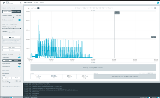

SDK 3.0.2, nrf9160 (actinius icarus som), custom board, based on modules example. LTE-M with PSM.

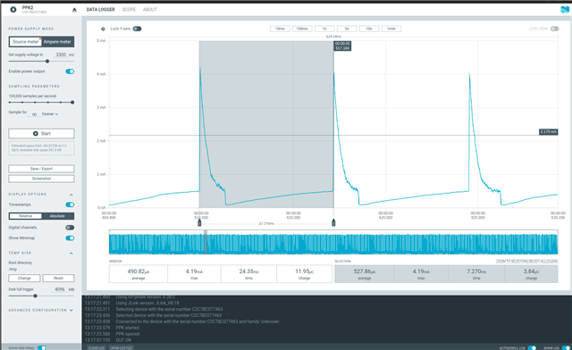

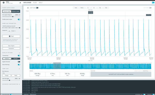

Floor current is too high, at around 500 uA. There is a known issue on the custom board but approx. 450 uA are left. Attached is the behavior after reset and then zoom into where I would expect way less current consumption. Something is pulsing at a rate of ~7ms.

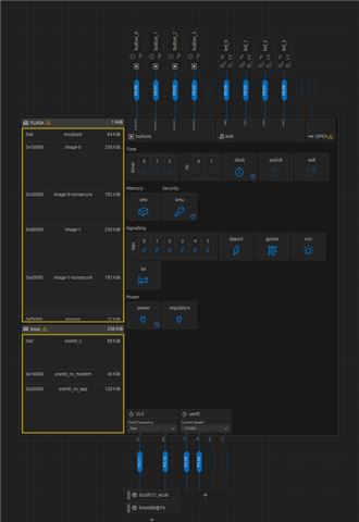

This is the build config:
and the .config from output:
CONFIG_PM_DEVICE=y
CONFIG_PM_DEVICE_POWER_DOMAIN=y
CONFIG_PM_DEVICE_RUNTIME=y
# CONFIG_LOG is not set
# CONFIG_SERIAL is not set
CONFIG_TFM_LOG_LEVEL_SILENCE=y
Devicetree:
