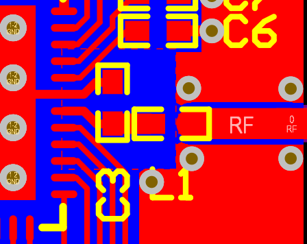

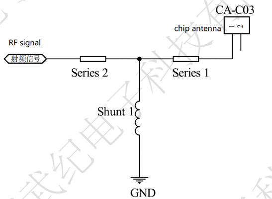

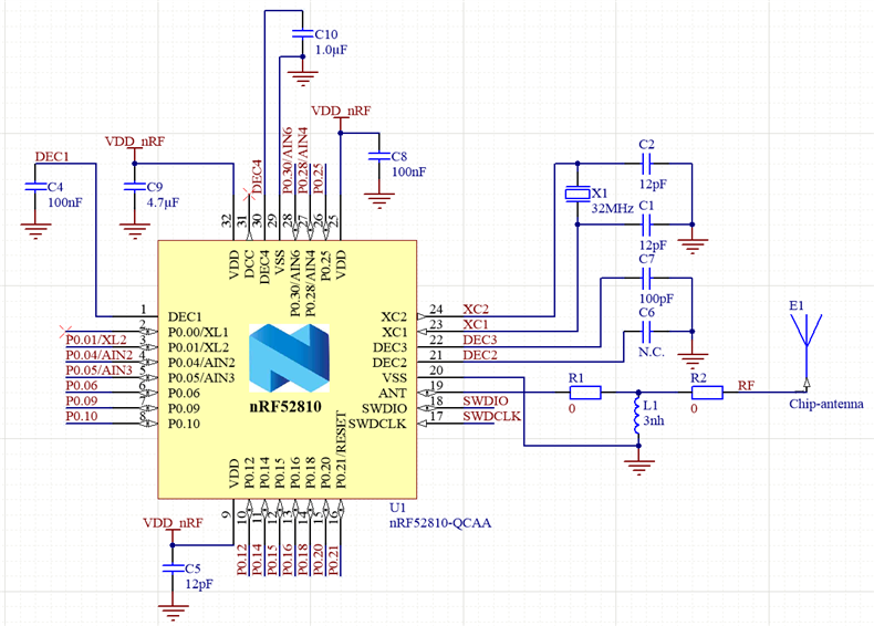

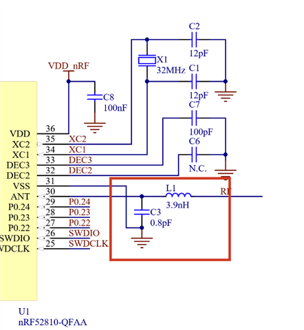

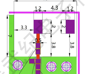

There is 1 question: do we need the antenna?
Just 1 line on FPC is enough? For the distance between watch & mobile/PC is very short.
