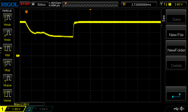

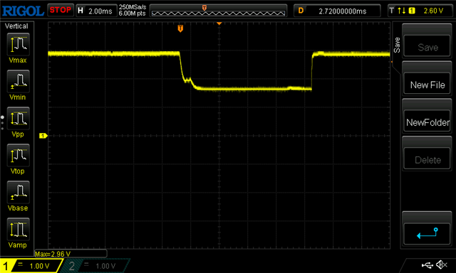

I would expect that if I set VBAT=2.5V for example (with a regulable power supply), the system will go off. It does, but it reboots immediately. It reboots, then goes off, then reboots, then goes off, ...
I checked that it has to be the LPCOMP resetting the system, because if I don't program LPCOMP the system never resets.
Why LPCOMP does wake the device up immediately after SystemOff?
VBAT=VDD=2.5V, that means that AIN3 = 1.5V < 6/8*VDD = 1.875V, set in LPCOMP. The ANADETECT signal should not be triggered.
Is there a problem with the high resistance of the voltage divider? Is there something I wrote wrong?
In another test I changed the LPCOMP input to AIN7, which is Not Connected to anywhere, and it also reboots automatically.

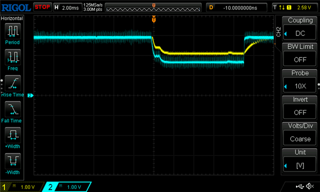

    You can try to disable global interrupts before executing this, and in that case also use directly NRF_POWER->SYSTEMOFF = 1; (if I remember correctly). On wakeup you can try to double check that it's waking up from system off reset (and not a soft reset due to fatal error or similar) by reading the RESETREAS register:
    https://docs.nordicsemi.com/bundle/ps_nrf52840/page/power.html#ariaid-title35
    Maybe it's another wakeup source happening here.
