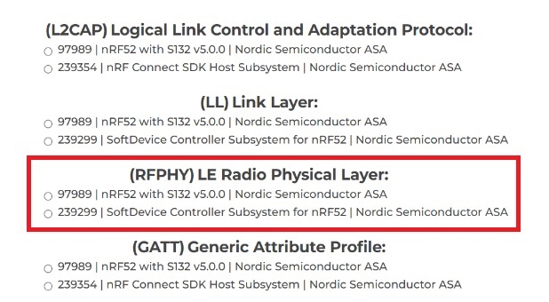

  • Hello Hieu.
    Just to confirm, as shown in the image, should I select 97989 for the RFPHY item and select 239299 for all other items?
    Is it necessary to conduct additional tests?
    Thank you.
  • Hi ReoN,
    I can't access the QDID search now, so I cannot confirm that numbers are the correct one.
    You can select the module's QDID number for RFPHY.
    For the other parts, they are not all the same number. Notice that the LL part has to use the QDID number for the SoftDevice Controller, and the L2CAP and GATT parts have to use the QDID number for the nRF Connect SDK Host Subsystem.

  • Hi ReoN,
    The Link Layer is a part of the Bluetooth LE Controller, not the RFPHY layer.
    You do need to use the QDID of the default Bluetooth LE Controller in NCS, which is named "SoftDevice Controller"
    You must not use the one for the S132 v5.0.0.
    While the term "SoftDevice Controller" and "SoftDevice" sound similar, they refer to two different things.
    SoftDevice is a part of the nRF5 SDK solution. The component S132 or S140 are different SoftDevices with different capabilities and compatibilities with different SoCs.
    A SoftDevice Controller is a part of the NCS solution. It is the Bluetooth LE Controller there.
    Hieu
