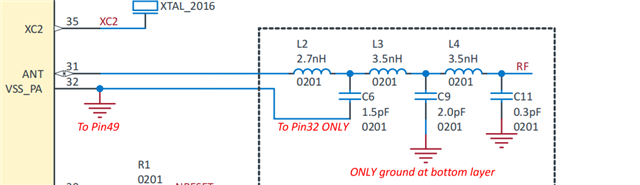

In the reference schematic design of the 54L, why does the RF circuit use three LC circuits? What is the purpose? This approach would likely result in higher insertion loss, so why not use a low-pass π-circuit instead?
This is a harmonics filter.
Because the harmonic suppression won't be good enough.
