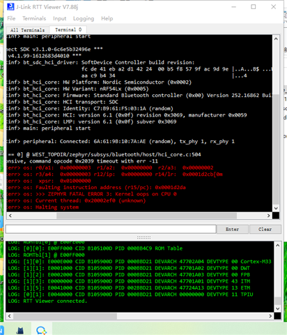

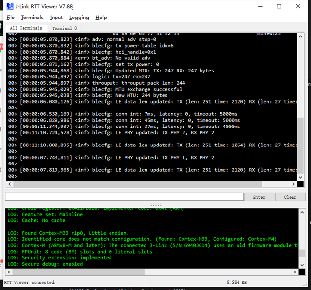

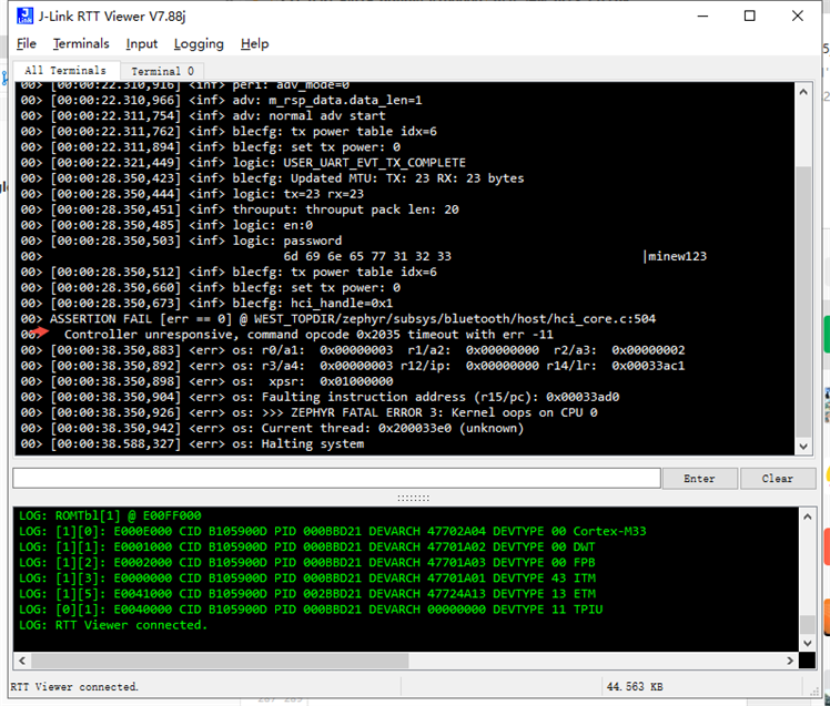

NCS 3.1.0 vble connect error at bt_hci_cmd_send_sync()
I am using nrf54l15 with NCS v3.1.0 with the following error when i connect it(i worked in NCS v2.9.1 successfully):
Controller unresponsive, command opcode 0x2035 timeout with err -11 in bt_hci_cmd_send_sync() function;
some error log info:
for matching ncs 3.1.0 I change this code:
bt_hci_cmd_create()  was  deprecated,
So, I modified the functionality implemented with bt_hci_cmd_create to the code shown in the above image. Now it compiles successfully, but when connecting to the device and trying to reset the transmit power, the errors mentioned earlier occur.

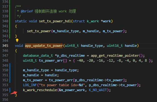

My solution is to place set_tx_power inside a k_work_init_delayable for initialization and call it upon connection, while also stopping advertising during the connection. With this approach, the device can now connect successfully.

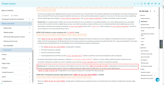

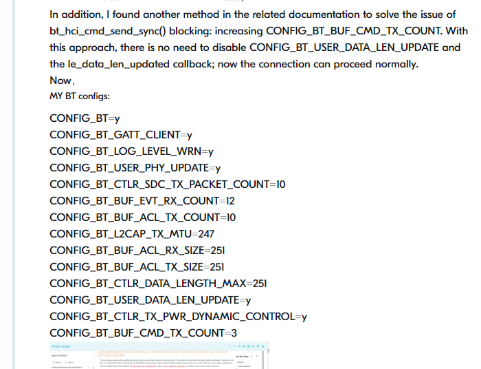

    You are right, usigng a workqueue is a sensible approach in this case. I do not see any problems with your approach. (For reference, here is a similar thread from last week discussing this).
  • THANKS ! However, I still have some doubts. In version 3.1.0, why is it necessary to stop adv when a connection is established, and why must the power setting be executed within a task? Both are indispensable; only with them can the connection work properly
    I do not see the code where you do length update, but likely you are calling it from teh conneted callback similar as you do with bt_conn_le_phy_update()? That should not be done and insted it shoudl be deferred to later usin gfor instance a workqueue, as we have discussed earlier in this thread.
    If this does not resolve it, can you share your code (as text, not screenshots, and showing all relevant Bluetooth parts so that I get an understanding), as well as explain in wat whay connection fails now?

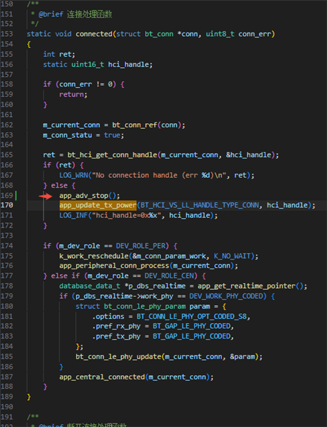

     * @brief 连接处理函数
    static void connected(struct bt_conn *conn, uint8_t conn_err)
        int ret;
        static uint16_t hci_handle;
        if (conn_err != 0) {
            return;
        m_current_conn = bt_conn_ref(conn);
        m_conn_statu = true;
        ret = bt_hci_get_conn_handle(m_current_conn, &hci_handle);
        if (ret) {
            LOG_WRN("No connection handle (err %d)\n", ret);
        } else {
            app_update_tx_power(BT_HCI_VS_LL_HANDLE_TYPE_CONN, hci_handle);
            LOG_INF("hci_handle=0x%x", hci_handle);
        if (m_dev_role == DEV_ROLE_PER) {
            k_work_reschedule(&m_conn_param_work, K_NO_WAIT);
            app_peripheral_conn_process(m_current_conn);
        } else if (m_dev_role == DEV_ROLE_CEN) {
            database_data_t *p_dbs_realtime = app_get_realtime_pointer();
            if (p_dbs_realtime->work_phy == DEV_WORK_PHY_CODED) {
                struct bt_conn_le_phy_param param = {
                    .options = BT_CONN_LE_PHY_OPT_CODED_S8,
                    .pref_rx_phy = BT_GAP_LE_PHY_CODED,
                    .pref_tx_phy = BT_GAP_LE_PHY_CODED,
                bt_conn_le_phy_update(m_current_conn, &param);
            app_central_connected(m_current_conn);

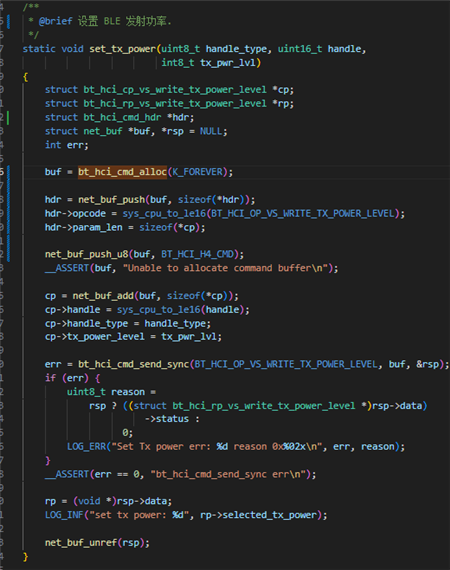

     * @brief 设置 BLE 发射功率.
    static void set_tx_power(uint8_t handle_type, uint16_t handle,
                             int8_t tx_pwr_lvl)
        struct bt_hci_cp_vs_write_tx_power_level *cp;
        struct bt_hci_rp_vs_write_tx_power_level *rp;
        struct bt_hci_cmd_hdr *hdr;
        struct net_buf *buf, *rsp = NULL;
        int err;
        buf = bt_hci_cmd_alloc(K_FOREVER);
        hdr = net_buf_push(buf, sizeof(*hdr));
        hdr->opcode = sys_cpu_to_le16(BT_HCI_OP_VS_WRITE_TX_POWER_LEVEL);
        hdr->param_len = sizeof(*cp);
        net_buf_push_u8(buf, BT_HCI_H4_CMD);
        __ASSERT(buf, "Unable to allocate command buffer\n");
        cp = net_buf_add(buf, sizeof(*cp));
        cp->handle = sys_cpu_to_le16(handle);
        cp->handle_type = handle_type;
        cp->tx_power_level = tx_pwr_lvl;
        err = bt_hci_cmd_send_sync(BT_HCI_OP_VS_WRITE_TX_POWER_LEVEL, buf, &rsp);
        if (err) {
            uint8_t reason =
                rsp ? ((struct bt_hci_rp_vs_write_tx_power_level *)rsp->data)
                          ->status :
                      0;
            LOG_ERR("Set Tx power err: %d reason 0x%02x\n", err, reason);
        __ASSERT(err == 0, "bt_hci_cmd_send_sync err\n");
        rp = (void *)rsp->data;
        LOG_INF("set tx power: %d", rp->selected_tx_power);
        net_buf_unref(rsp);

    void app_update_tx_power(uint8_t handle_type, uint16_t handle)
        uint8_t tx_power_arr[] = { -40, -20, -16, -12, -8, -4, 0, 4, 8 };
        LOG_INF("tx power table idx=%d", p_dbs_realtime->tx_power);
        set_tx_power(handle_type, handle, tx_power_arr[p_dbs_realtime->tx_power]);

    void app_peripheral_conn_process(struct bt_conn *conn)
        m_current_conn = conn;
    void app_peripheral_disc_process(void)
        m_current_conn = NULL;

    The code above is the callback part for my slave device’s connection or disconnection events and ble init. I had to disable le_data_len_updated and CONFIG_BT_USER_DATA_LEN_UPDATE for the connection to work properly; otherwise, the following error occurs.
    In addition, I found another method in the related documentation to solve the issue of bt_hci_cmd_send_sync() blocking: increasing CONFIG_BT_BUF_CMD_TX_COUNT. With this approach, there is no need to disable CONFIG_BT_USER_DATA_LEN_UPDATE and the le_data_len_updated callback; now the connection can proceed normally.
    Now,
    MY BT configs:
    CONFIG_BT=y
    CONFIG_BT_GATT_CLIENT=y
    CONFIG_BT_LOG_LEVEL_WRN=y
    CONFIG_BT_USER_PHY_UPDATE=y
    CONFIG_BT_CTLR_SDC_TX_PACKET_COUNT=10
    CONFIG_BT_BUF_EVT_RX_COUNT=12
    CONFIG_BT_BUF_ACL_TX_COUNT=10
    CONFIG_BT_L2CAP_TX_MTU=247
    CONFIG_BT_BUF_ACL_RX_SIZE=251
    CONFIG_BT_BUF_ACL_TX_SIZE=251
    CONFIG_BT_CTLR_DATA_LENGTH_MAX=251
    CONFIG_BT_USER_DATA_LEN_UPDATE=y
    CONFIG_BT_CTLR_TX_PWR_DYNAMIC_CONTROL=y
    CONFIG_BT_BUF_CMD_TX_COUNT=3

    Here is a simple Bluetooth slave example using SDK version 3.1.0 and the nrf54l15dk/cpuapp board. If CONFIG_BT_CENTRAL=y is added to prj.conf, the same issue occurs during connection; but if it is disabled, the connection works normally. Could this be a potential issue in the new SDK?
    I was not able to test this now, but we have found an issue in the stack that could be related to this. We are wokring on fixing it, but for now you may work around it by increasing the number of Tx command buffers. Can you try setting for instance CONFIG_BT_BUF_CMD_TX_COUNT=10 in your prj.conf?
  • Increase CONFIG_BT_BUF_CMD_TX_COUNT can solve the problem
