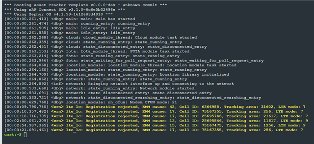

I was busy extending the asset tracker project and all of a sudden I got this lte rejection.
First I thought maybe it the data limit has reached on the conexa sim, but when I place a new omondo sim in it, I get similar EMM Causes.
What could be the issue here?
I moved the DK closer to the window and also tried to connect an antenna to it, but still no luck.

    Could you elaborate more on what you were adding/changing in the Asset Tracker template? Just to confirm, are you building with the NCS 3.1.0 branch? What modem FW is your device running?
    From the provided logs the device is rejected on both LTE-M and NB-IoT.
    Cause #42 – Severe network failure
    This EMM cause is sent to the UE when the network has determined that the requested procedure cannot be completed successfully due to network failure. The failure is not expected to be temporary and repeated request is not likely to succeed in near future.
    Cause #17 – Network failure
    This EMM cause is sent to the UE if the MME cannot service an UE generated request because of PLMN failures.
    Cause #13 – Roaming not allowed in this tracking area
    This EMM cause is sent to an UE which requests service, or if the network initiates a detach request, in a tracking area of a PLMN which by subscription offers roaming to that UE but not in that tracking area.
    Cause #15 – No suitable cells in tracking area
    This EMM cause is sent to the UE if it requests service, or if the network initiates a detach request, in a tracking area where the UE, by subscription, is not allowed to operate, but when it should find another allowed tracking area or location area in the same PLMN or an equivalent PLMN.
    NOTE 3:  Cause #15 and cause #12 differ in the fact that cause #12 does not trigger the UE to search for another allowed tracking area on the same PLMN.

    I'm relatively sure it has nothing to do with the application, but to have a good reference, I programmed the multi-service quickstart into the SIP with modem 2.0.2
    I have 3 modem traces made with the same application. (see attachments)
    Both Onomodo and Conexa failed to connect.
    But I had an old T-Mobile IoT SIM that I would not expect to work at all after it became Odido, but surprisingly that one works and connects to iot.1nce.net.
    Also the CoAP message arrive at nrfcloud with this T-Mobile SIM.
