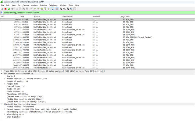

  • hi,
    ok let me expian you the steps which i followd and also below i will attache the screenstop so you can view that and tell me where i am missing  step
    1)firstly i will open the nRF connect for desktop tool  -> programmer section -> i will connect to the board nRF52833dk board -> add file i have attached .hex file (blow attached) -> i clicked erase & write option
    2) in this step i will open the wireshark tool and in capture section i see nrf sniffer for bluetooth LE  com 7 i start capturing
    3) in this step i will open vscode and build my code which is shard with you previously that was build and flashed to board
    4)after that i will go to wireshak tool i added the below filter  btle.advertising_address == 7c:d9:f4:14:05:a8 and whati received that screen shot  attached blow
    so  i am not understaing what should i do next and aslo where is the problem in code i think in central code is not sending any connection request can you check and tell me , in code which part what should i change??
    I do not see any connection attemt in the screenshot but the time between advertising packets sticks out as quite long and variabe. It might not be related, but I wonder what the advertising interval is and what environment you are testing in? Can you upload the full sniffer trace?
    Normally I would ask to configure the sniffer to follow any connection established for that advertiser as described here. Howeer, as the error is BT_HCI_ERR_UNKNOWN_CONN_ID, it is likely that the nRF neve rattempts to connect.
    Given that advertising packets are received quite rarely by the sniffer, I wonder if the timeout when establishing the connectiong is a problem? I see you do not set a specific timeout, which meanst hat the default timeout from CONFIG_BT_CREATE_CONN_TIMEOUT is used. Does it make a difference if you set this to a high value in your prj.conf? For instance CONFIG_BT_CREATE_CONN_TIMEOUT=60 would give a 60 second timeout.
