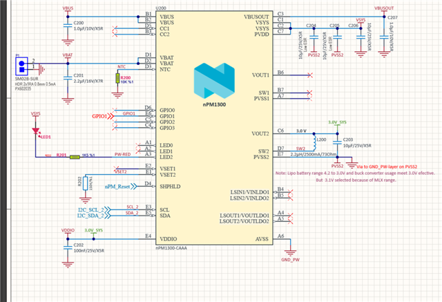

We have a custom board with npm1300 seem below.  Im loosing 3mA more than expected.
I used npm1300 both Vout1 and Vout2 before in other project. Same design and copmonents except using one output. Its a bga package.

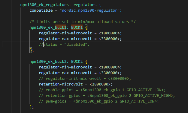

I tried disable Buck1 from software but not sure achieced. Still sinking 3mA.
I powered 3.0V externaly and board worked with 500uA consumption.
Do i have to connect Vset1 to ground or is there any alternative way.
