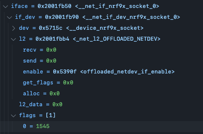

    The return code -19 *(ENODEV) comes from when the application tries to add an IPv4 address to the LTE network interface.
    See the call stack here:
    The API which returns an error is  `net_if_config_ipv4_get`.
    In this function, it checks if the NET_IF_IPV4 flag is set on the interface, which returns false.
    This error then leads to the -19 (ENODEV) error that is printed in my original question.
    This is what `iface` looks like when it checks if the flag is set. flags = 1545. NET_IF_IPV4 is not set.
    So it seems that IPV4 is not enabled on the LTE Network interface device for some reason.

  • Hi Jason,
    You have configured CONFIG_NET_CONNECTION_MANAGER=y, and you use conn_mgr_all_if_up() and conn_mgr_all_if_connect() from Connection Manager Connectivity API. In case when connection manager is used, it is required that you also have CONFIG_NET_NATIVE=y.
    Dejan
  • Thanks Dejan - I can see that it works when I disable CONFIG_NET_CONNECTION_MANAGER. I will leave CONFIG_NET_NATIVE enabled and continue to use CONFIG_NET_CONNECTION_MANAGER.
