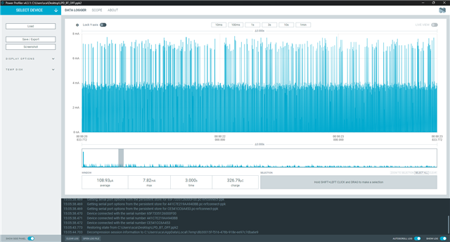

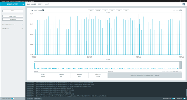

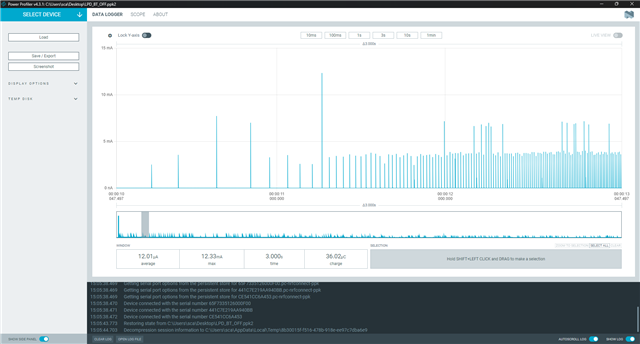

OFF START (After 0 sec / 12.01uA) OK
OFF MIDDLE (After 10 sec / 108.93uA) NOT OK
OFF END (3 minutes / 5.68uA) OK
How can these good results be achieved in a shorter time?

    Here I send the complete measurment I made with the PPK2

    These PPK2 measurements are taken from the VBAT side? That is, PPK2 is acting as a power supply for VBAT? What does the VOUT load profile look like at this time?
    Would it also be possible to look at the schematics for the nPM2100 to see if there could be potential issues? That can be done via a private techsupport case.
    The "discharge"-type behavior makes me wonder if there could be capacitance somewhere that affects performance.

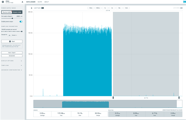

    I tried to recreate the behavior on an nPM2100 EK, but I have been unsuccessful so far. This is the profile I see when connecting and disconnecting a 10 mA constant current load, using 100 uF VINT capacitance:
    Note that the PPK2 struggles a bit when measuring the nPM2100 (and other BOOST converters presumably), due to the very short current spikes seen on the VBAT side. The 100 kHz sampling rate of the PPK2 does not capture all of these, and it is easy to get an underestimated current measurement value.
