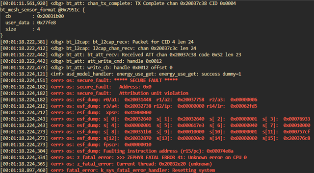

  • Thanks for the response Terje,
    So I've updated the energy_use_get function to the below:
    static int energy_use_get(struct bt_mesh_sensor_srv   *srv,
                              struct bt_mesh_sensor       *sensor,
                              struct bt_mesh_msg_ctx      *ctx,
                              struct bt_mesh_sensor_value *rsp)
        /* Report energy usage as dummy value, and increase it by one every time
         * a get callback is triggered. The logic and hardware for mesuring
         * the actual energy usage of the device should be implemented here.
        // int64_t micro = (int64_t)dummy_energy_use * 1000000LL;
        const struct bt_mesh_sensor_format* fmt = sensor->type->channels[0].format;
        if (!fmt) {
            printf("bt_mesh_sensor_format: (null)\n");
            return;
        printf("bt_mesh_sensor_format @%p {\n", (void *)fmt);
        printf("  cb        : %p\n", (void *)fmt->cb);
        printf("  user_data : %p\n", fmt->user_data);
        printf("  size      : %zu\n", fmt->size);
    #ifdef CONFIG_BT_MESH_SENSOR_LABELS
        printf("  unit      : %p\n", (void *)fmt->unit);
        printf("}\n");
        // int rc = bt_mesh_sensor_value_from_micro(sensor->type->channels[0].format, micro, rsp);
        // if (rc)
        //     LOG_ERR("energy_use_get: bt_mesh_sensor_value_from_micro failed: %d", rc);
        //     return rc;
        dummy_energy_use++;
        LOG_INF("energy_use_get: success dummy=%d", dummy_energy_use);
        return 0;
    And when I try get sensor information the console reads:
    Using addr2line again on 0x00074e8a it returns:
    <project-root>/external/nrf/subsys/bluetooth/mesh/sensor.c:55
    line 55 is:
    if (fmt->cb->compare(&threshold->range.high,
