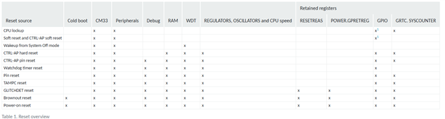

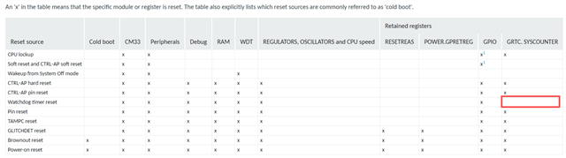

I am using the nrf54l15-dk. I had a look at the datasheet and it shows that a watchdog reset does not reset the GRTC. On my code, I tested that and I see that GRTC resets when WDT resets. Is there any option to avoid this? Something which I may need to configure?
