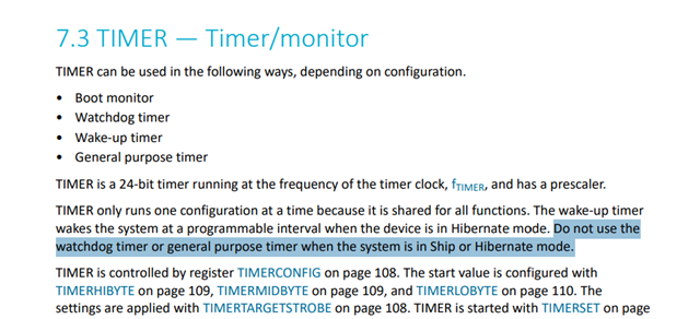

We are in the process of integrating the NPM1304 into a small battery (55mAh) wearable device. I am finding it hard to figure out section 7.3.2
regarding the Watchdog. We would like the Watchdog timer expiration to generate a power cycle, but cannot figure out which registers need to
be set for this or how the hardware needs to be set up.

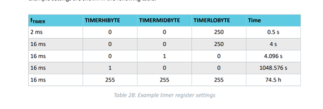

2) can the watchdog pat cycle be greater than a day, and can this be achieved when in Sleep Mode?
