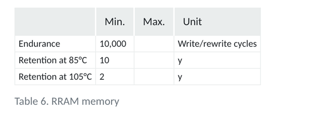

This table for the absolute maximum ratings isn't clear.
Can you help confirm the unit "y" here for RRAM retention? Is this years? Is it cumulatively years or consecutive?
Unit is years.
Not sure what you mean with cumulative or consecutive - its wall clock time. 10 years if the device never gets hotter than 85°C, 2 years if it ever gotten hotter than 85 but not higher than 105°C.Note that these are probably chip internal temps and not outside case temps (but I could be wrong here, not a nordic employee), but that matters little for a low power chip.
"y" refers to years. It refers to number of years that the data can be reliably retained without power at the mentioned temperature.
Ressa
I think the question is, if you reprogram the RRAM at some point, will the retention cycle restart from zero again.
Yes it will restart from recent write.
