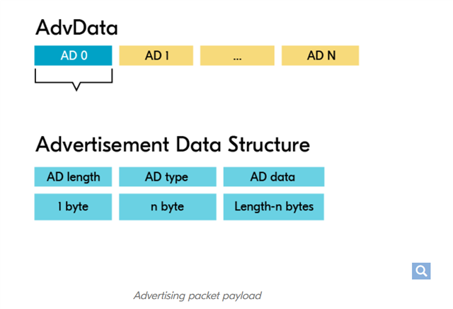

    I have not tested, but it looks like by default, the advertising name is set to the CONFIG_BLE_ADV_NAME in ble_adv_init() from ble_adv.c. CONFIG_BLE_ADV_NAME is defined in prj.conf.
    I believe the easiest way to update the advertising data (including the advertising name), is to use ble_adv_data_update() directly. This does require you to build up your ble_adv_data *adv_data and ble_adv_data *sr_data manually. For this, you can use ble_adv_data_encode(), or you can read up on how an advertising packet is built up. It is described briefly here:
    https://academy.nordicsemi.com/courses/bluetooth-low-energy-fundamentals/lessons/lesson-2-bluetooth-le-advertising/topic/advertisement-packet/
    Basically, each advertising packet has one or more data structures that consists of 1 byte of structure length, one byte of AD type, and then length-1 bytes of payload.
