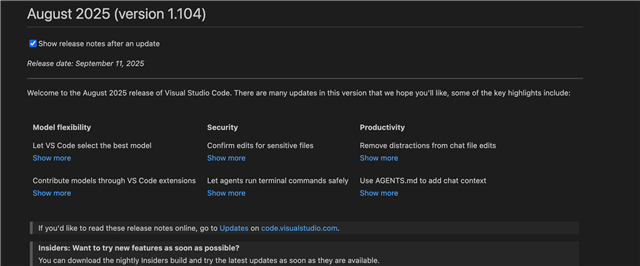

Boards not detecting after today's vscode update
After today's  vscode upgrade boards aren't detecting on my pc & on my colleagues pc neither.
While same board is getting detected on another one of my colleagues pc.
Kindly help mitigate this update issue

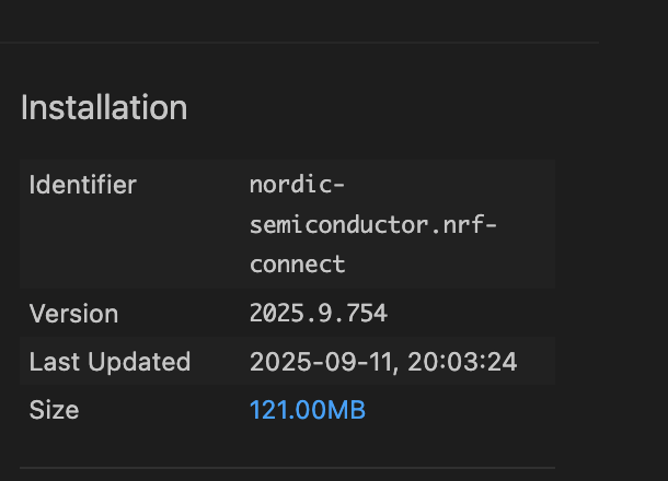

    Could you tell me your VSCode version as well as your nRF Connect VSCode extension version?
    -Priyanka

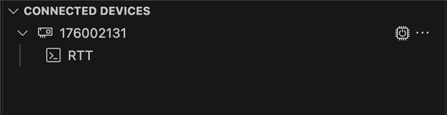

    What is more strange is:
    Board is not visible :
    But I am able to erase flash & also debug with ozone:
