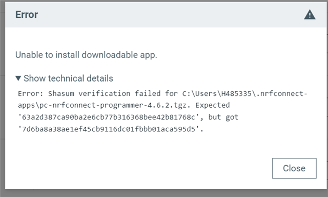

Hi Team, I am Unable to install Programmer in the NRF Connect DESKTOP,
Do you have any logs or error message that appears? if yes, can you please share this?
Håkon
Try deleting the file referenced in the error message, and re-install it again. If it still fails, I suspect that there's a company wide policy (virus scanner?) that is somehow altering the downloaded .tgz file.
Håkon
yeah, I have tried that already, deleting and re installing
Here's the direct link:
You can try downloading it manually and placing it in this formerly mentioned folder
Håkon Alseth said:I suspect that there's a company wide policy (virus scanner?) that is somehow altering the downloaded .tgz file.
Does your colleagues have the same issue as you?

ok I will try manually and let you now, my colleagues do not have any issue with programmer
Madhusudhan D said:my colleagues do not have any issue with programmer
Good to hear that this test worked as intended.
Have you been able to successfully run this on your local PC?
