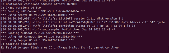

I am looking to create use a pm_static.yml to create a partition table for MCUBoot, which have the internal flash as the primary boot partition and the external SPI flash as the secondary partition.  As I know XIP only can be performed on QSPI, can this be done.  If so, how can I do this via SPI?
Here's my current pm_static.ym;

After flashing it to my nrf7002DK, I get the following message.
I am using NCS v3.1.0 and I am basing off of the sample smp_svr.  Any help would be greatly appreciated.
