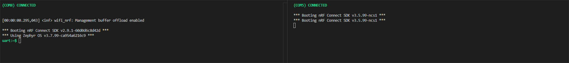

I'm trying to combine Wifi and BLE frequency test on nRF7002 DK. I started with radio_test example on nRF SDK 2.9.1 and toolchain 3.0.2.
I have added CONFIG_NRF70_RADIO_TEST_COMBO=y to prj.conf as suggested on others tickets. The project is compiling and I can send commands to tests the wifi on VCOM1 (logs from app core). On VCOM0, " *** Booting nRF Connect SDK v3.5.99-ncs1 *** " is printed twice but nothing after on net core. I can't send ble test commands  like "start_tx_carrier" and i have no more logs.

  • In addition, this are the uart terminal outputs:
    Mallory.
