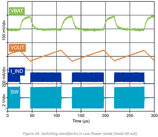

Figure 24 shows the Switching waveforms in Low Power mode, VOUT = 3.0V, VIN = 1.5V (alkaline AA battery), load = 30mA

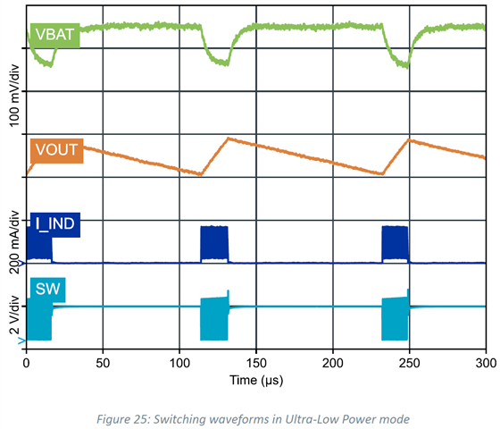

Figure 25 shows the Switching waveforms in Ultra-Low Power mode, VOUT = 1.8V, VIN = 1.5V (alkaline AA battery), load = 10mA
The figures show bursts in inductor current to replenish VOUT.
The average inductor current during these burst for both Figure 24 and Figure 25 looks to be ~100mA.
My question is: Why is it 100mA? Is this dependent on the output capacitance? Is there a limit being imposed, and if so, is this limit configurable?
