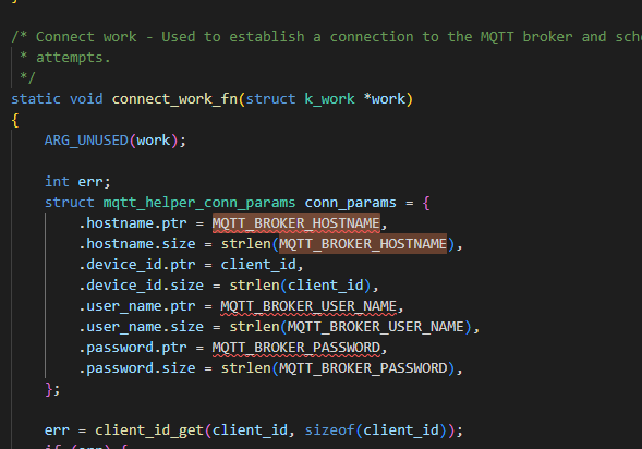

Hi Nordic Team,
I'm currently working on integrating TagoIO using MQTT in our application. While attempting to add the MQTT connection details—specifically the username and password—into the struct mqtt_helper_conn_params conn_params within the connect_work_fn, I noticed that the hostname and port number are accepted without issues, but the username and password do not seem to be supported.
We're using nRF Connect SDK v3.1.0, and I couldn't find any documentation or examples indicating support for authentication via username and password in this version. Could you please confirm whether SDK v3.1.0 supports MQTT authentication using username and password? If not, is there a recommended workaround or plan to support this in future releases?
Thanks in advance for your support.
Rajeshwar Tokala
Embedded Engineer II
    mqtt library supports using username and password for auth.
    The mqtt-helper can be expanded, more specifically in this struct:
    https://github.com/nrfconnect/sdk-nrf/blob/v3.1.0/include/net/mqtt_helper.h#L94-L95
    https://github.com/nrfconnect/sdk-nrf/blob/v3.1.0/samples/net/mqtt/src/modules/transport/transport.c#L187-L192
    To hold the .user_name and .password as well.
    Let me know if anything is unclear.
    Can you share what you implemented for .user_name and .password?

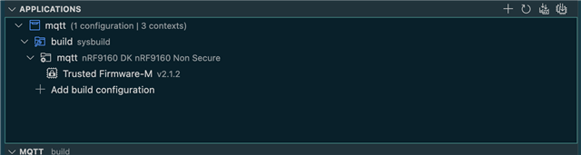

    • I'm facing two issues while working with SDK v3.1.0:
      Issue 1: same as above topic
      When I try to add MQTT username and password macros in prj.conf, I get build-time errors. It seems SDK v3.1.0 may not support authentication via mqtt_helper_conn_params. Please confirm if this is supported and suggest the correct approach if available.
      Issue 2: different topic
      sometimes After Build successful .hex file is not being generated. The build completes without showing errors, but the output file is missing.
      Could you please help clarify both issues?
      Rajeshwar Tokala
    Kconfig entries must be added by you to support this, which needs to be manually added by you in this file:
    https://github.com/nrfconnect/sdk-nrf/blob/v3.1.0/samples/net/mqtt/src/modules/transport/Kconfig.transport
    In addition to the actual .c implementation as previously mentioned:

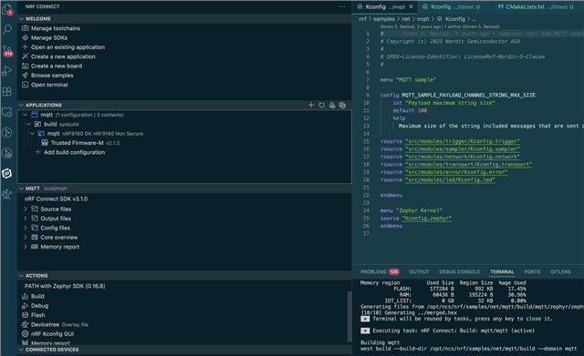

    Thank you for the logs.
    west build --build-dir c:/ncs/mqtt/build --domain mqtt
    This indicates that you have selected the subimage mqtt, similar to what I have done here:
    You can see that mqtt -> build -> mqtt is expanded and the last one is selected.
    What you want is to select the top-most project, so that "build" is blue:
    Could you try this and see if merged.hex is updated now?
    Håkon
  • After adding in Kconfig.transport file also i am getting same errors. Undefined variable's
  • Can you please share what you changed, and what your compiler output is?
