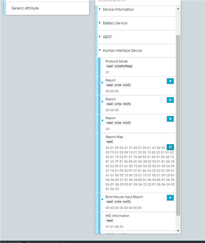

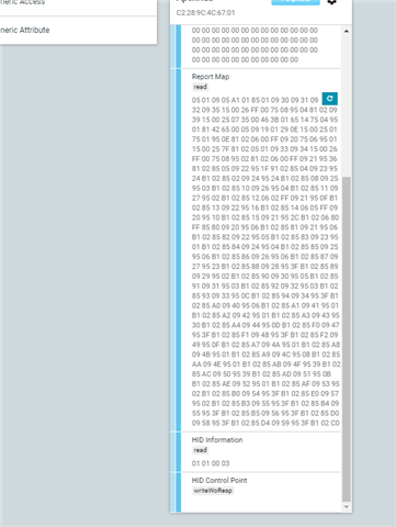

I was no luck trying out the nrf sniffer with wireshark, it seems cannot find the port for the sniffer dongle, the images shows that the hid report map is changed. However, I am having difficulties with device running with operating system like windows. The hid desciptor map is not updated, and result in only operational while the device is in the same mode with that when it is paired with the system.
Ok, so if you see the change using nRF Connect for Desktop -> Bluetooth Low Energy, then you verify that the HID descriptor is in fact changed.
That also suggests that the issue lies with the OS.
