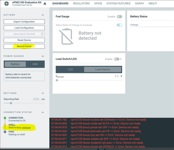

my nPM2100-EK can no longer connect to the PowerUP app....  all was working fine for the first few days, but no nothing....  the problem is the same on my PC and Mac....
when i launch PowerUP, it does detect the board:
but when i attempt to connect, the error messages roll continuously:
the board IS powered; the green LED is flashing about 2Hz....
i've currently select VEXT as my power source; but i get the same failure if i select VBAT and plugin a battery board....
from what i recall, this happened the VERY FIRST time i fired up the EK; but after some reboots, everything seemed to settle down -- until now....
is there a firmware image i could load onto the controller????
i'll verify again, but i believe all the jumpers are in their default configuration....
    From the logs, it seems that the nPM2100 is not powered. The green LED flashing at about 2 Hz also indicates an unpowered PMIC ,if the PMIC were powered, the LED would be pulsing instead.
    Could you also try clicking Unpause under this condition? Please use the Record Event option and send us the log.

    2025-09-18T14:08:58.751Z WARN module_pmic: No response from PMIC.
    2025-09-18T14:08:58.762Z ERROR module_pmic_adc: Error: ADC reading failed (-5)
    2025-09-18T14:08:59.247Z WARN module_pmic: No response from PMIC.
    2025-09-18T14:08:59.256Z ERROR module_pmic_adc: Error: ADC reading failed (-5)
    2025-09-18T14:09:00.297Z WARN module_pmic: No response from PMIC.
    2025-09-18T14:09:00.302Z ERROR module_pmic_adc: Error: ADC reading failed (-5)
    2025-09-18T14:09:00.311Z WARN module_pmic: No response from PMIC.
    2025-09-18T14:09:00.315Z ERROR module_pmic_adc: Error: ADC reading failed (-5)
    2025-09-18T14:09:00.366Z ERROR npm2100 boost voutsel set Software => Error: Device not ready
    2025-09-18T14:09:00.385Z ERROR npm2100 boost mode set AUTO => Error: Device not ready
    2025-09-18T14:09:00.403Z ERROR npm2100 boost pinsel set OFF => Error: Device not ready
    2025-09-18T14:09:00.421Z ERROR npm2100 boost pinmode set HP => Error: Device not ready
    2025-09-18T14:09:00.438Z ERROR npm2100 boost ocp set ON => Error: Device not ready
    2025-09-18T14:09:00.455Z ERROR npm2100 ldosw enable set OFF => Error: Device not ready
    2025-09-18T14:09:00.476Z ERROR npm2100 ldosw modectrl set auto => Error: Device not ready
    2025-09-18T14:09:00.496Z ERROR npm2100 ldosw pinsel set GPIO0LO => Error: Device not ready
    2025-09-18T14:09:00.517Z ERROR npm2100 ldosw softstart LDO set 75mA => Error: Device not ready
    2025-09-18T14:09:00.541Z ERROR npm2100 ldosw softstart LOADSW set 75mA => Error: Device not ready
    2025-09-18T14:09:00.561Z ERROR npm2100 ldosw pinmode set HP/OFF => Error: Device not ready
    2025-09-18T14:09:00.578Z ERROR npm2100 ldosw ocp set ON => Error: Device not ready
    2025-09-18T14:18:04.276Z ERROR Unable to open the log file: Error: Error invoking remote method 'open:file': Error: Could not find file at path: /Users/bob/Library/Application Support/nrfconnect/pc-nrfconnect-npm/logs/2025-09-18T14_08_26.972Z-log.txt
    2025-09-18T14:18:06.107Z ERROR Unable to open the log file: Error: Error invoking remote method 'open:file': Error: Could not find file at path: /Users/bob/Library/Application Support/nrfconnect/pc-nrfconnect-npm/logs/2025-09-18T14_08_26.972Z-log.txt
    2025-09-18T14:18:07.222Z ERROR Unable to open the log file: Error: Error invoking remote method 'open:file': Error: Could not find file at path: /Users/bob/Library/Application Support/nrfconnect/pc-nrfconnect-npm/logs/2025-09-18T14_08_26.972Z-log.txt
    2025-09-18T14:18:35.495Z ERROR Unable to open the log file: Error: Error invoking remote method 'open:file': Error: Could not find file at path: /Users/bob/Library/Application Support/nrfconnect/pc-nrfconnect-npm/logs/2025-09-18T14_08_26.972Z-log.txt
    2025-09-18T14:18:36.289Z ERROR Unable to open the log file: Error: Error invoking remote method 'open:file': Error: Could not find file at path: /Users/bob/Library/Application Support/nrfconnect/pc-nrfconnect-npm/logs/2025-09-18T14_08_26.972Z-log.txt
    here's the log....  but if you're already telling me that a flashing LED means the board isn't powered, i don't know what you expect to find here....
    to confirm, VOUT is *not* measuring at 1.8V or 3.0V....
    Could you upload a picture of your evaluation board so we can confirm that all the jumpers are in the correct position?
    If the jumper configuration looks fine, the issue might be that either the board or the PMIC is damaged and no longer operational. If you are not seeing 1.8V or 3V at VOUT, it could mean that VBAT is missing, the nPM2100 is damaged, or VOUT is shorted to GND on the board.
    Kind Regards,
    Abhijith
