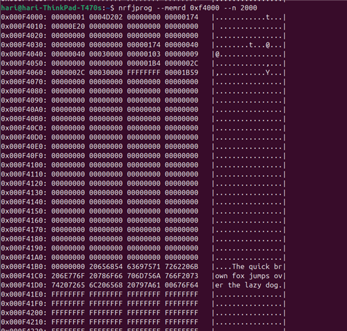

Hi, I am working on storing data in the Trusted Zone using the PSA APIs.

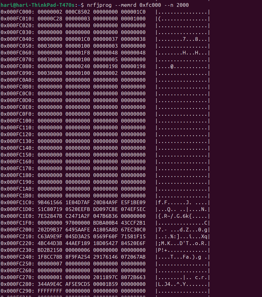

I tried the Protected Storage (PS) example. When I store data using psa_ps_set() and then read the flash memory with nrfjprog, I see some data that looks encrypted (random bytes). I cannot see the original plaintext.
However, when I use psa_its_set() in the same example and dump the flash, I can see the raw data in plaintext.
  1. Why does this happen?

  2. I also noticed that when I use psa_ps_set(), the memory region starts from 0xFC00, but the data is not written exactly at the beginning of that region. Could you explain how TF-M organizes storage in flash?
    • Is encryption automatically enabled for Protected Storage (PS)?
    • Do I need to enable encryption for Internal Trusted Storage (ITS) separately?

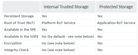

    In the PSA Secure Storage API documentation, you can find the following table
    Note: Internal Trusted Storage has experimental support for encryption with the CONFIG_PSA_ITS_ENCRYPTED Kconfig option set.
    You can look at TF-M Services. There you can find information on sizing ITS and PS partitions.

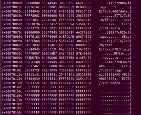

    i have one more doubt, i see that
    I am using PSA ITS (psa_its_set()). My understanding is that ITS should always store in the TF-M ITS partition (tfm_its).
    Is there any scenario where psa_its_set() would use this settings_storage partition instead of the TF-M ITS partition? If yes, what configuration or Kconfig options control this behavior?
    settings_storage:
    address: 0x78000
    end_address: 0x7c000
    placement:
    align:
    start: 0x4000
    before:
    - end
    region: flash_primary
    is setting storage is the secure partition ? because i see the keys but value is not readable.(used psa_its_set() that stores the data in setting storage)
    No.
    No, it is non-secure. It is allocated using CONFIG_TFM_NRF_NS_STORAGE.
