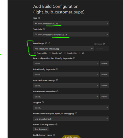

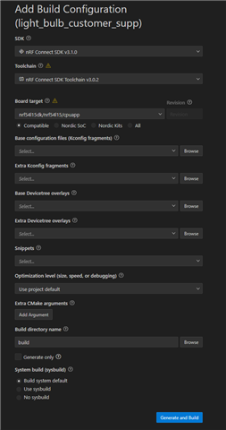

Could you please share the build configuration that leads to fail:
Worth to mention that if you are using SDK v3.1.0 then you need to update toolchain to v3.1.1 as well. Updating just SDK without toolchain will lead to error.
Ressa

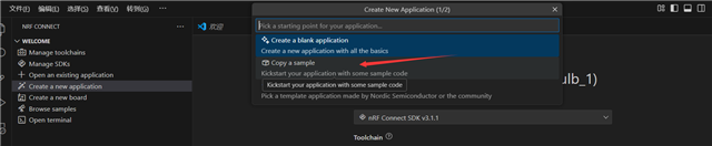

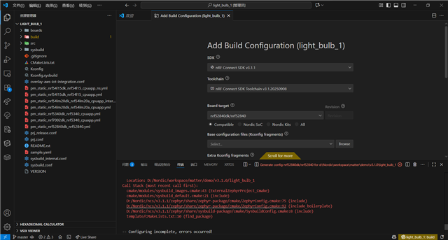

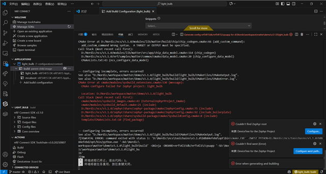

I have updated the SDK to the latest version 3.1.1 again, but the same issue still occurs during compilation. The toolchain is also up to date. Here is the details:

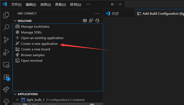

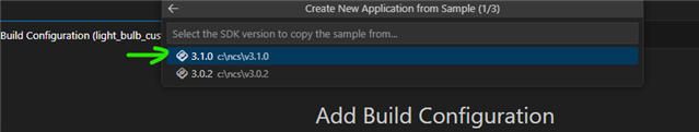

I generated the light_bulb using the following method. Could you please send me your corresponding version of the light_bulb code project for comparison? This way, we can identify the root cause of the issue.
I am able to build the sample for both nRF54L15 and nRF52840. Can you try to use exact same SDK and toolchain version mentioned in picture:

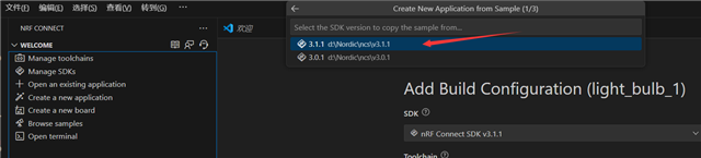

The sample itself also coming from v3.1.0 :
