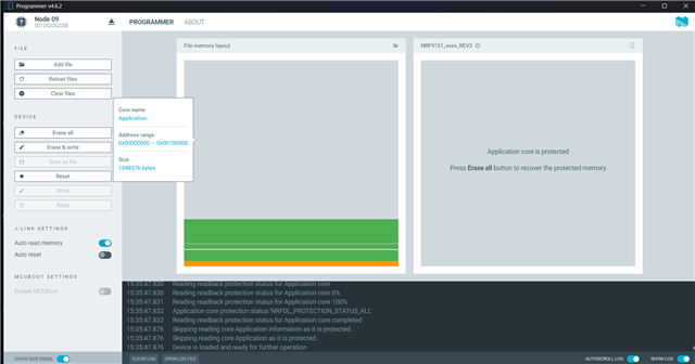

Hi!
I am using nRF9151-DK, enabling UART1 and using CONFIG_UART_ASYNC_API.
The build is successful, but the problem every time i connect a flashed kit with this binaries into nrf Programmer software.
I get notification of "Application core is protected".
I have isolated all the included configurations and found out that CONFIG_UART_ASYNC_API is causing this.
Am i missing some configuration? How to overcome this issue?
nRF Programmer
UART-related config:
# Enable UART1 Async
CONFIG_SERIAL=y
CONFIG_UART_ASYNC_API=y
CONFIG_UART_1_ASYNC=y
CONFIG_UART_1_INTERRUPT_DRIVEN=n
Devicetree:
&uart1 {
    status = "okay";
    current-speed = <115200>;
    pinctrl-0 = <&uart1_default>;
    pinctrl-1 = <&uart1_sleep>;
