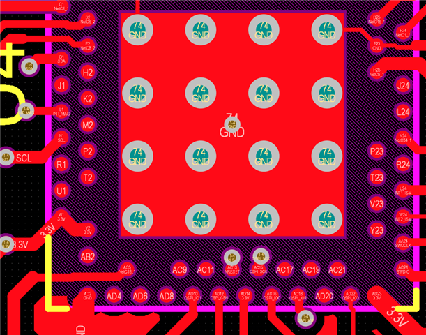

Hi, I am developing a PCB based on the NRF52840-QIAA-R package.
The pads are very tightly packed, and I had to shrink the size of the middle ground pad to accomodate vias for NRST and AC15.
Is this allowable in the design?

  • Hello Faheem,
    Your options could be
    • To look at a different manufacturer?
    • Could go ahead and accept the risk that you might have a non functioning board in a small prototype build?
      • If it works and performance is acceptable, then ok. If it doesn't, you can find alternative PCB manufacturers that support making the board dimensions needed.
    • You can use QFN version of the chip?
