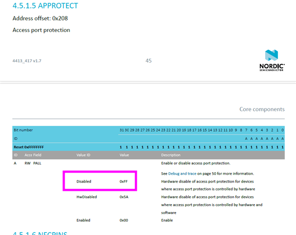

Our application implements authenticated access. Behind that, we allow an authenticated user to unlock the flash:
NRF_APPROTECT->DISABLE = APPROTECT_DISABLE_DISABLE_SwDisable; // enable debug
NRF_APPROTECT->DISABLE = ~APPROTECT_DISABLE_DISABLE_SwDisable; // disable debug
Testing has shown that this does enable/disable access, e.g. allowing nrfutil, nrfjprog, jlink, to connect after the NRF_APPROTECT->DISABLE is set to SwDisable.
In order to ensure that UICR is written correctly at the factory, the data is written to a hex that is merged with our factory hex, with the intention of setting UICR to prevent unauthorized debug access to the product.

Looking at this now, I am concerned that it's DISABLING the APPROTECT on startup rather than ENABLING it. I think this is important because it is what mitigates the vulnerability in previous revisions? Specifically, this value is fetched in hardware at startup, mitigating the vulnerability. If I am understanding correctly, then this should be "Disabled", not "Enabled" - or "HwDisabled"?
"Step 2: Setting UICR.APPROTECT" from  Working with the nRF52 Series' improved APPROTECT  suggests writing this in the app (and bootloader?) and I suppose we should do that to make sure UICR is always "correct" - though, the app does not touch UICR, presently.
    The debug interface will be locked by default after reset even if allowed in the UICR, and will not be open until NRF_APPROTECT->DISABLE. So until tha tis writte to, debug is not possible.
    UICR.APPROTECT need to be written to to open the debug interface. You can either do that in firmware, or via a debugger. For instance if you use "nrfutil device recover" that will among other things write to the UICR to open the debug interface (it will also write a small pice of firmware tha twrites to NRF_APPROTECT->DISABLE so that the device can subsequently be programmed via the debug interface without needing a new recover operation, but that is less relevant here).
    That is what we've been assuming, but it seems to contradict this article:  Working with the nRF52 Series' improved APPROTECT (emphasis mine)
    The new access port protection mechanism is configured in two steps: in the hardware and in the firmware. At reset, the UICR.APPROTECT value is fetched in hardware. Then a function in MDK version 8.45.0 (or newer) is executed during startup to complete the firmware step. If the firmware step is skipped then the device may appear locked but it will not be completely protected.
    If this quote is correct, then it indicates some problems for our approach, I think.
    • We have set UICR.APPROTECT to "Disabled" (0x5A), instead of "Enabled" (0x00) as suggested in the article. It says that UICR is fetched by the hardware at startup. Does this mean that there would be a brief window at reset where the DAP is unlocked, unless UICR.APPROTECT is set to "Enabled"?
    • It says "Then a function in MDK version 8.45.0 (or newer) is executed during startup to complete the firmware step." I think that we are OK as long as that firmware step is not the function that we have patched into a NOP. So we need to know exactly what firmware function this is referring to to avoid the "device may appear locked but it will not be completely protected" state that the article warns of.

    J.P. Hutchins said:
    Our present approach of unconditionally writing "Disabled" to the UICR, via the factory HEX, is OK
    Yes, that is OK and a requierment for implementing authenticated debug. (If UICR.APPROTECT does nto have the magic word to unlock it, there is no way software can open the debug interface).
    J.P. Hutchins said:
    Which seems to write NRF_APPROTECT->DISABLE using the UICR. It's confusing, because if UICR is "doing something on its own", why is there this (disabled) runtime code to write the NRF_APPROTECT->DISABLE with it?
    This is mostly just a way of implementing it, the point is to write the magic word 0x5A. When doe like this, the correct magic word is only writen to NRF_APPROTECT->DISABLE if it is also in UICR.APPROTECT. I do not see a funcional difference if you had written a hard coded magic word not read from UICR (particularily as you know the magic word will always be present in UICR in your case as it is requiered when implementing authenticated debugging.

    PS: There is a twist here. You can write to the UICR and flip bits from 1 to 0 during the lifetime of the product (but not the other way around as that would requier a full chip erase). That should make it possible to leave UICR.APPROTECT 0xFF and then when you have doen your authentication procedure and want to open the debug interface first write the magic word 0x5A to UICR.APPROTECT and perform a reset (which is requiered for UICR changes to take effect). After that authenticate again and proceee with opening the debug interface via NRF_APPROTECT->DISABLE. This would then keep UICR.APPROTECT alo locked until the first authenticate debug session (at which poit tthe device is probably no longer out in the field).
  • Hi  ,   I'm working with  on this project.
    Firstly, thank you for the detailed responses and providing clarification!
    Regarding your comment about "PS: There's a twist here"  extra level of protection:  It seems like that may be incorrect.  The UICR.APPROTECT register is set to "disabled"  when 0xFF, meaning the device is unsecured.  So when left in this state, the firmware would only be able to set the device to "HwDisabled"  or "Enabled" (secured) by clearing bits.
    That applies to the old revision 1 and 2, with hardware only based protection. For revision 3 devices with AP protect controlled by hardware and software, the magic word 0x5A (named HwDisabled in the table) is the only value that disables AP protect.
