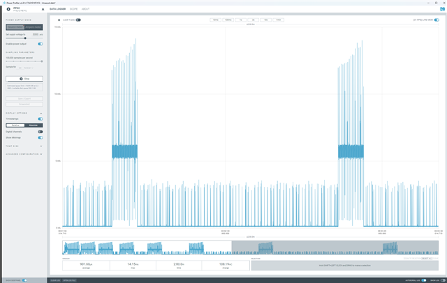

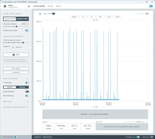

The current measurements below show the power consumption of the actual device
when start_network_rejoin() is not started at the time of ZB_BDB_SIGNAL_DEVICE_FIRST_START after boot.
The average current consumption is about 7 µA.
However, when the device is booted and start_network_rejoin() is initiated at ZB_BDB_SIGNAL_DEVICE_FIRST_START,
and there is no network available, stop_network_rejoin() is called after 200 seconds.
What I am wondering is whether the device does not enter sleep mode after this point, because the current consumption does not drop.

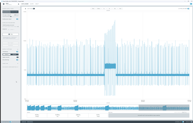

  • Hi Elfving
    As you suggested, I added the code, but the issue remains the same
    The image below shows the behavior for the R22 version, not the add-on.
    As you can see, when the channel is not found, the current drops close to sleep mode levels.
    This is the behavior I want.
    Currently, the R23 add-on does not operate this way.

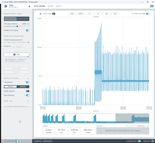

    Ultimately, if the connection fails, the current still does not drop.

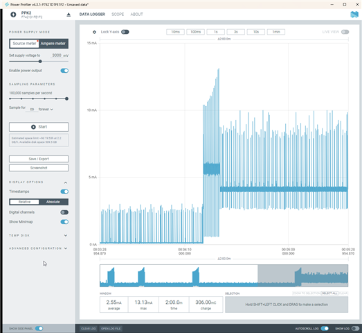

  • When system gets ZB_BDB_SIGNAL_TC_REJOIN_DONE then current still does not drop
    I: zboss_signal_handler sig : 58
    I: TC Rejoin was not successful (status: -1)
    I: start_network_rejoin ZB_JOINED 0 wait_for_user_input 1 is_rejoin_procedure_started 1
    I: rejoin_the_network Network rejoin procedure stopped as scheduled.
    ZB_BDB_SIGNAL_STEERING
    ZB_BDB_SIGNAL_DEVICE_REBOOT
    It works when I add it to those three signals.
    Please check with the R&D team if there are any other signals I should add it to.
    Also, I think this shouldn’t be handled through the signal but rather at the driver level.
    Is there any way to handle it within the driver or SDK itself, similar to how it was done in R22?
