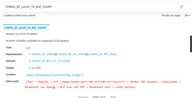

I have 5 devices connected to the board and I want to send a first notify command to all 5 devices and a second notify command to 1 of those devices. The problem is that if CONFIG_BT_L2CAP_TX_BUF_COUNT <=6 then there may be an error. I understand that the total number of L2cap Tx I'm using is 5(notify 1)+1(notify 2). And I know the way to prevent this error is to increase CONFIG_BT_L2CAP_TX_BUF_COUNT but I don't understand why notify 1 ends without returning the slot for notify 2 to execute? And the second problem is why I increase CONFIG_BT_CONN_TX_MAX also has the same effect although as far as I know these 2 configurations have different effects. CONFIG_BT_L2CAP_TX_BUF_COUNT indicates the total TX buffer at the logical link layer and CONFIG_BT_CONN_TX_MAX indicates the maximum tx buffer on each connection to the board.

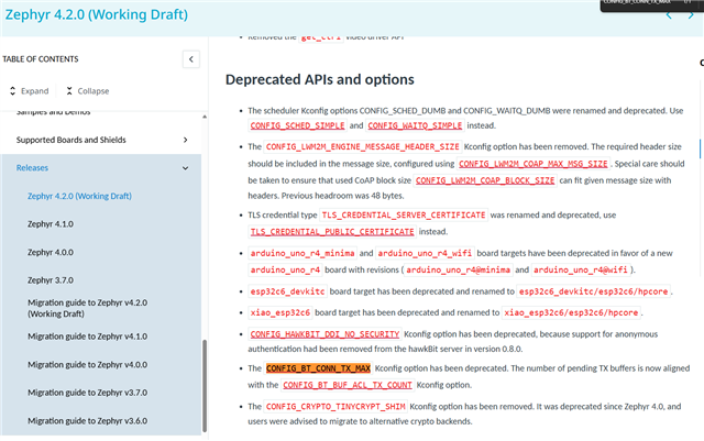

    CONFIG_BT_CONN_TX_MAX will likely be deprecated later Zephyr 4.2.0 (Working Draft)
    you can use the Kconfig search to see what the config does and it's default value if applicable
    Kconfig search
    Also look at your \build\zephyr\.config file to see what value the configs are set to

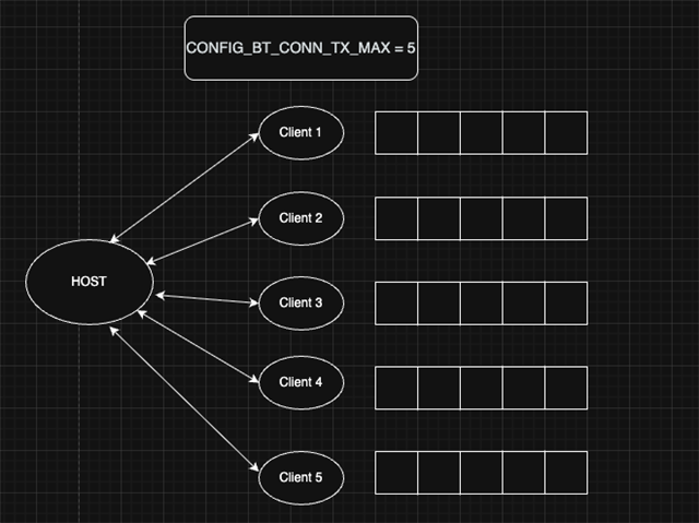

    Before I think it is a queue for each connection like about that:
    and some package such as notify, write response, read response of each connection will be arrange in their queue and then the package be sent to L2cap TX buffer to delivery to another layer. But after I read code in zephyr\subsys\bluetooth\host\att.c in ncs 2.5.0.

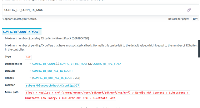

    static struct bt_att_tx_meta_data tx_meta_data[CONFIG_BT_CONN_TX_MAX];
    It seems this is a share queue for all connection before delivery to L2cap TX buffer.
    I didn't see more information about that in description of Kconfig.
    Thank you very much for your help.
  • Sorry for the late reply, there are not a lot of documentation on the config but yes, I can confirm that it's a global queue shared by all connections.
